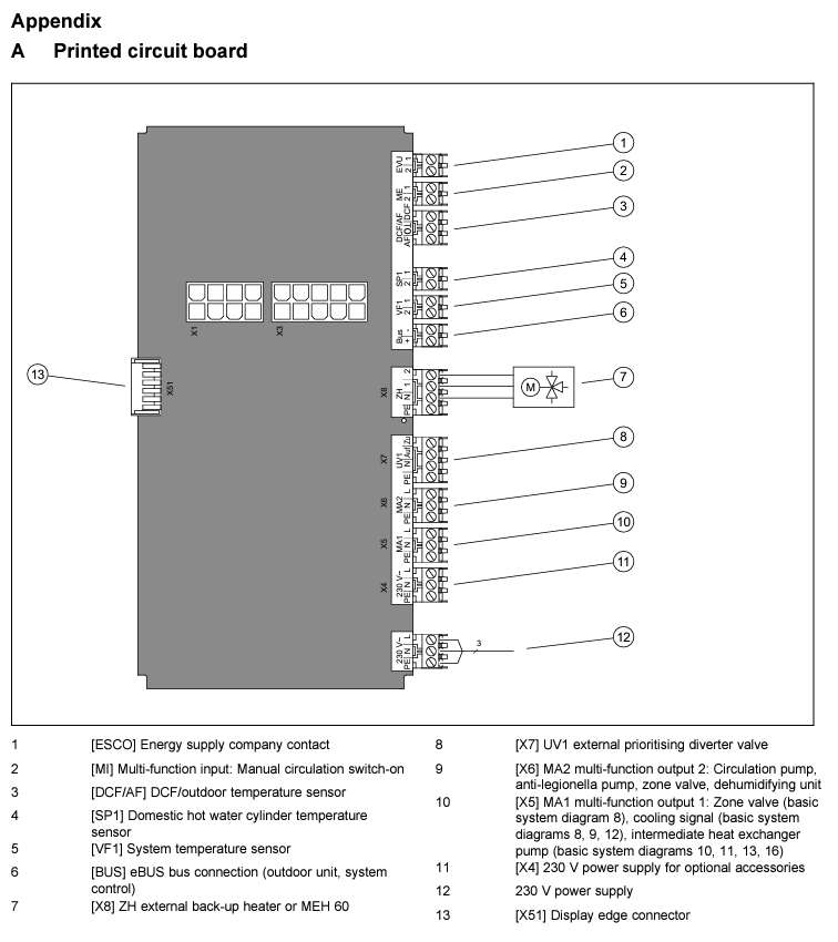

  11. Pictures as promised: On the wider picture, flow and return from / to the heat pump in the bottom right. The blue diverter valve is for the DHW priority - Down goes to the cylinder. (It goes to the built-in coil and then onwards to a separate DHW charging plate heat exchanger) Above that diverter is the heating/cooling mid-position valve - Right is the cooling pipe which goes upstairs, left is the heating and goes both up and down. The volumiser is on the heating return behind the wall, under the stairs. A lot to fit into a tiny cupboard! Hope that helps to explain the context.

  14. Just wondering if anyone can help with the configuration of the outputs for a Vaillant Arotherm Plus which we've just put in. We have it all piped up with a mid-position valve to switch between cooling and heating modes and have just received the fan coil units for cooling. (Yet to install these, there was a long lead time) The way we have it piped up we can choose to either use the fan coil units just for cooling, or for both heating and cooling. The fan coil units are Daikin FWS06ATV along with the FWS06ATV horizontal drain pan. We didn't get any controllers with them as I realised that the fans just need mains power and a 0-10V signal for the speed, so I'll use some 0-10V light controllers for those to pre-set the fan speeds. In order to get the diverter and fans running at the right times, we need two outputs from the heat pump. Once when there's a cooling demand and one when there's a heating demand. (The cooling demand one drives the valve and the heating demand one is used to drive the fan coil unit fans when they are used for heating) In the Vaillant heat pump interface, we have used MA1 for for the cooling output and MA2 for the heating output (As a zone). The manual suggests that this should be possible: In the controls however, we can't find where to tell it what MA1 or MA2 actually means as the diagram suggests that it could be triggered by multiple things. Sadly we cannot test the configuration as the outside temperature needs to be above 14C for it to go into cooling mode. Can anybody help with this aspect of it? We're happy to put it into manual cooling mode when required. It's also worth noting that we have hot-water priority setup. (The hot water valve is before the heating/cooling valve) As an aside, does anybody know if the Vaillant Arotherm Plus is "smart grid ready"? I believe that some heat pumps can be told to heat the cylinder to a higher temperature if there's excess solar, for example. Thank you!
