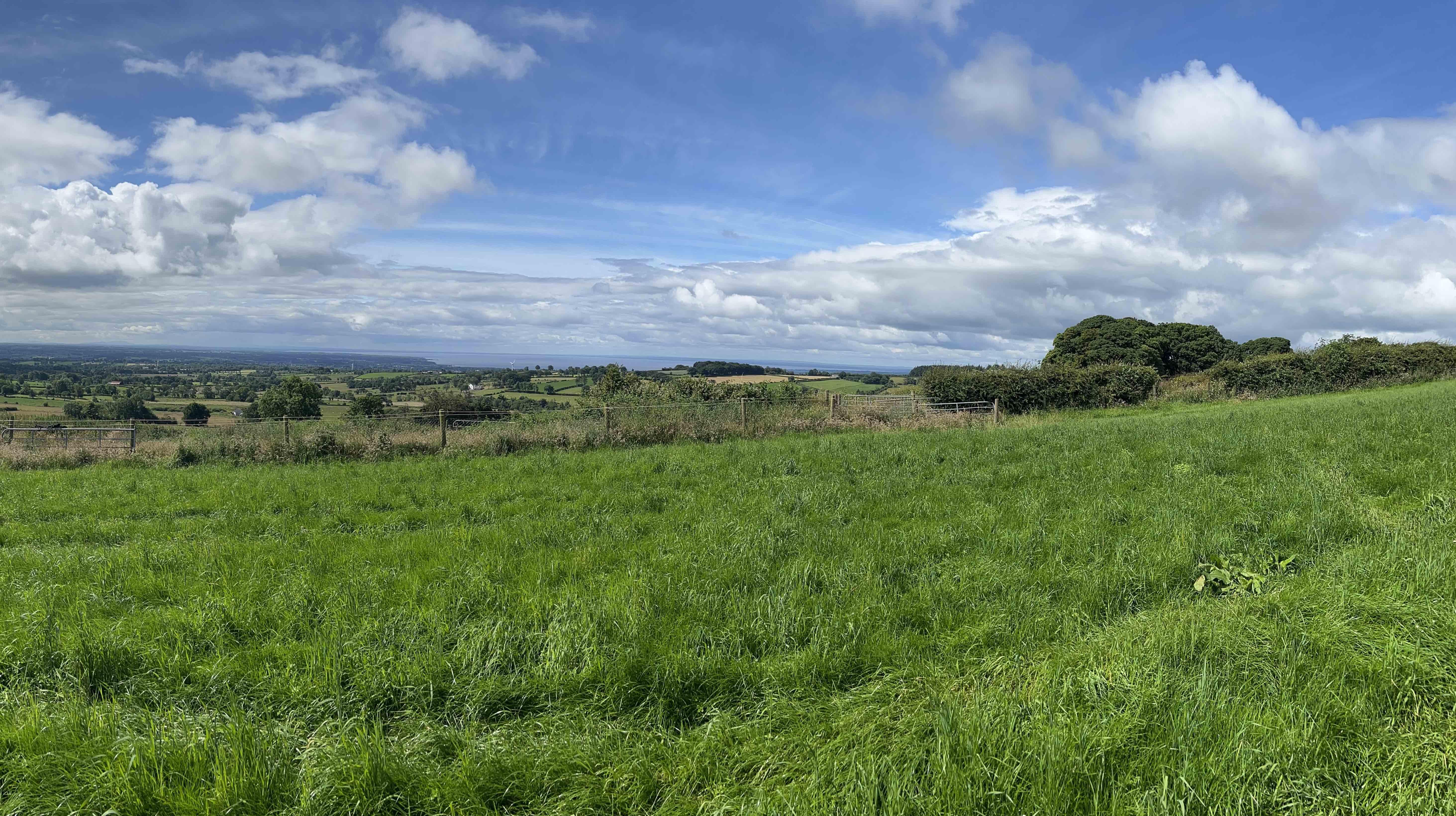

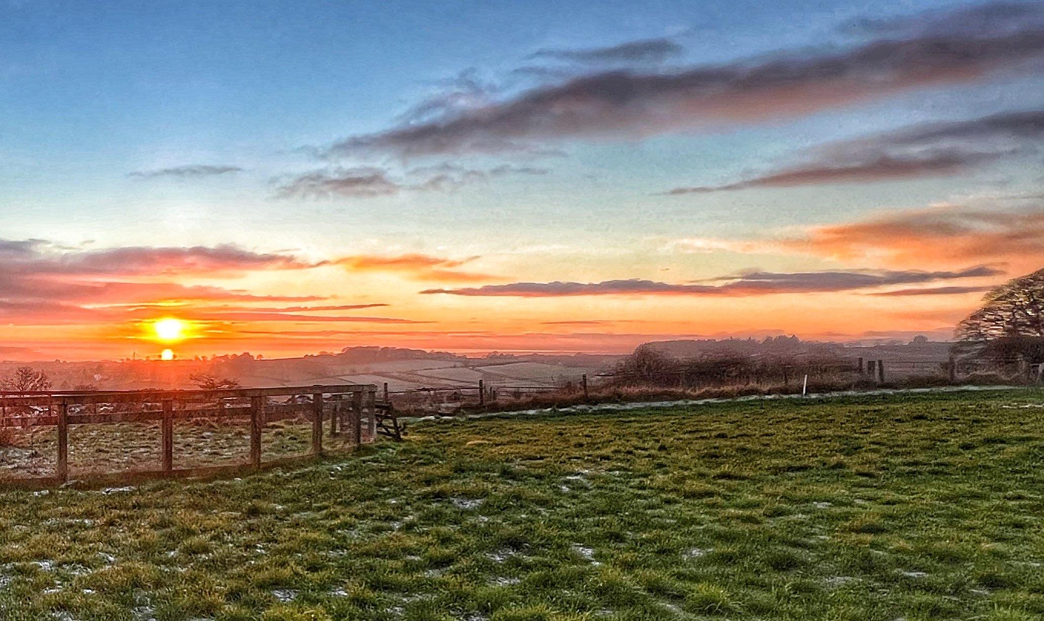

  10. @Alan Ambrose it certainly looks that way, there's also some healthy debate as well which I liked. I've uploaded a couple of images now I've found the 'quote' functionality.... cropped as there were people to the left but the view does go around. For context the water in the image is Lough Neagh and you can just about make out the hills in the distrance - can't decide if they are actually the Mournes or not but I'm told on a clear day you can make them out. I spent a lot of time in this part of the county and always dreamed of having a view like this so when the site became available I moved fast.
