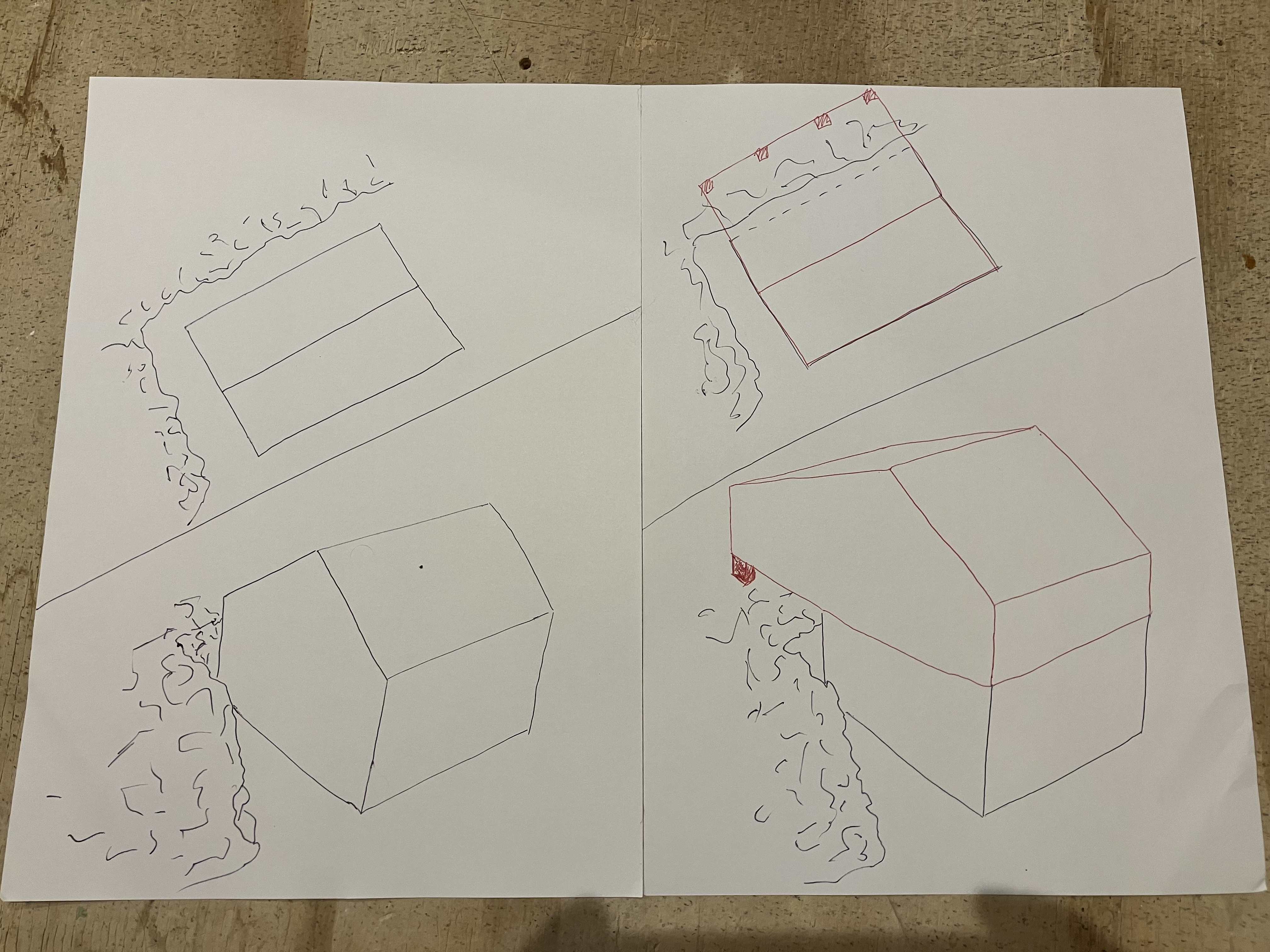

yes that's exactly what I thought assuming you mean 500mm not 500m it's a similar principle to the Japanese Hikari-tsuke where they profile the bottom of timber frame to match the contours of a rock which acts as a foundation pad for the house I've think I've seen similar commercial structures in Scottish trail centres / bird watching visitor centre type places, often out in the wild. Sometimes with eyelets which bolt onto structural members. Struggling to find contemporary domestic examples for reference -

It's an outcrop of what looks like tuff, about 1m high at rear of house and gently ascending. The house is sitting on rock that has been cut away to make the site more level, I'm assuming it was originally a mostly natural site within the outcrop with some under soil rock, vernacular build ~150years ago I guess so any work was done with pickaxes (or rudimentary blasting?) Sounds like boring holes and glueing steel bar / rebar deep into the rock is DIY'able with some expert direction (i.e not requiring a piling rig) pending geo survey / engineer assessment. If the rock fractures and doesn't bear load then this wouldn't work, but in that scenario at least I'd have the option of breaking it out Any rough ideas about the concrete base once the anchoring steel has been signed off? I can't see how a volumetric and pump lorry would get to site, a landrover and trailer is just about doable so I might be limited to mixing it on site, if I did small areas of form work on the rock tied to the steel anchors and across with mesh that is doable. I'm assuming compression strength (making crush cubes and getting the signed off) isn't the limiting factor here as the loading small. The principle concern is keying to the rock and bonding sufficiently as there is no soil compression around it to keep the base secure? -

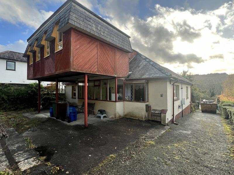

Found this mansard loft extension on stilts, similar principle but not exactly what I had in mind 🤣 -

Hello, I've got my eye on a very small scottish cottage which has been built on a plot cut into the rock (19th century). rear of the property is 3ft solid stone walls, rubble construction, ~3ft gap between rear of the property and rock terrace of ~3ft high. As expected the back of the property is perpetually damp and consequently so is the interior side of the wall. The property is sold as seen with no planning atm and I'd like to avoid going through the gamble of planning for a full demolition and the cost of excavating 100s of tons of rock which would ruin the charm of the site. Instead I'm thinking of extending upwards and to the rear so it is supported by the rock terrace (i.e avoid breaking it out as machinery is near impossible to access). I'm looking for inspiration from any projects with a similar constraints so I can see how it was overcome; pictures, videos, stories etc. Attached is a sketch of my current idea; concrete piers/plinths, supporting pillars (timber / steel / engineered wood), supporting a beam (RSJ / Timber / concrete) which would cantilever a first floor from the existing rear wall of the property. Failing that I would likely opt for the simpler option of a load bearing wall instead of a beam with pillars. In both instances I like the aesthetics of a house 'perched' over the rock. Obviously I'm not an engineer I'm just assuming this is doable in principle and it's just a question of sizing the components. Would appreciate any links or experience with this sort of constraint to build up my confidence that I have multiple workable options for making the property bigger before I buy and start work with engineer and architect and planning etc. Alternatively, any links to examples of foundations / builds on rock would be much appreciated so I can learn more about what other options there are (e.g steel frame)
