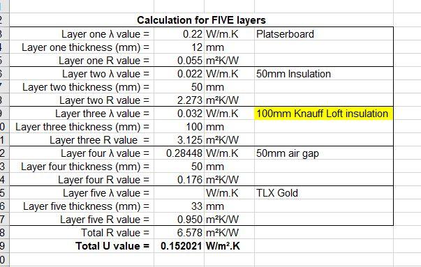

  18. Am I correct in saying Building regs state Roof = 0.20W/m². If so then when I input the values into the Simple U-Value Calculator I get a U-value of 0.15- have I done something wrong? You state 120mm PIR in two layers is this in between the rafters? Seems like a really horrible job
