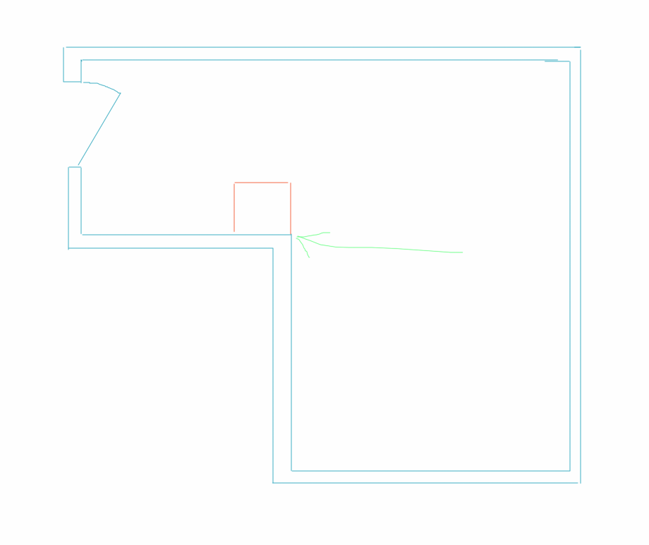

Are there any requirements ~ regulatory or otherwise ~ around central heating drain points? We have to replace a leaking section of heating system pipe. It is the lowest point under the floor causing issue so complete drain down coming, but no drain points at all currently so going to be fun. Part of what has to be taken up to repair is an area with a raised floor that could be lifted easily at any time. I was thinking I could put a valve under that section so I could reach down and open it from inside and the flow fun through an open ended pipe sticking out the wall. Or I could put a valve in both flow and return and T them both into the same pipe that goes outside if that would be an advantage. Any requirement for valve type? Was thinking a gate valve rather than a drain point so it can be attached permanently to the exit pipe but is there something better?
The extractor fan I have to fit has a 150mm spigot and advises that you must not reduce to 125mm, but you can adapt to 220 x 90mm flat. I don't quite have room to run 150 round ducting, but I could relatively easily run a 220 x 90 flat duct directly through the wall. Is there any issue doing so? The only obstacle I've found so far is that I cannot find any form of external wall vent termination with backdraft flaps for that size flat ducting. I have found a 220 x 90 joiner with damper fitted internally, that would have to be placed in the hole cut in the internal leaf of the wall, then a (very) short bit of duct to the back of a standard double vent airbrick. Any issues with doing that as well? Any other suggestions?!
