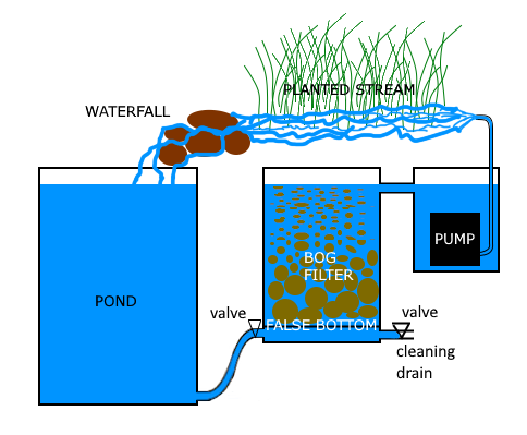

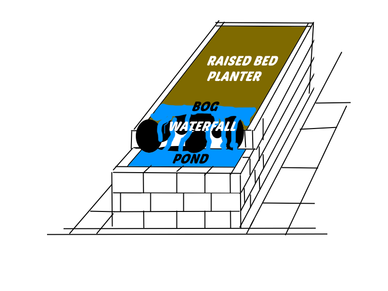

  2. thanks for taking time to respond. I thought so myself but not being a builder was looking for some reassurance. Take on board what you say about the pond but it's going to be really tiny (approx 1670 x 700 x 3 block courses deep) and should be very easy to maintain. There will be a bottom drain into an adjacent 210L water butt (buried in the raised bed part, to act as the bacterial filter and a further smaller chamber with the pump in to pull water through and feed back into the pond via a small stream and rocky water fall, all yet to be fashioned but have ideas.

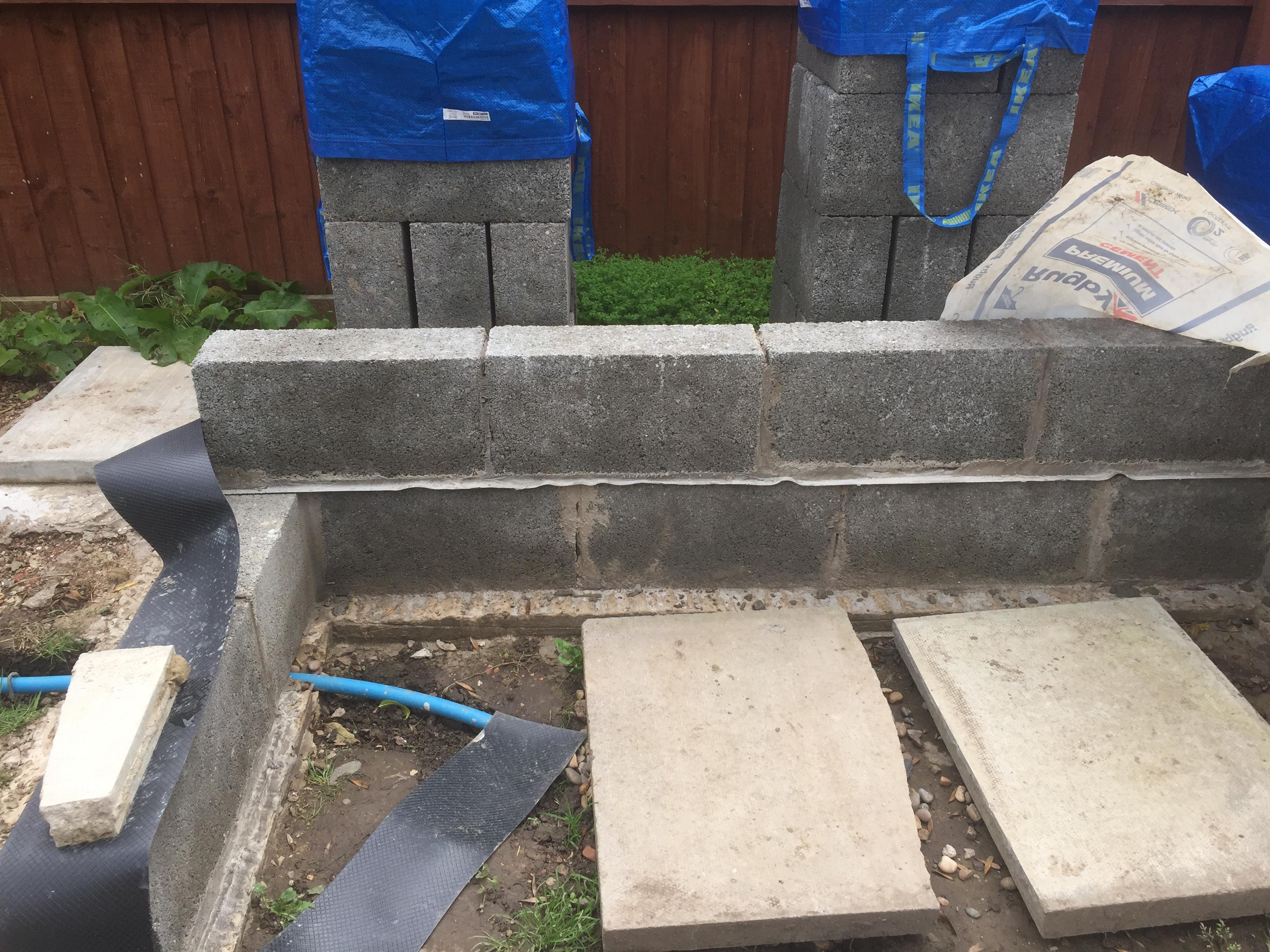

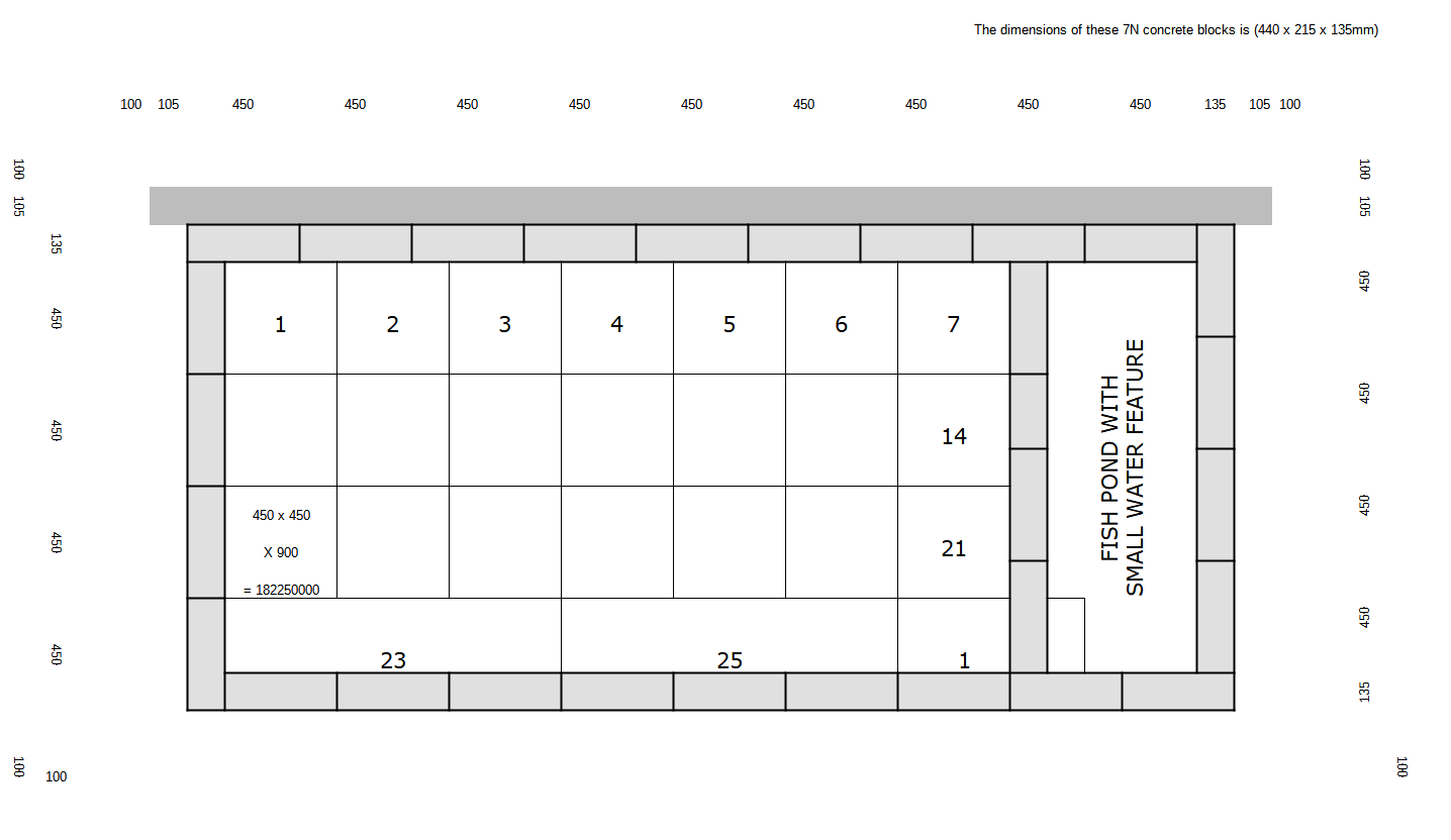

  3. Hello, just a quick intro, I'm in South Yourkshire. I'm not a builder by any stretch but have worked in civil engineering - currently building a raised bed with a yet to be fully designed pond/water feature at one end. I've most likely massively over engineered this thing but the ball is rolling now, I just have one quick question for now. I'm only building 4 block courses high and planning to double skin with a facing brick outer, using 3 lines of wall ties on the upper 2 block courses. My question for now - is it ok to have the block courses staggered like this on the longer sides or should I be cutting blocks to get a 50/50 overlap. blocks weigh 27kg 440x215x135 cheers
