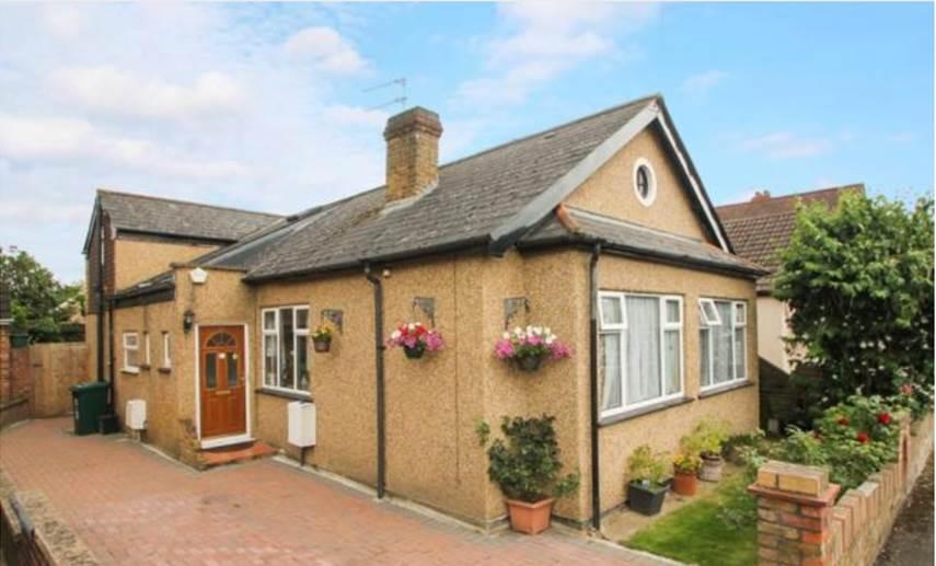

Thank you everyone for the warm welcome and the straight questions! Of course, we tried to sell. 18 months on, only a one offer (so low that we can't possibly consider it), and EVERYONE's feedback is that they love the location but hate the bungalow layout. No lick of paint can save this, and we don't think that investing 20k+ into a new kitchen and paint-licked 5 beds can work in this case - we'll have to hike the price up accordingly whilst we are pushed by everyone to keep reducing the price (already knocked off 50k :(). So - no buyers, and an offer which will leave us worse off (just the cost of land which is expensive and very sparse in this area). So technically we do own the plot now. We need a "normal", regular two-storey house, compact but with two separate floors, nothing too fancy. Sound proofing is not a big issue since we are not exactly under fly paths and do not suffer from noise (unlike Hounslow / Richmond). The structure of the house itself is not great (blocks of poor quality), not much in terms of insulaton, etc etc. For the money it would cost to completely re-do it (and change layout, and convert the loft) we can just as well re-build it. So, I'm off to enjoy hours of forum readings :) all opinions welcome :)
Hi there, We are a professional couple, based in Greater London. Currently reside in a very dated bungalow which we strongly dislike (was not a dream buy in a first place!). Now we are exploring the idea of knocking it down and rebuilding a proper two-storey house from scratch. Very new to all this, so mega-grateful to find this Forum with loads of advice and experience shared. Never done any self-build before, not great at DIY, so just orienteering at the moment trying to assess the scale of what we may be getting ourselves into (and looking for survival tips). Thank you in advance for bearing with us
