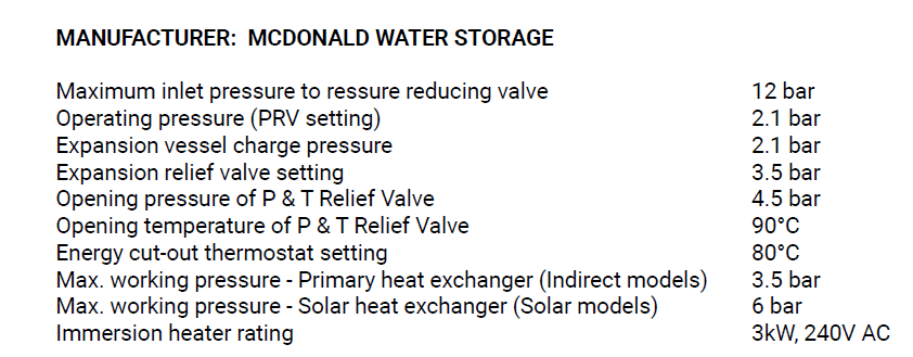

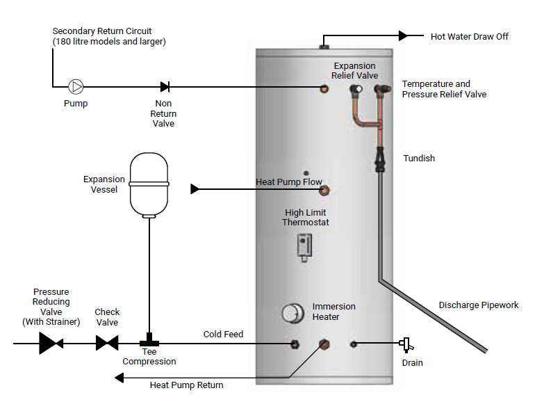

  1. The EV pre pressure should really be set up by measuring the dynamic pressure with a good flow through the cold taps, (to give say 15/20LPM) after the PRV valve or attached to a (cold) tap fed from the balanced cold on the valve set, which yours are, the prepressure should then be set to say 0.2bar below this, this keeps the diaphragm from bottoming out in any circumstances and also positions it better inside in the EV, IMO. This is probably what happened when the pressure was reduced. It can result in a slightly higher final pressure after a full reheat but this should not be a problem especially since you have a 22L EV on a 252L UVC, If the precharge pressure was 3bar then, after a full cylinder reheat to 60C, the final pressure will be 3.93bar, if the dynamic pressure is 2bar and the EV prepressure is set to 1.8bar then the final pressure will be 4.48bar, a little higher, but not a problem and just may cure noisy operation. I advice(d) the few people I know with UVCs to size the EV to 10% of the UVC capacity and set the prepressure to 2bar anyway even if the dynamic pressure is 3bar.
  2. Is this the first "creaking" problem? Did your plumber de pressurise the UVC before repressurising the EV? What make of UVC? What are the capacities of both the UVC and the EV?, should be labeled on both.

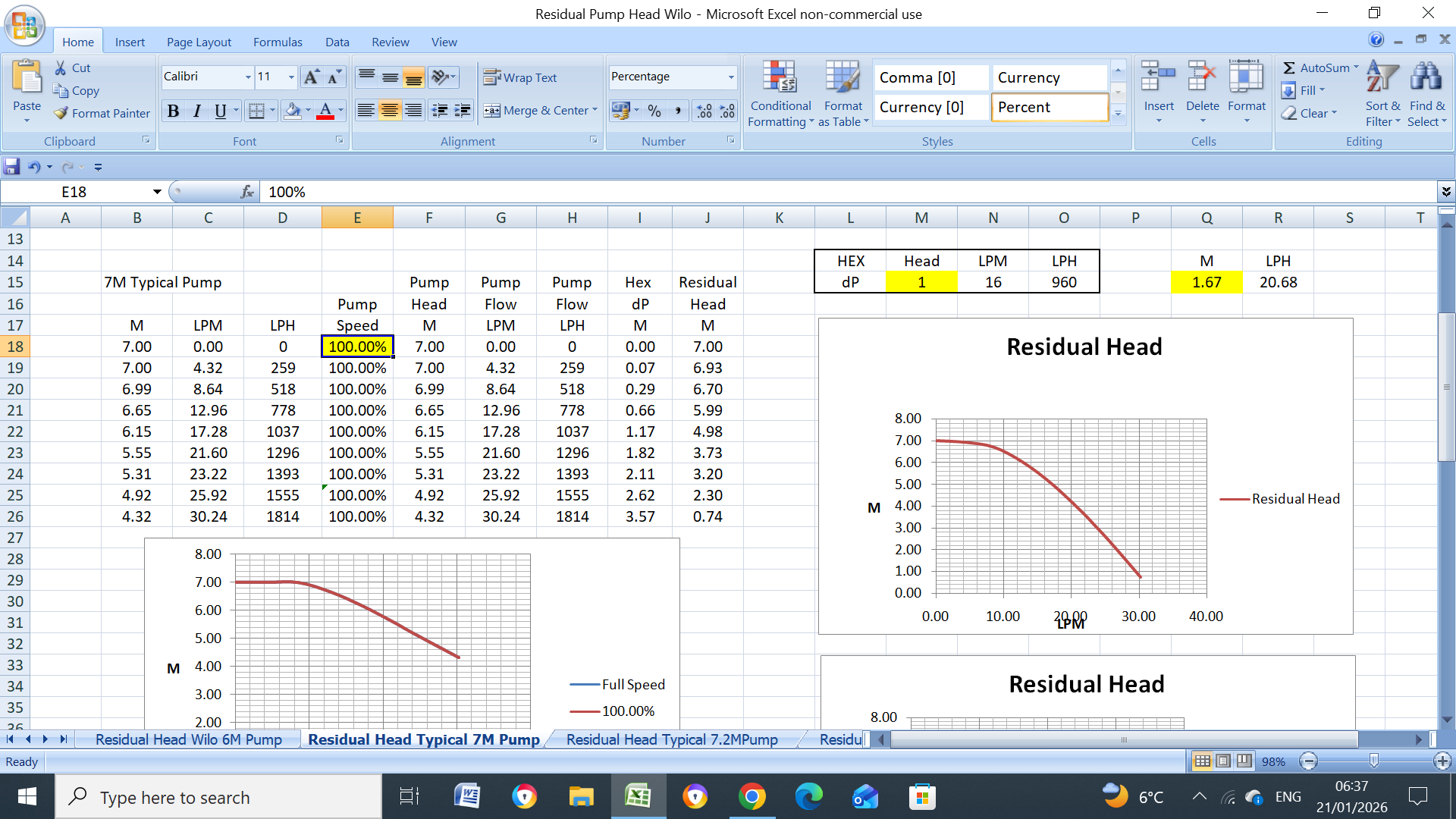

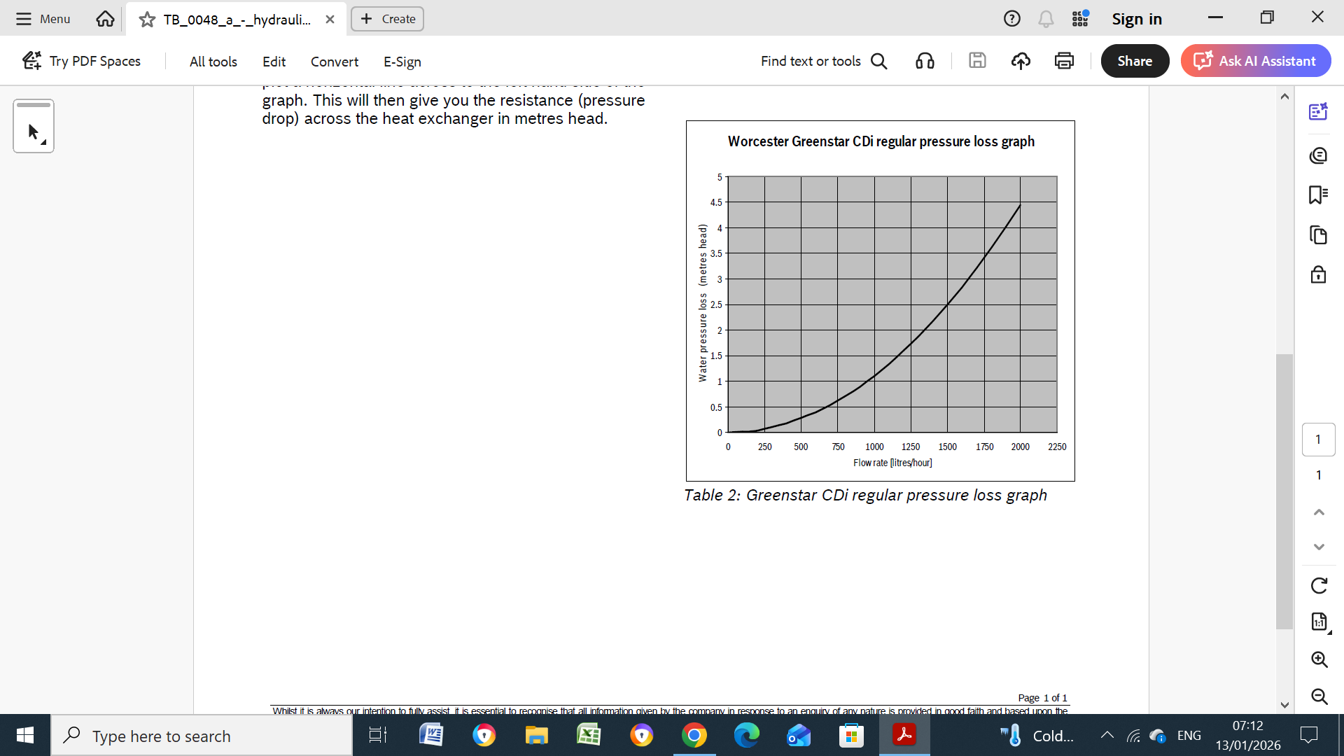

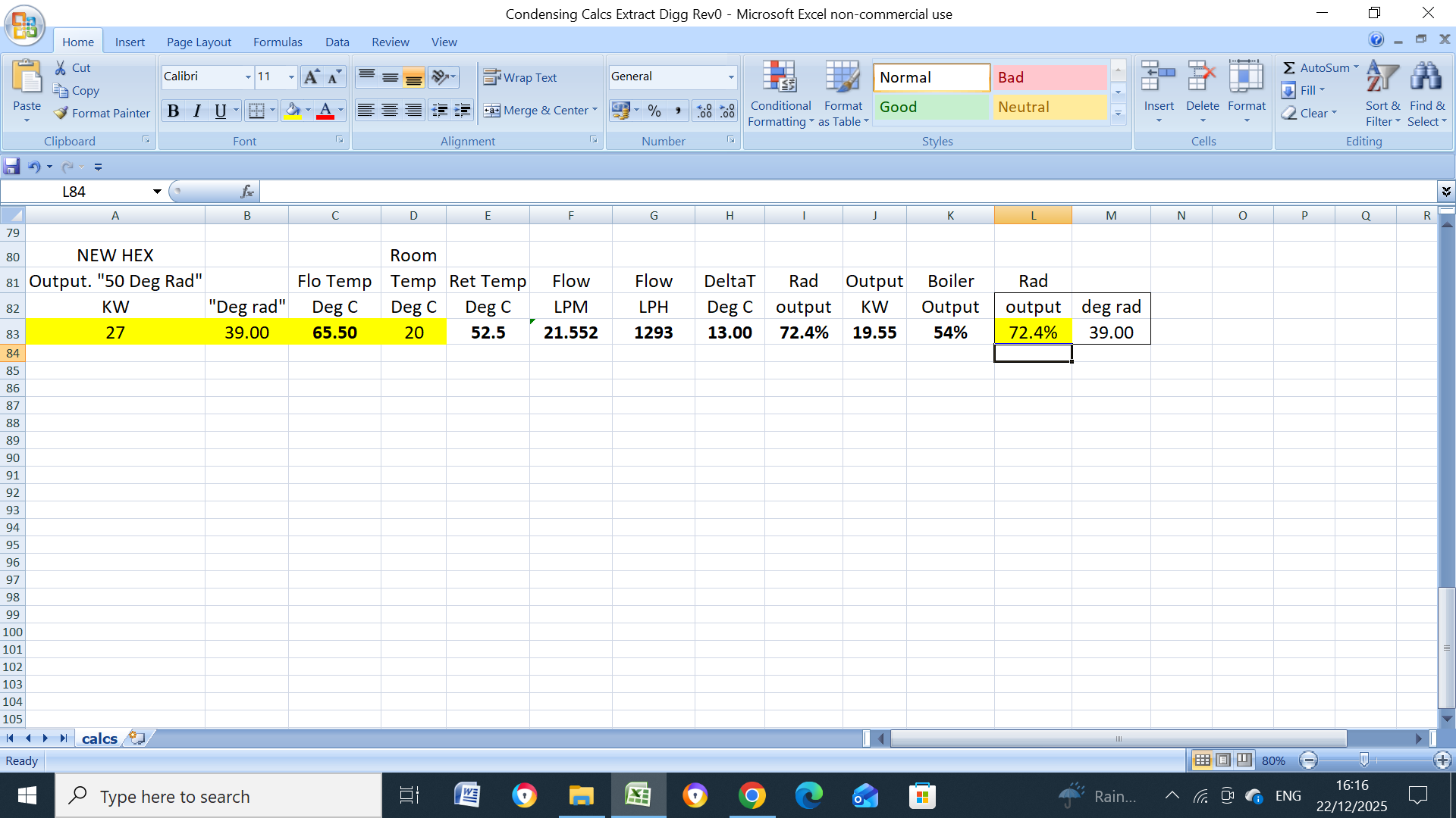

  10. Assuming a average 19.25C room(s) temp and 0.6m3/hr then 21.87kW ofT50s will result in 3.924kW of T13.337s, 17.944% output, but with flow/return/dT of 35.4C/29.77C/5.63C, sounds more reasonable? And for interest if the flowrate is slowed to 0.36m3/hr with 19.25C roomtemps and 35.4C flowtemp then, the output falls to 3.44kW with flow/return/dT of 35.4C/27.19C/8.21C, the difference between 3.924kw & 3.44kW might just be enough to tip the scales into boiler recycle??.
  11. You had a few readings there early in January of flow/return/dT, 35.4C/29.0C/6.4C, by calculation and assuming 20C room temps at I think you said a flowrate of 0.5m3/hr then the rads are 12.199 deg rads with a output of 15.98% and you require a unlikely 23.28kW of T50 rads which will result in a output of 3.72kW, something not right there. if calcs correct, maybe flowrate??

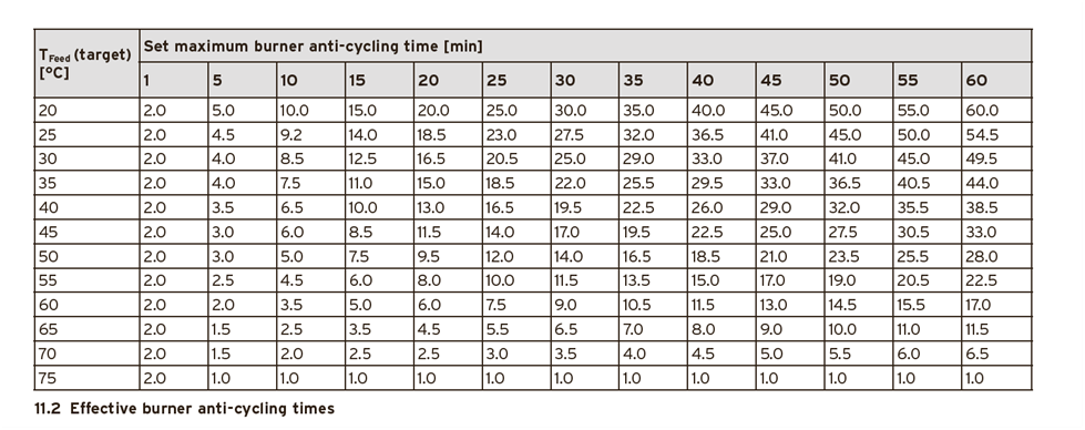

  13. My understanding of boiler controls then is fairly radically different to the above, my understanding is that the boiler looks at the difference between the target flow temp and the actual flow temp, if the flow temp is < the target temp then the boiler will eventually fire flat out until the flow temp is the same as the target temp or slightly exceeds it, the boiler will then modulate down until the target flow temp and the actual flow temp are almost exactly the same, if the heat demand is < the minimum boiler output then the boier return temp will start increasing which in turn means that the flow temperature will increase until eventually it may exceed the target flow temp by 5C, the burner will then trip, the circ ump will continue to run and the burner will then refire when tha anticycle time has elapsed. Boilers like the Valliant do have return temperature monitoring and if the DT between the flow and return temps exceeds something like 27C/30C will pause the increase in modulation or take some action like this until the dT decreases, their fairly recent system boilers have various pump settings, one of which allows you to set the flow/return dT between 10C and 20C, it achieves this by changing the pump speed which changes the circulation flwrate but does not interfere with the target flow templ/actual flow temp control.
  14. But if you have steady state running and the target/flow dT increases to 5C can only mean that the heat demand is lower than the boiler minimum output?
