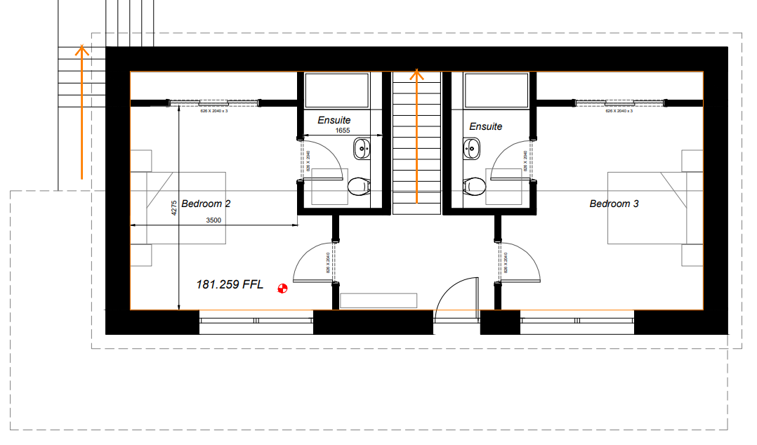

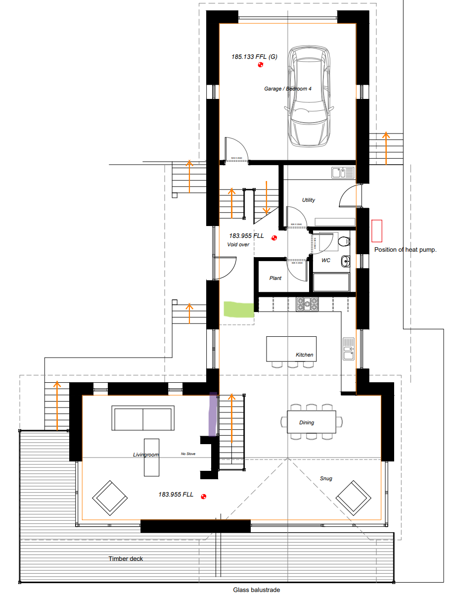

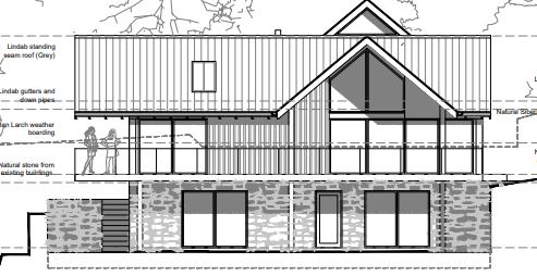

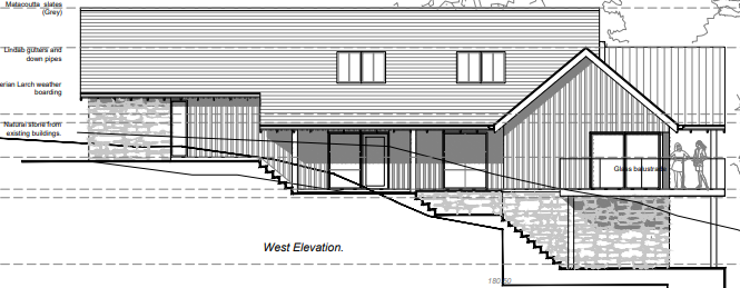

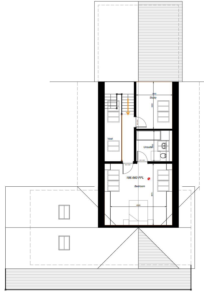

  3. Hello, We have plans to build a 3 bed split level house and would appreciate any feedback on the layout. The original house is a ruin and will be demolished with the stonework reused. Bedrooms 2/3 are positioned on the original footprint which is 60m2. The total size is 250m2 including the garage. Any thoughts would be helpful but in particular wondering about: (i) Kitchen/dining/snug layout - have we divided the space sensibly between the 3? (ii) Having a door between hall and kitchen (marked green) (iii) Current thinking is half height wall to separate living room and dining room (marked purple) (iv) We originally had a door from the kitchen but have replaced with a window/sink to provide more useable space
