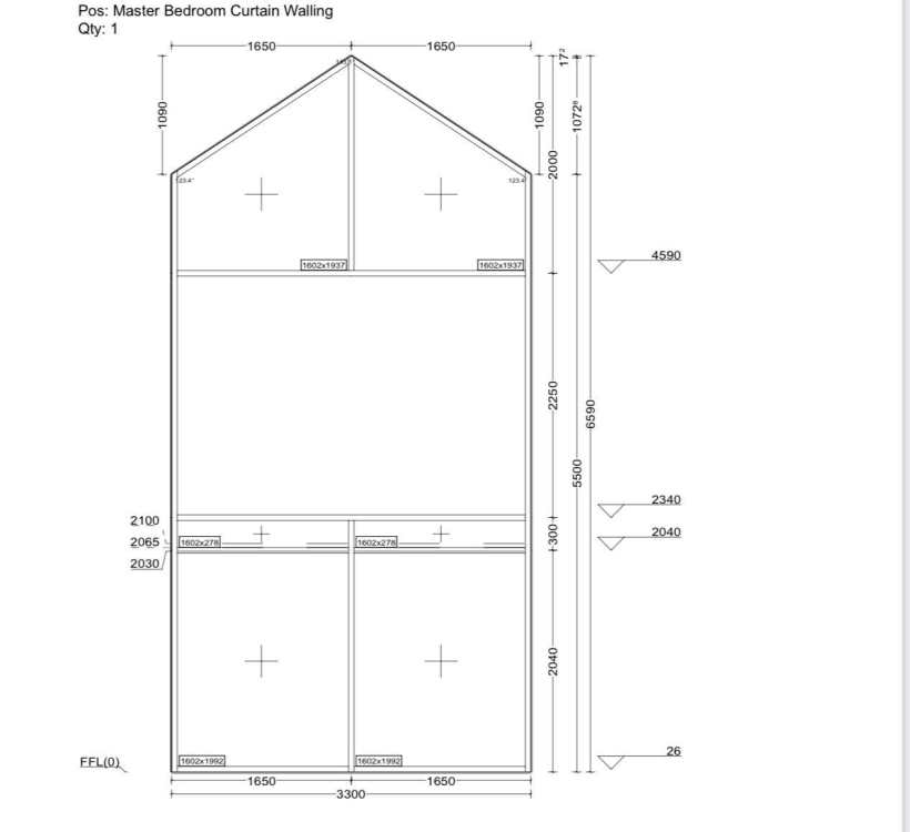

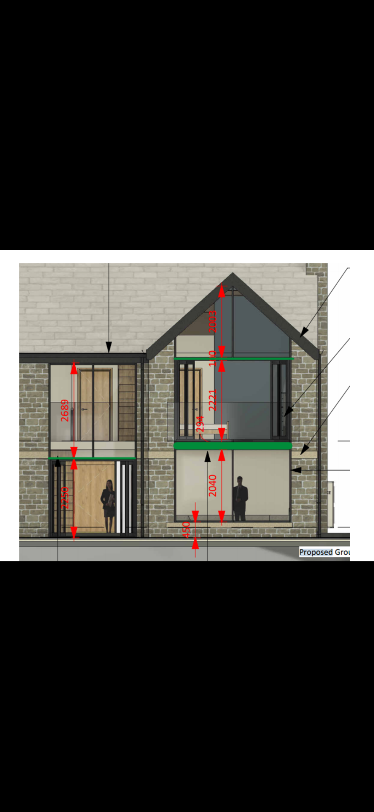

So would the timber frame SE review and advise this or would they pass the responsibility to the glazing providers who are responsible for their bit? My architectural technical feels it’s the latter. He feels more comfortable with the curtain wall due to glazing size @Russell griffiths I do like the look of glazed gable and the vaulted ceiling. I know In addition to this the specialist blinds will cost £££

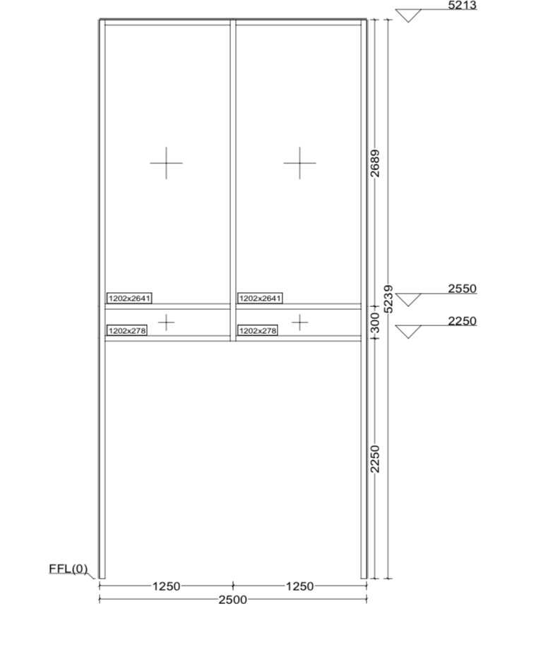

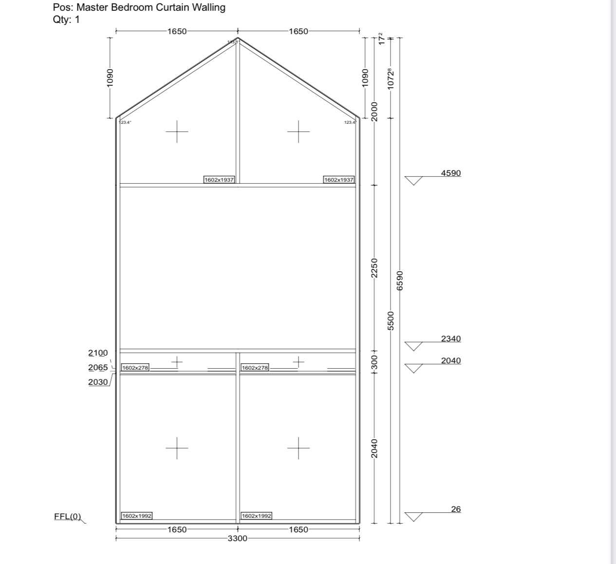

Hi everyone. Wanting some advice re curtain glazing vs conventional horizontal steel with windows fixed to this. I have had some quotes where they have specified curtail wall glazing by SAS (see picture) - plus sliding doors by either Schuco or Cortizo Other option which the majority have offered has been a horizontal beam with doors/ windows attached to this. One company we have looked at is Origin or express bifold See pictures for these. Those offering Curtain Wall have said it’s more secure/ solid. They say the other option there is movement in the window. Others says the horizontal steel option is fine and secure . Who to believe? The curtain wall option is about 15K more overall. The question is are the Curtain Wall people just chatting and over egging the issue or is there some truth in this?

We are going through the same. Trying to get the most cost effective blinds option, hoping we at an early stage where window design/ size can be amended. Been difficult to get quotes/ find people willing up have this discussion. Been told design with central mullion better to allow for light blocking Specialists blinds have been useful- looking at £5.5K-7.8K for a 3.3m wide gable. Trying to get other quotes as this seems expensive. Where have you been quoted?
