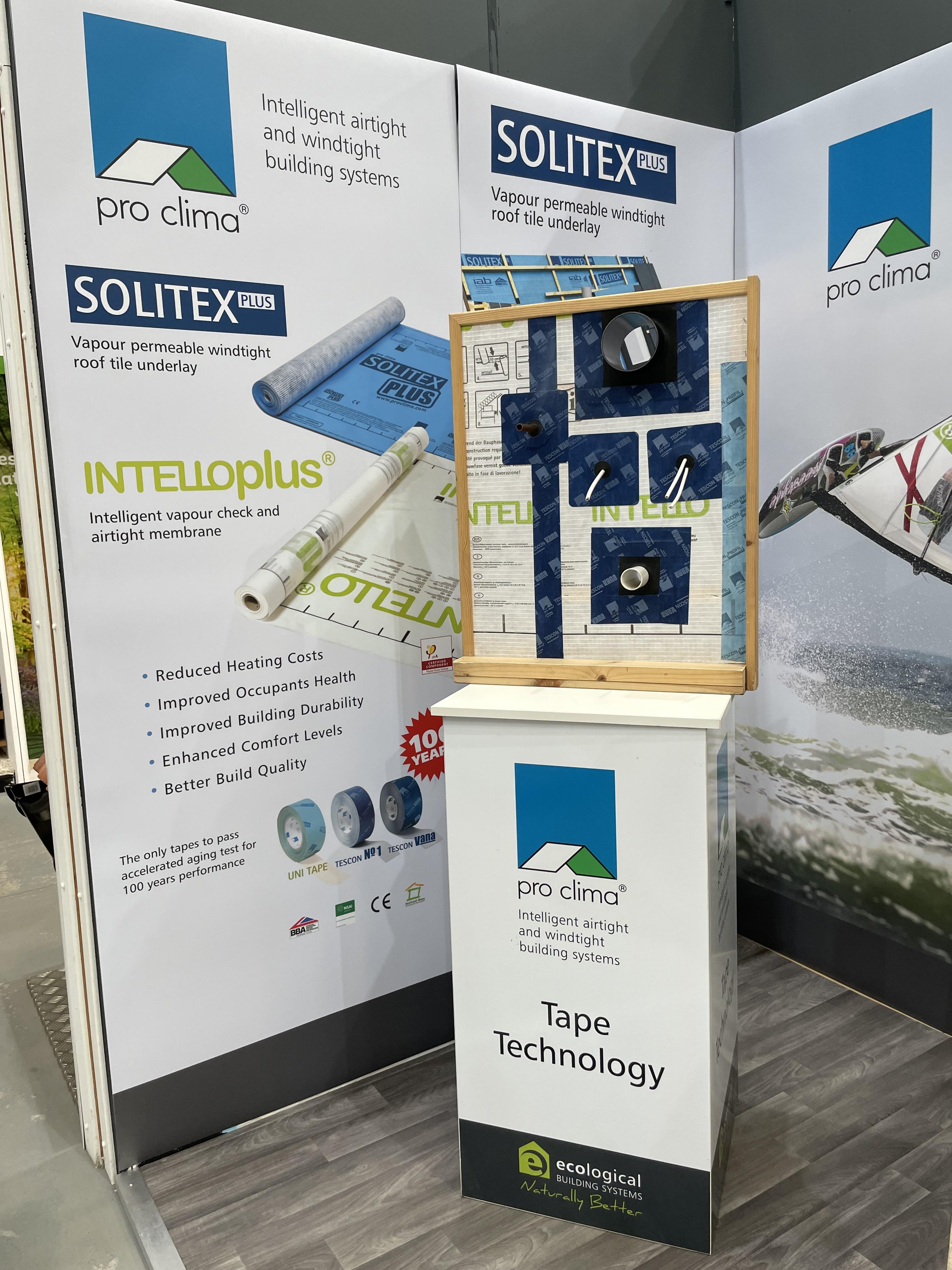

  8. Hi, @markharro When I was down visiting the NSBRC I came across Tescon Pro Clima Roflex products which have options form cables, pipes and ducts. You can see examples of their products on the stand in attached photo.
