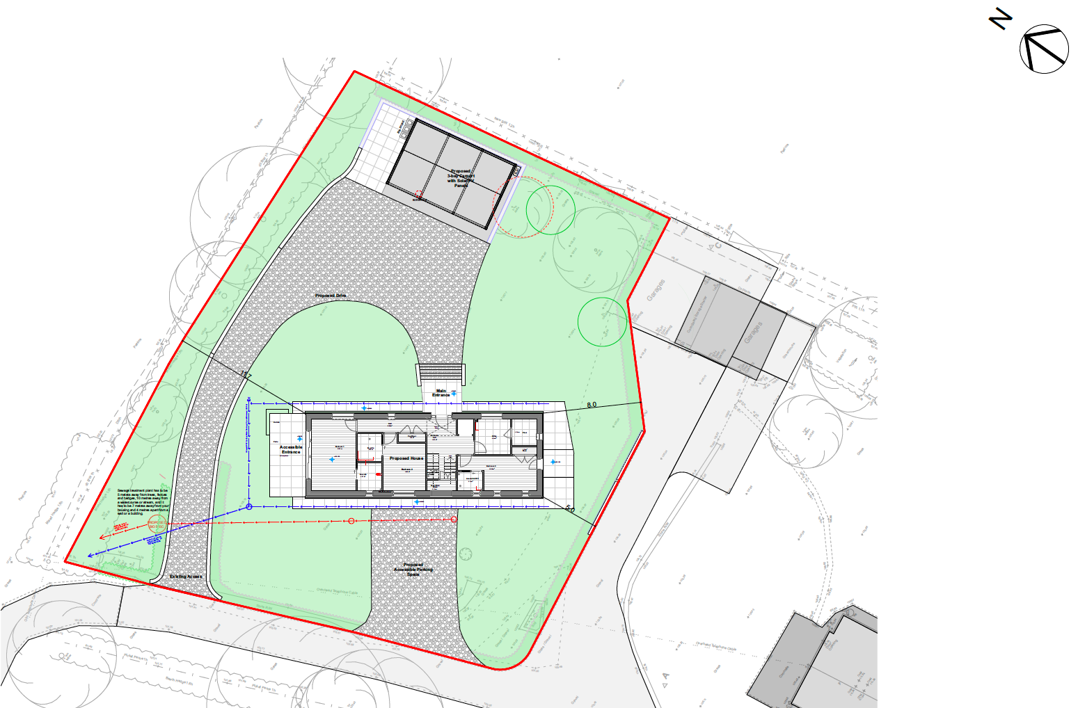

Good questions @IanR Windows are Rationel triple-glazed Auraplus (haven't considered coating options but will check). Brise soleil was added (to the mostly glazed face that is now mainly north facing after we rotated the house clockwise 25 degrees to improve the view and reduce the solar impact) but there is still a fair amount of glass on the "western" face (about 17m2 - about 20% of the wall area) and slightly less on the eastern face. To @garrymartin's points - good catch, yes 14W/m2, the house is upside down in as much as the living/dining/kitchen are all upstairs and open plan and yes that is a vaulted space to the ridge along with the stairwell. According to the architect the total GFA is 108m2 upstairs and 98 down. Site layout including the orientation attached for reference. Note also that the left hand end also has a 3m roof overhang covering an upstairs balcony and downstairs patio) which obviously shades that end and its two sets of 4m glazed doors. @Russdl the PHPP consultant is a certified PH designer within the architectural practice and there is an external/independant certifier reviewing the model for certification purposes so hoping that between them it should be reasonably representative.

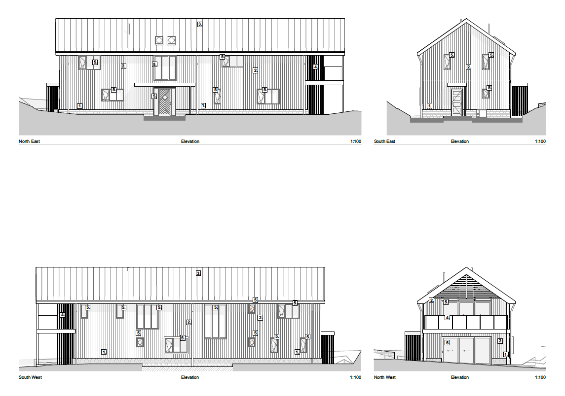

The floorplan is a simple 20m by 6m rectangular "barn" and whilst the final PHPP is still being worked on and reviewed by the certifier the initial modelling showed a significant likelihood of overheating so we reoriented the long axis more northwards and debated various shading options but the design issues were a projected heat demand of 24kWh/(m2a) versus a limit of 15 for Classic certification and a projected heat load of 14kW/m2 (versus a limit of 10). So it looks like it'll be certified PHI Low Energy rather than Classic.
