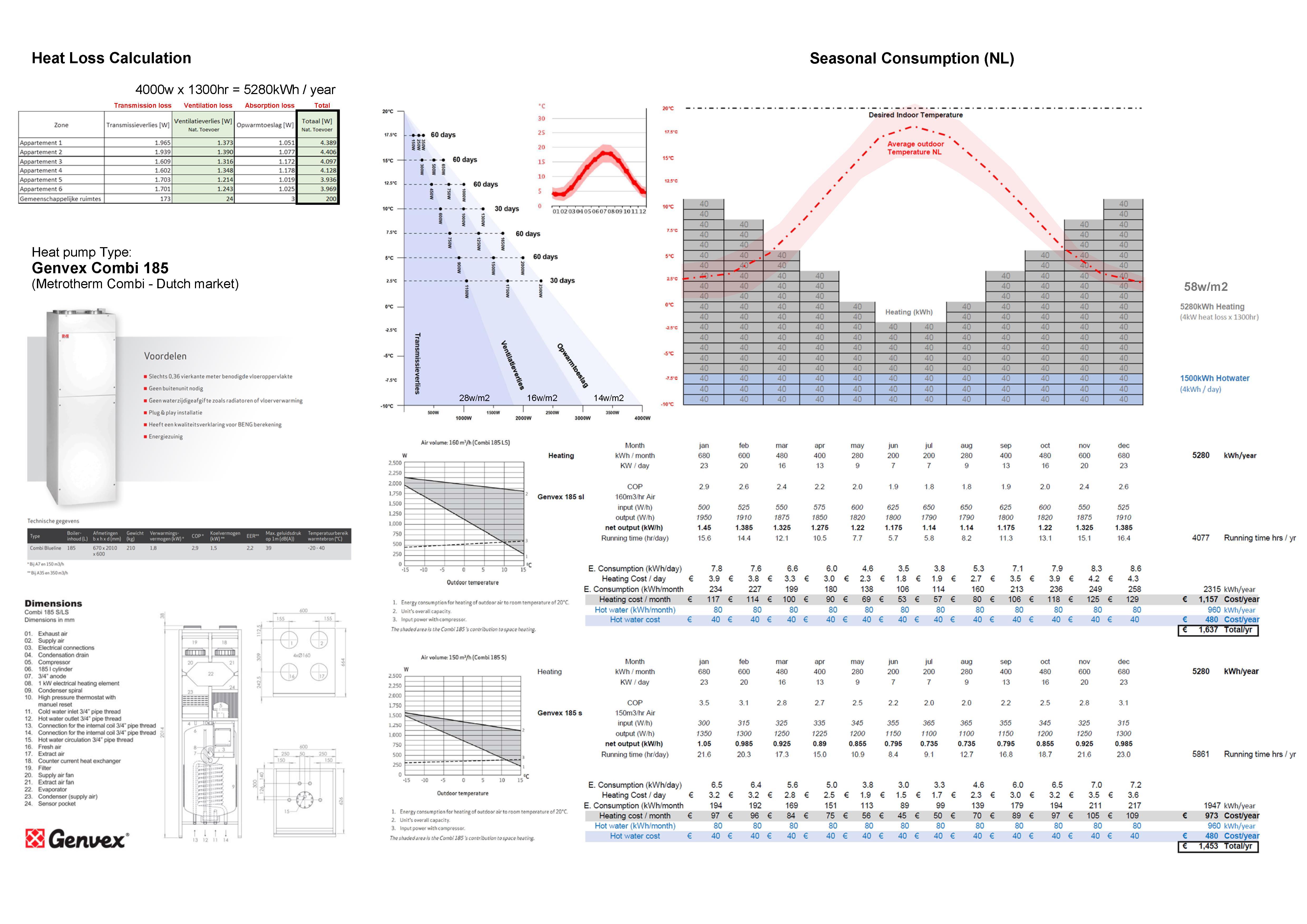

  8. Regarding the discusion around ventilation heat pumps specifically the Genvex Combi 185. I was initially quite enthousiastic about the compact simple solution of a ventilation heat pump. After modelling the energy consumption it seems to be less efficient than I originally hoped (see attached summary) The house I am building is an apartment for two people with a floor area of 70m2 in the Netherlands (similar climate to England) Insulation is relatively high: Floors: Rc 4,8 m2K/W Walls: Rc 6,1 m2K/W Roof: Rc 8,2 m2K/W Windows: U-value <1.0 [W/m2K] After a heat loss calculation was made by a professional it was determined the annual heat consumption would be approximately 5280kWh/year Heat transmission loss: 28W/m2 Ventilation loss: 16W/m2 Absorption loss: 14W/m2 Essentially the conclusion was the ventilation heat pump would rely on the back up immersion heater which has a COP of 1 far too much in the cold months to heat the air and hotwater cylinder. This basically translates into an operational cost of about 2-3 times higher than a split air to air or air to water heat pump. If your electricity cost is reletively low then this is less of an issue, if it is high such as where I live (around 50 cents/kWh) then the operational cost is an important factor to consider. Attached is the annalysis that I made of the Genvex Combi 185 that perhaps someone considering a ventialtion heat pump might find useful. Similar values would also apply to the Nibe F470 or Nilan Compact S as they all similar in performance and function. Installation conclusion based on total investment and operating cost (assuming you have space for a split outdoor unit) : Economical option: heating and cooling with a 5kWh mini split (Mitsubishi) and using a 120L electric water boiler for domestic hot water combined with a shower drain heat exchanger powered with 4 x 400wp solar panels. Comfortable option: (about twice the cost) was to use a Air to water split heat pump and integrated 190L water boiler (such as the Vaillant aroTHERM + unitower heat pump) combined with low temperature floor heating, shower drain heat exchanger and 4 x 400wp solar panels.
