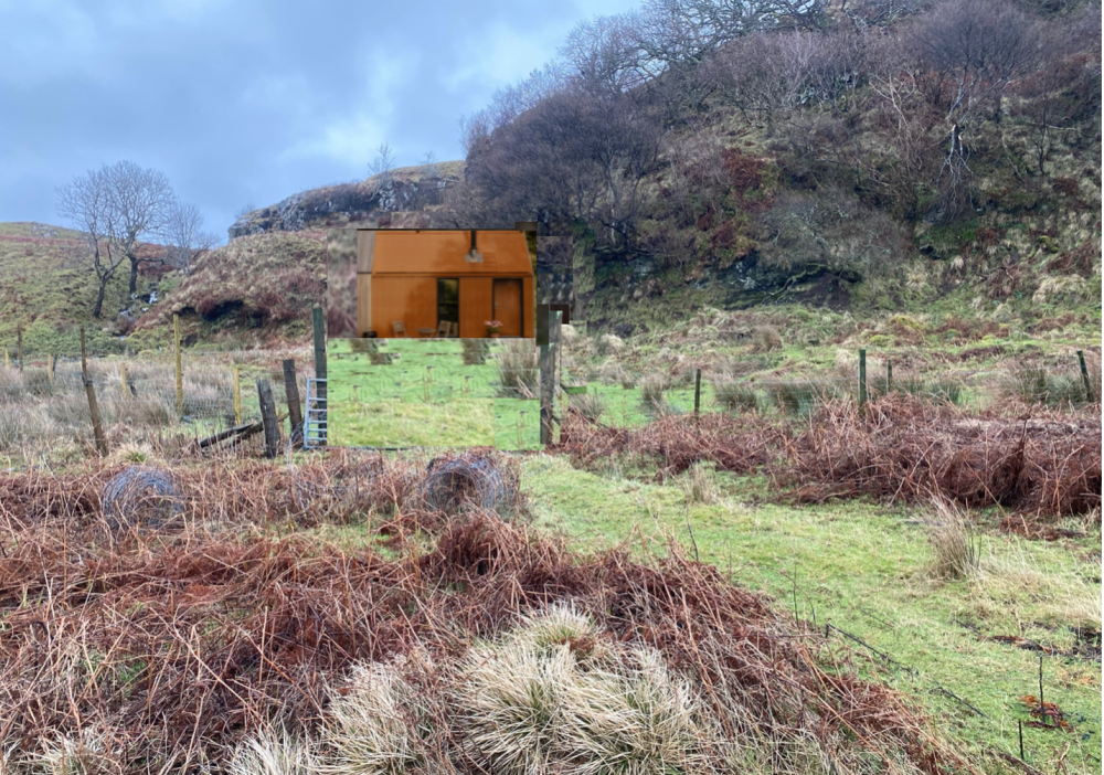

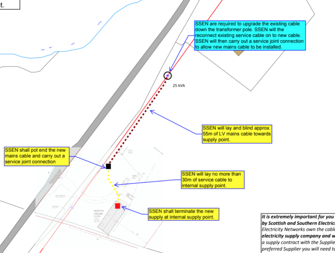

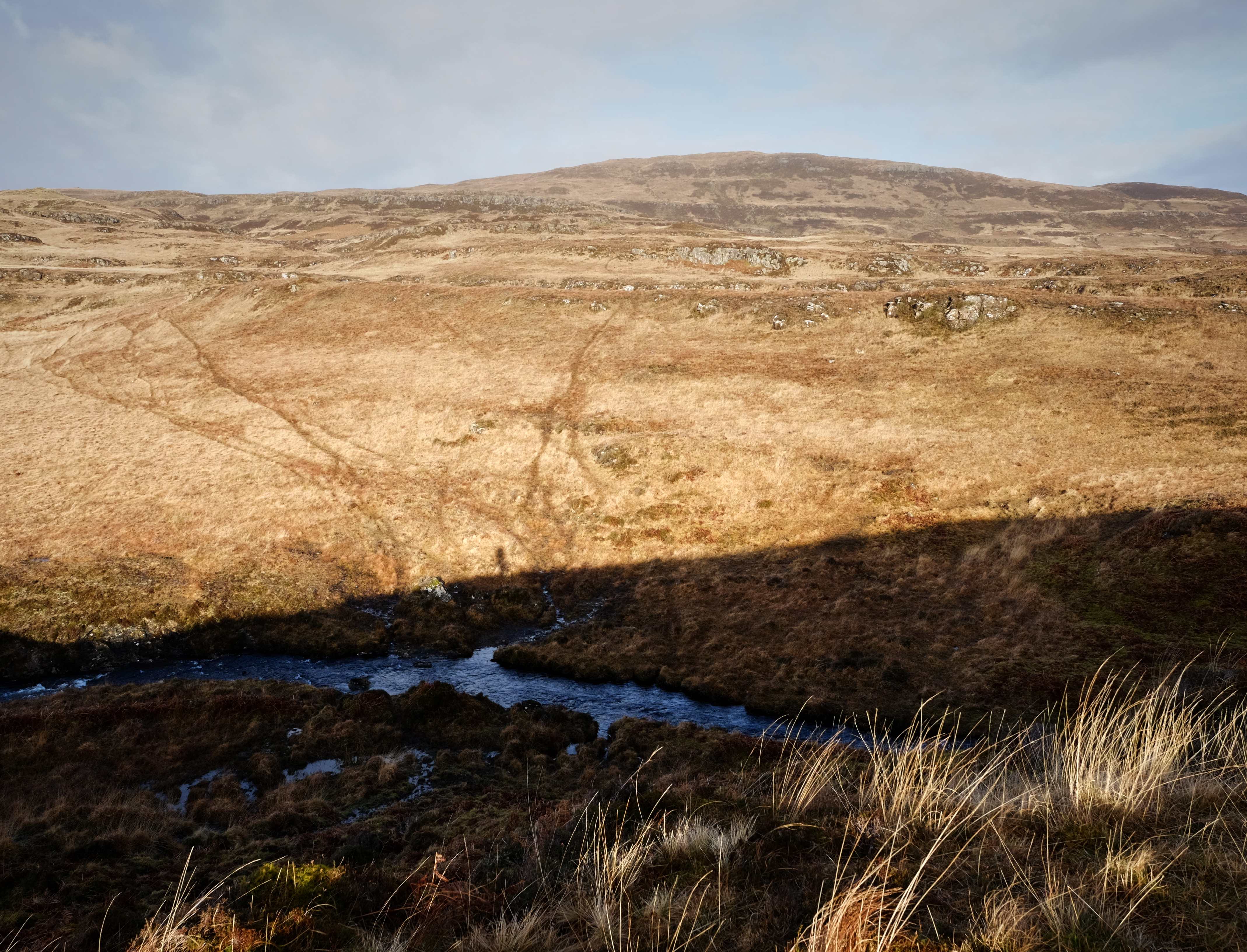

When my house was built I was connected to an existing transformer approximately 80m to my north. I feel they mentioned this was as far as they would lay cable before requiring a new transformer - I remember being hugely relieved they didn't! I always planned to have a holiday accommodation 'hut' in the garden and to this end the electrician connected about 40m of heavy duty cable to the house, ready for when it was built. I've found a much better spot for the hut, but it is another 80m beyond the house, and wonder if it is going to be possible to extend electricity that far? I think there is capacity in the transformer for this. This is the diagram from my connection quote showing what is in place. In case it is relevant, the hut is for 2 occupants, it would have a normal cooker (ceramic not induction), a shower, a panel heater... A new transformer would be prohibitive so the alternative would be to go off-grid, but it is in a sheltered spot shaded from the south so solar would be difficult - unless I could run a very long cable from the adjacent hillside. My poor effort at photoshopping the hut onto the site below. Thank you in advance and apologies if I have left out key info, I suspect if it isn't included then I don't know it.
