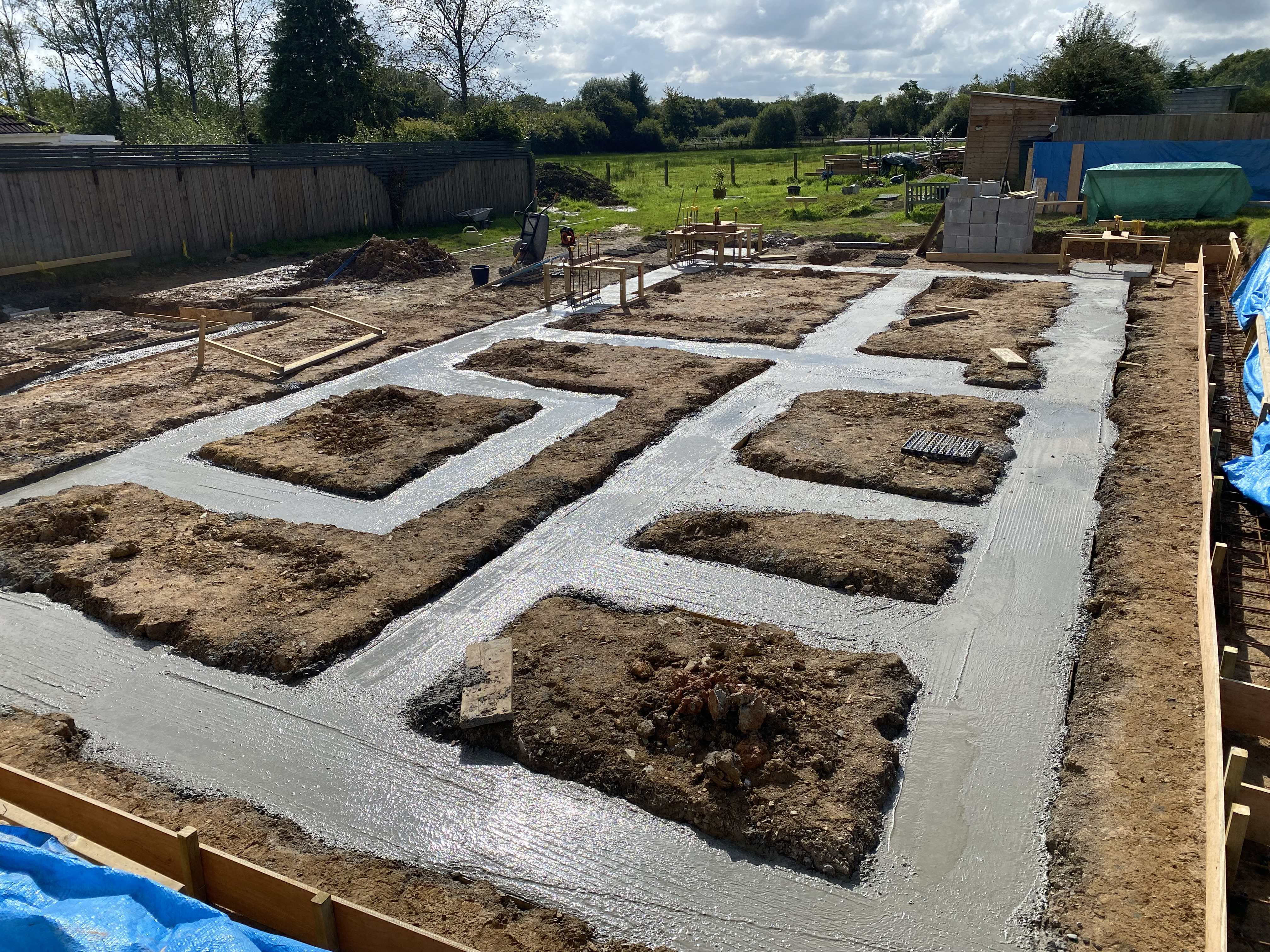

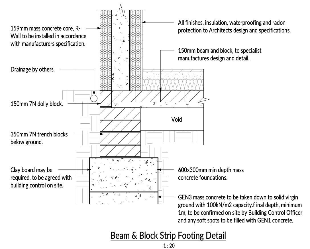

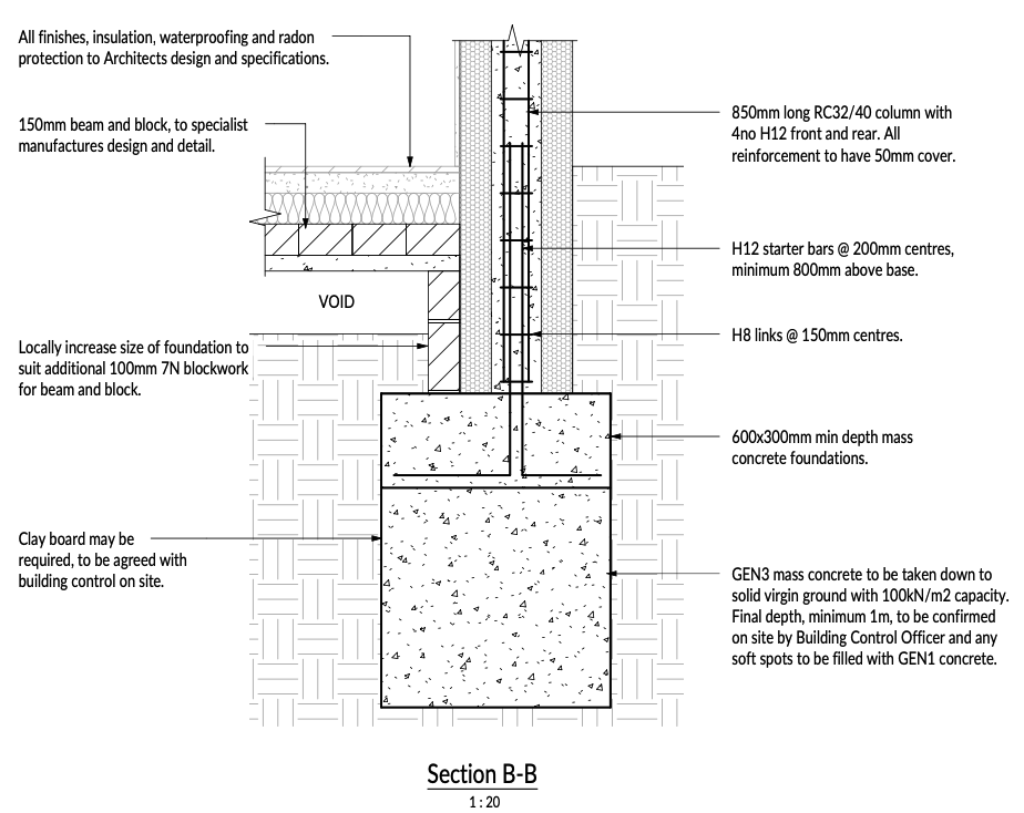

  6. Hi All, Having read plenty of interesting posts on here this is my first time posting. We're building an ICF house on strip foundations with block and beam floor. Our structural engineer has stated that where there are small pillars of ICF in between patio doors and window that we need to build the ICF straight off the strip footing with rebar up through the centre of the column. This is to create more strength in these narrow columns but I foresee damp problems as the DPC isn't continuous. Would a steel frame around the openings be a better solution and can this be anchor bolted direct onto the block and beam, therefore keeping the DPC intact? Before going back to chat with my SE just wondered if anyone can offer any advice. Many thanks.
