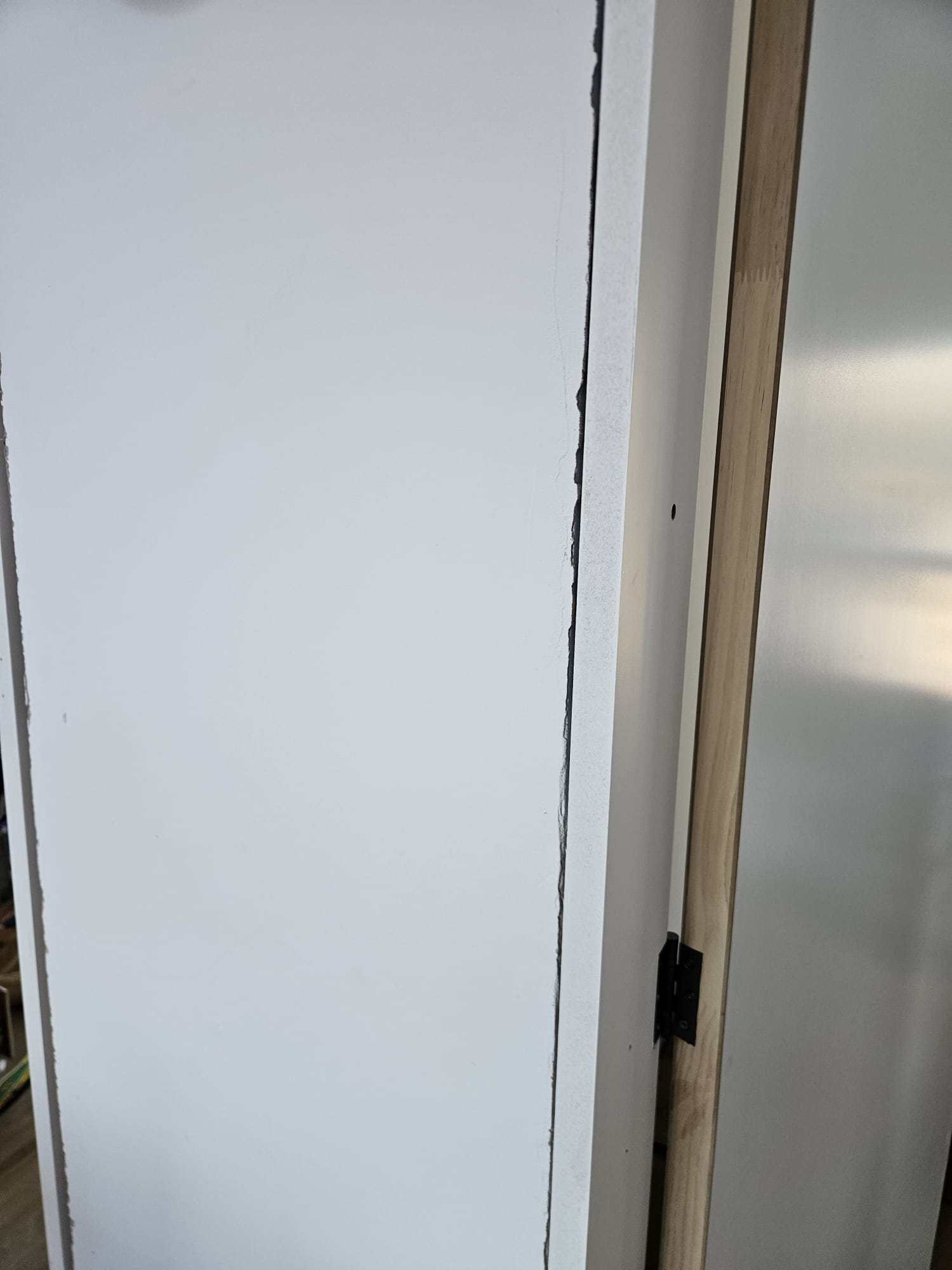

Sorry I just saw this and forgot I had posted it so long ago...it's been a journey. I posted again here (see below) and basically I royally messed it up so not doing it now. We are a bit gutted about it. If you need the trim, I have lots of it at a bargain price! 😂
Fitting shadow gap profile after plastering...
SB2023 replied to SB2023's topic in Plastering & Rendering
No bang strips yet, just a temp one at the top. They are going on next Lots of lessons learnt. -

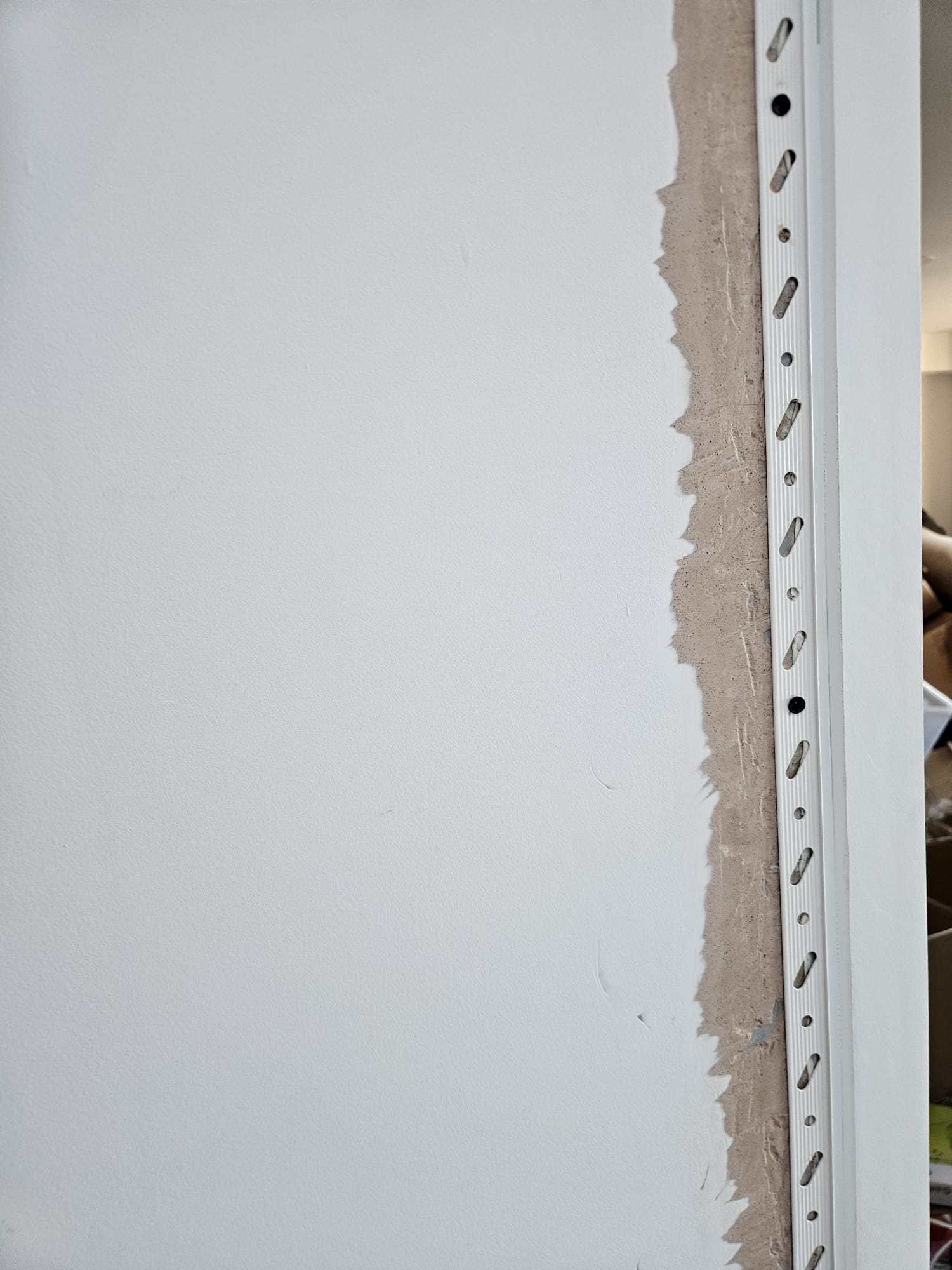

I ask this knowing that everyone will probably just shake their head in despair at me... I know I got things all out of order. I am fitting (I hope) a shadow gap profile around my internal doors like the first picture. However, in our rush to move in and get things sorted, the plaster-boarder and plasterer have plastered all the way up to the frame without the profile being fitted. As you can see in the first picture, I have chipped back the plaster so it will all blend ok. But this took me days! Has anyone got a better idea? I assume fitting the profile onto the plastered wall will give an awful bump in the plaster.... Could I cut out say 10cm of plasterboard all around the door and refit what is needed and plaster fresh? Or will this just cause loads of cracking in future? Any thoughts before I give up and just fit architrave!? Thanks!!

That could work too. I guess then the plaster can feather in to that from the bead to make the wall seamlessly plastered again.
I almost re-worded my note. Just to be clear - it will be a professional plasterer doing it. He is away for a few weeks but I want to get on with prep if its feasible... Sounds like it is which is good news! Just not sure then how best to chip some of the plaster away from the plasterboard then. Maybe sliding a small chisel around...
