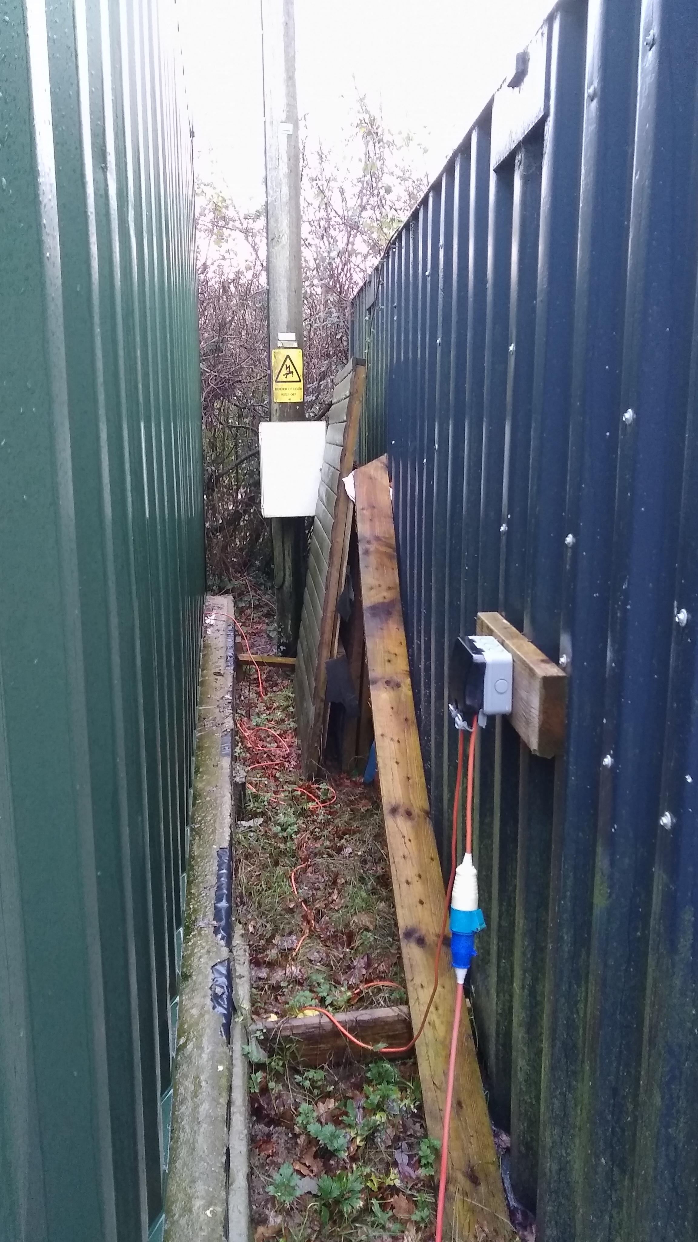

    berkshire

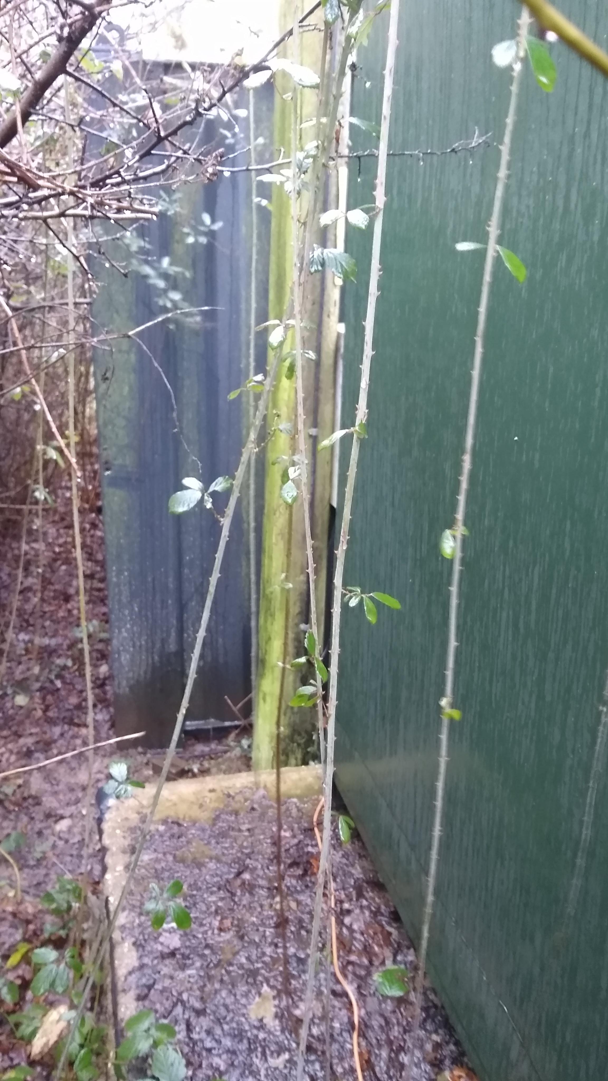

  1. They're bolted together so moving them would just mean undoing the bolts (main reason being so that they can't be prised apart for access). It would be a few hours of faffing, but they could be moved seperately. I did it this way with the thought in mind that if I can ever put them on my own land I could still move them.

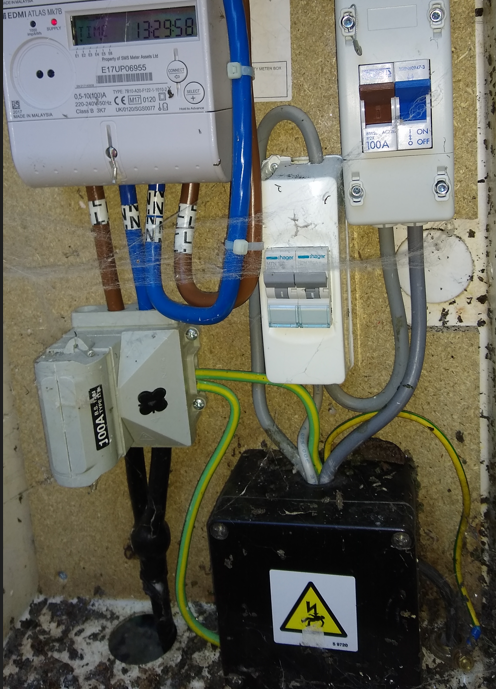

  2. Could I put a 'kiosk' next to the pole, on the concrete pad and have the connections run into that? This is what it looks like inside the existing box on the pole:
  3. I didn't know a landlord-meter was a thing! She would be quite happy with this, as would I - the point is I want a connection I can run a welder from that won't interfere with the existing connections. 16A would be enough, so 40A overall would be plenty. Can you suggest where I look into this further?
