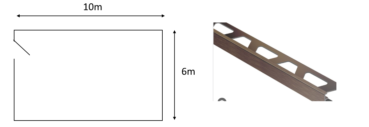

Hi, Could anyone please offer a thought on the following as I'm getting conflicting advice here. - Room is a reception room 10m x 6m with one door coming in (picture below) - Engineered wood herringbone layout flooring is going down - No underfloor heating - Skirting is coming off and will be put on after therefore the flooring will have around 10-15mm expansion on all sides The problem is at the door. The next room is tiled and will have a flush edge tile profile threshold like the picture below. I want the wooden floor to come up and meet this tile threshold neatly. Surely this would be fine since the wooden flooring has expansion in all other directions? I have some people telling me I must use cover threshold here to cater for expansion. Separately, would gluedown be recommended given the size of the room? Any thoughts appreciated, thanks, Sarah
