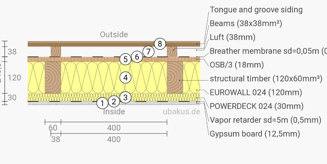

  1. Hi folks, I'm building a timber-framed garden office and have an insulation question. I'm cutting PIR to fit between the studs as you'd expect. The studs are 5x2, with 120mm Celotex boards that fully fill the cavity. OSB sarking and a breathable membrane are on the outside later, which will then be battened and clad. But I also have some spare 25mm or 30mm PIR boards, so was planning to fit these boards whole, on the inside face of the walls (across the studs), to try to minimise thermal bridging through the timbers. Vapour barrier and plasterboard will then go on top of that. Pic attached for clarity I'm also thinking the same approach with the roof, except that it has a 50mm vented gap at the top of the rafters as it's a cold roof. I don't think there are any increased risks of condensation inside the stud walls by adding this extra 25/30mm layer across the studs internally, but am doubting myself. Anyone able to advise?
