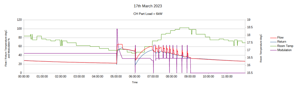

I read the article, it's very informative. Then I went back to a plot I made earlier this month when the weather was colder and realised it follows their logic. This is with the room thermostat in conventional (on/off) mode. The boiler starts up at 100% modulation (18kW) for hot water then 66% for the start of the CH long burn. Once the flow temperature reaches the target of 65C the modulation drops to 30% but because my boiler can't go below 5kW it starts the short cycles as the room temperature approaches the target of 18C. Mike -

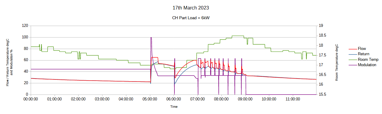

OK I think I'm going to drop the boiler tweaking for now as it's raising more questions than I can answer at the moment. Here are two plots from consecutive mornings, one with the thermostat in conventional (2-point) mode and the other in analogue mode (and return regulation). I can't see too much difference between them. The modulation is 100% (18kW) for HW. For CH the 2-point control looks to be better behaved. Thanks for all the input! Mike -

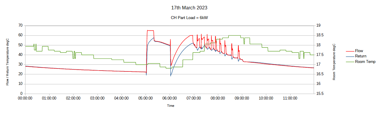

Yes agreed, but I'm pushed for time as the weather is getting warmer which makes it harder to get a meaningful result. As for disablehc, with the thermostat in 2-point mode it appears to act as a conventional on/off switch whereas in analogue mode it follows the CH programme (6am to 9am). HW is 5am to 6am. On the subject of flowtempdesired it's one of the few parameters I am unable to read on the bus. Don't know why ... You might just be able to see evidence of micro-firing in the above plot, which was logged at 30 second intervals. Zooming in for the rest of that day to 10 second intervals shows it more clearly. Also the Room temperature is well above target: I read elsewhere that micro-firing with the VRT392f thermostat can be eliminated by changing to return regulation, so that was today's experiment. Almost no micro-firing but back to short cycling and the modulation is stubbornly stuck at 63% ... Mike -

OK the rabbit hole just got deeper ... I changed the room thermostat mode to Analogue and set the CH Part Load to 6kW which is what I estimated the property's heat loss to be. There is also a +/-5 Distance setting which affects the response time to compensate for the distance between thermostat and heat source but I left that at zero for now. The obvious differences over 2-point mode are the behaviour of flowtempdesired and disablehc. The weather is now too warm for a proper evaluation but I would say this is looking promising. What does the panel think? Should I increase the CH Part Load? Mike -
