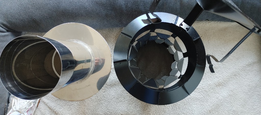

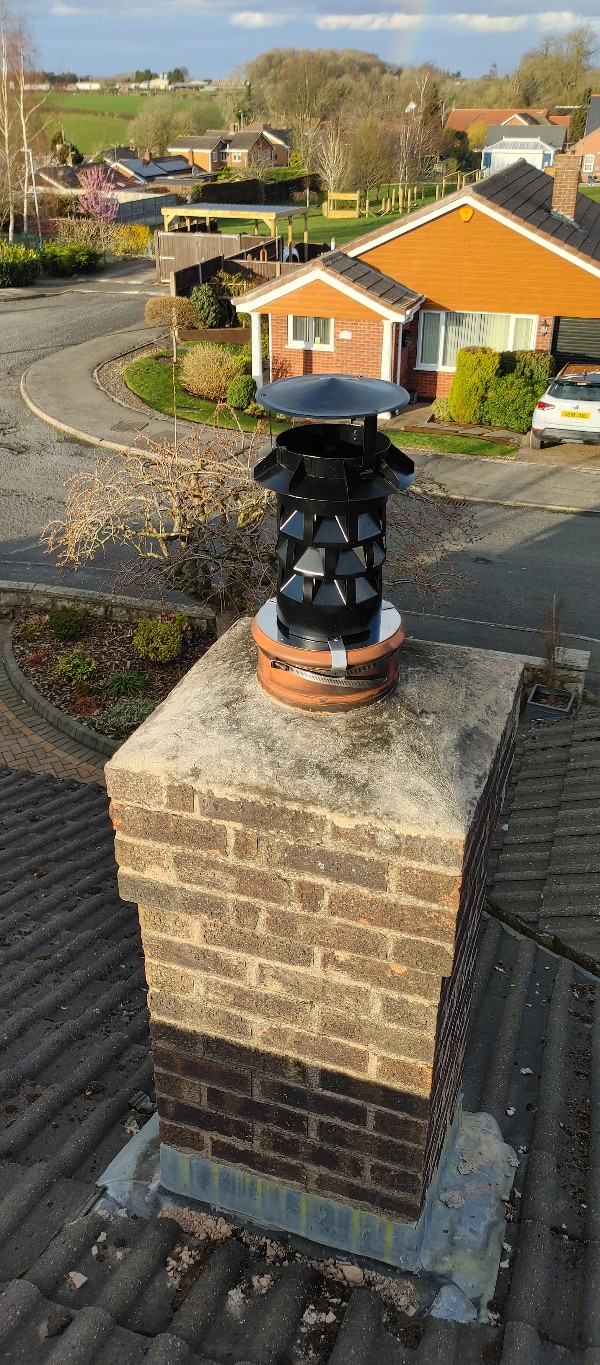

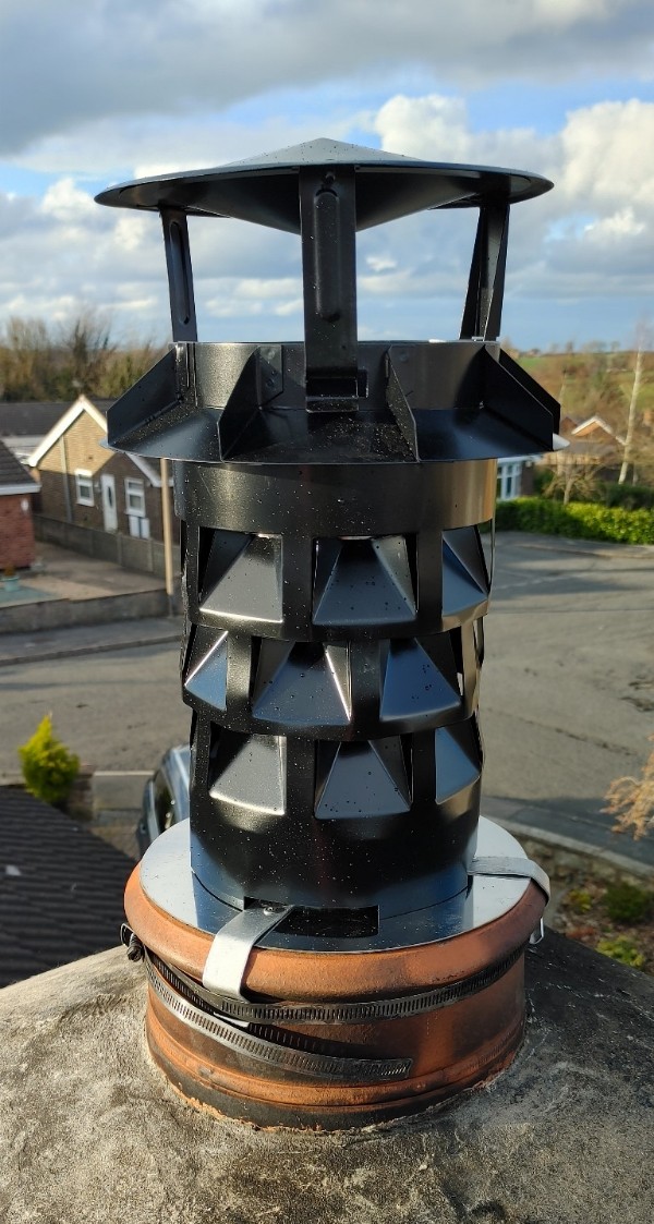

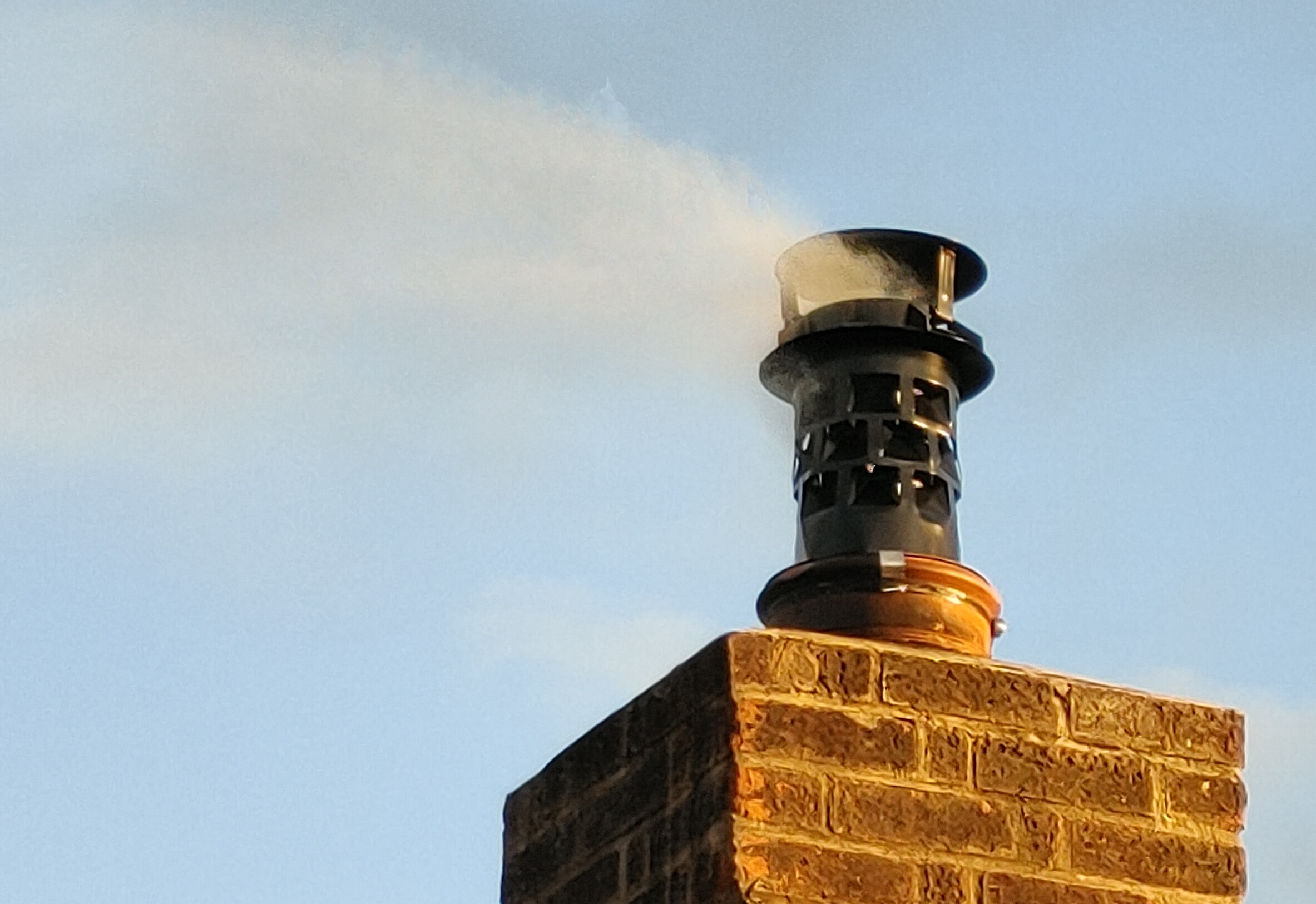

Here it is. Straightforward fitting. Used some 2mm thick strips of aluminium pop-riveted to the plug-in to positively fix it to the chimney pot.

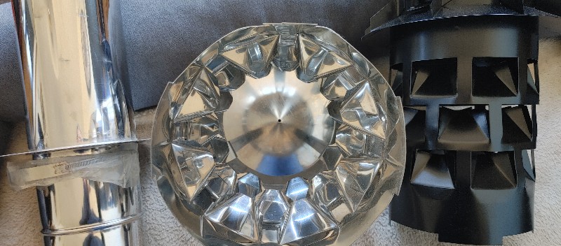

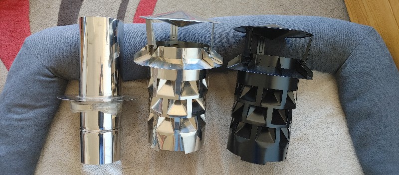

Anyone with a spinning cowl, wind vane or anti-downdraft type? Love to hear your experiences good or bad. I just purchased a Windkat, unfortunately still to be delivered after two weeks. Any other colour than polished stainless and it gets sent directly from Germany and there's obviously a huge backlog. Many new stoves fitted over there in the last year..
You probably did this job by now. It doesn't matter if the the tappers break through, in fact it's preferable. You can get an extra long stub adapter which are quite useful in your situation. https://www.stovefitterswarehouse.co.uk/products/long-nose-flue-adaptor-no-bolts-in-high-quality-stainless-steel-beware-cheap-and-thin-versions

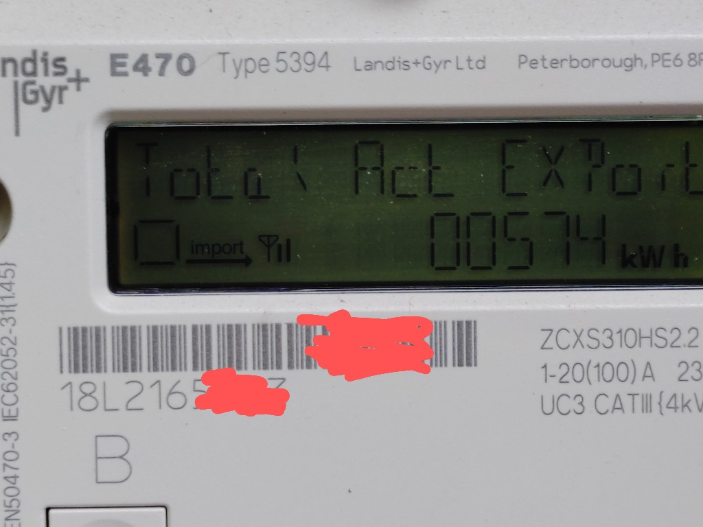

In July last year I tried to sign up with Scottish Power, filled in all the forms but in 6 months have received only one email telling me my Smart Meter display with export units didn't show the serial number. Not answered me since. Fortunately I have a second photo with slightly higher reading that does. Is it ok? Should I be using the separate export meter next to the inverter? How many more months before I get on their system and start getting the pitiful payments? Anyone else had trouble with them?

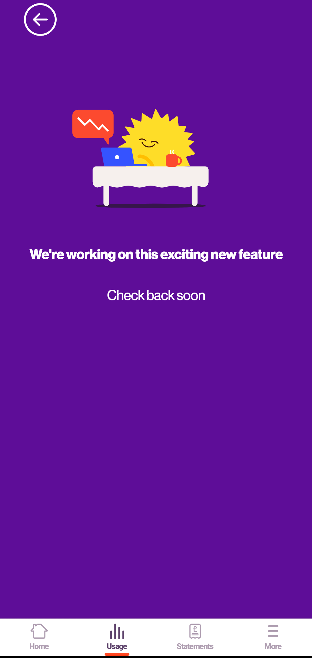

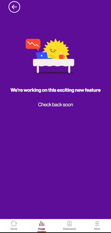

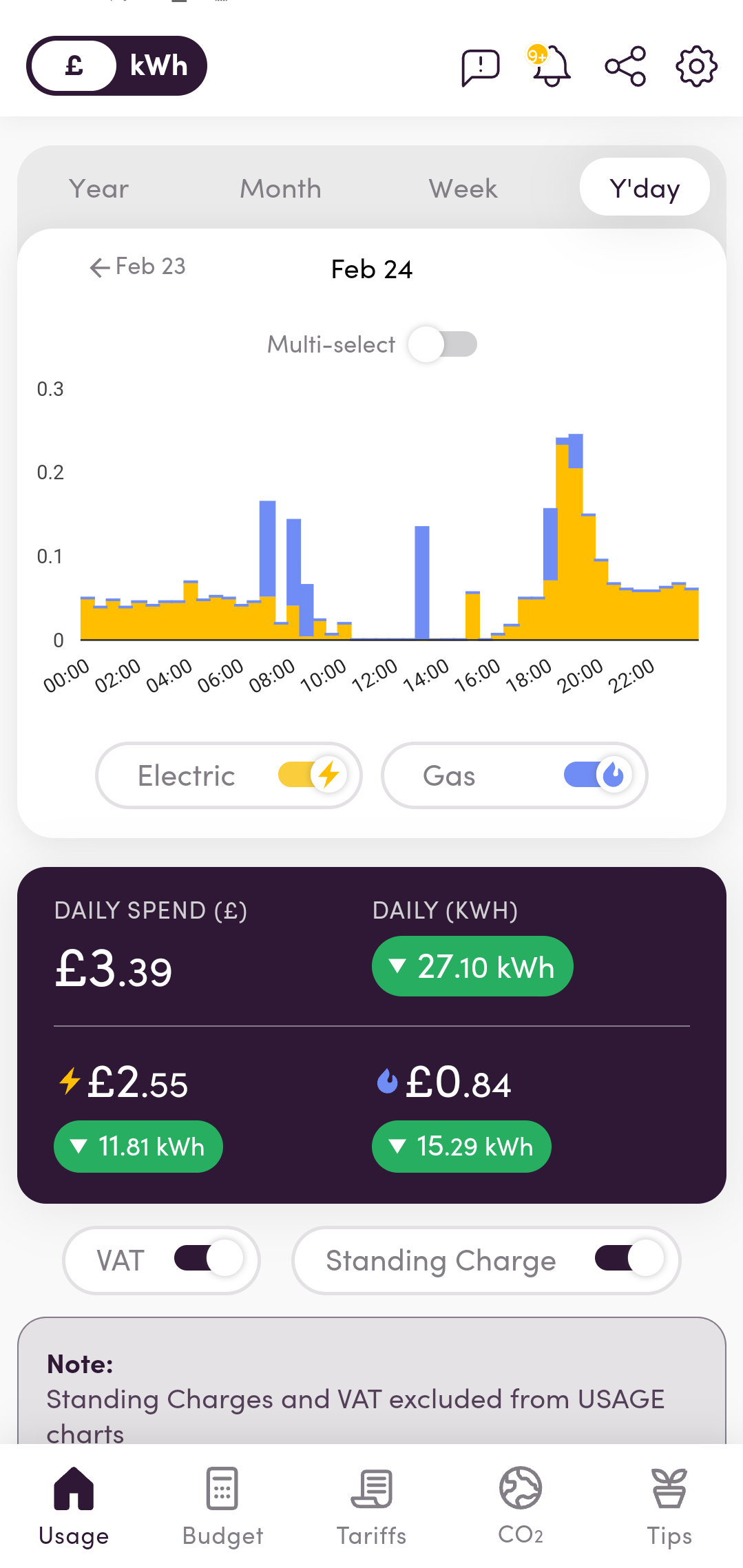

I have the Eon app and it's rubbish. Hugo and Loop are extensions of your Smart Meter display (IHD) which store over a year of data. Hugo is the more mature app, you can have a custom tariff and it's clever how you can have dual fuel on the same chart. A recent update added standing charge and vat, it completely mirrors what I am billed, as you would expect. -

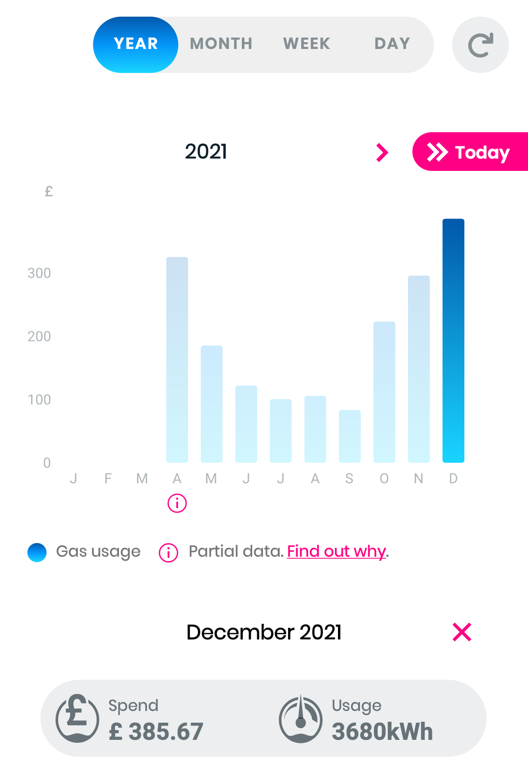

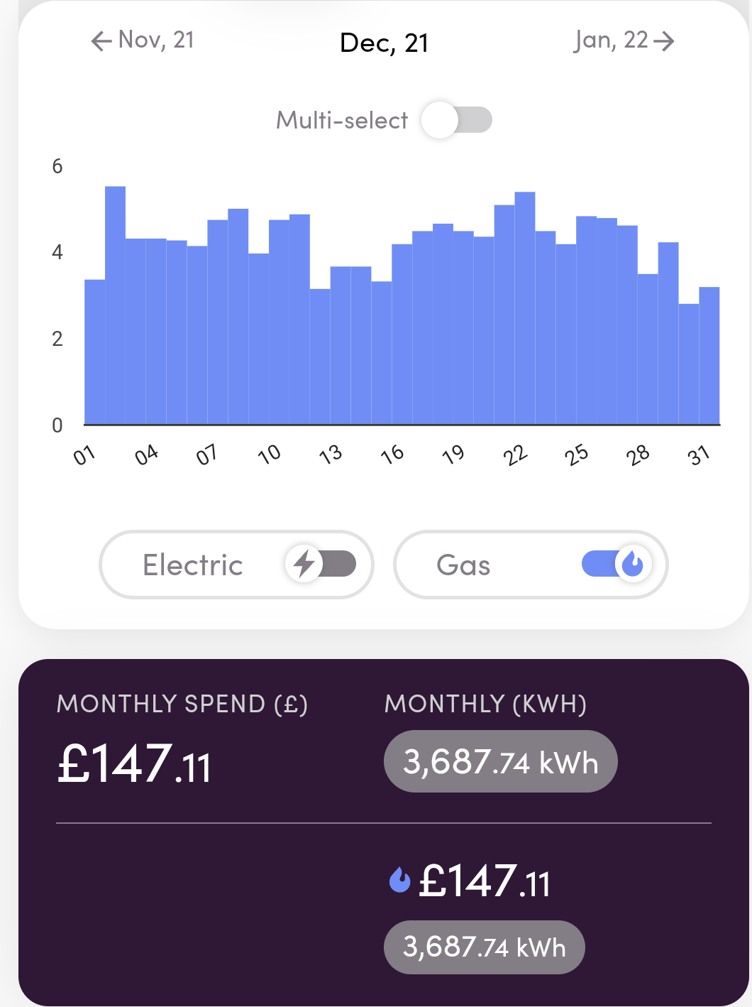

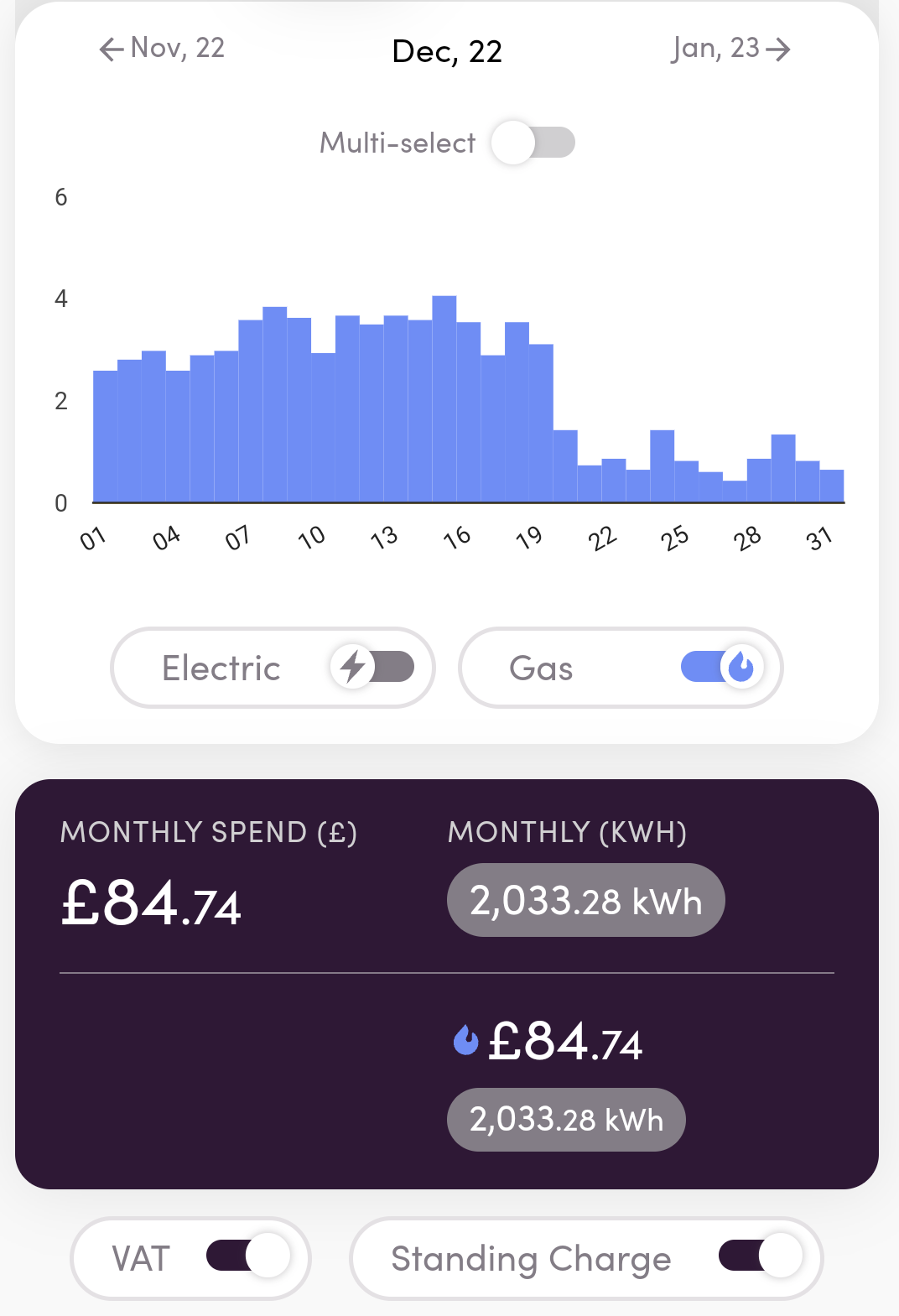

@IcevergeKeep wages out of the calculations. How long do you have to work before you can afford a heat source installation vs self-install of a £500 stove? Will it supply all the house needs (if one can be installed) and how's the noise with the window open at night? Lighting and maintaining a fire is not a chore. It's a pleasure, I find it quite relaxing. Wood heating is not for everyone. Also applies stoves full stop haha. Takes space to store and season logs. Better to buy it in or better still use solid fuel which has the highest energy density. I've got a real world cost analysis between old back boiler, new Worcester Bosch and DG Ivar 5 stove. It took a few weeks to balance my system, fit smart trv's and get the optimum flow temp. With no change in usage or insulation heating our 1970's 3 bed bungalow cost £147 Dec 2021 at 3.45p/kWh. Compare Hugo and Loop screenshots as Loop uses the latest tariff. 3680kWh would now cost £385. Our new boiler uses about 30% less or £100 for gas/month (Dec 2022 same tariff). Our log burner was commissioned Dec 19 so the actual bill was £84. January gas usage was just 1038kWh or £27 inc vat. Sawing wood is quite therapeutic, I don't mind. I could always be wasting my time in front of trash TV. Would be appreciated if critics could share their own personal circumstances and experiences. -
