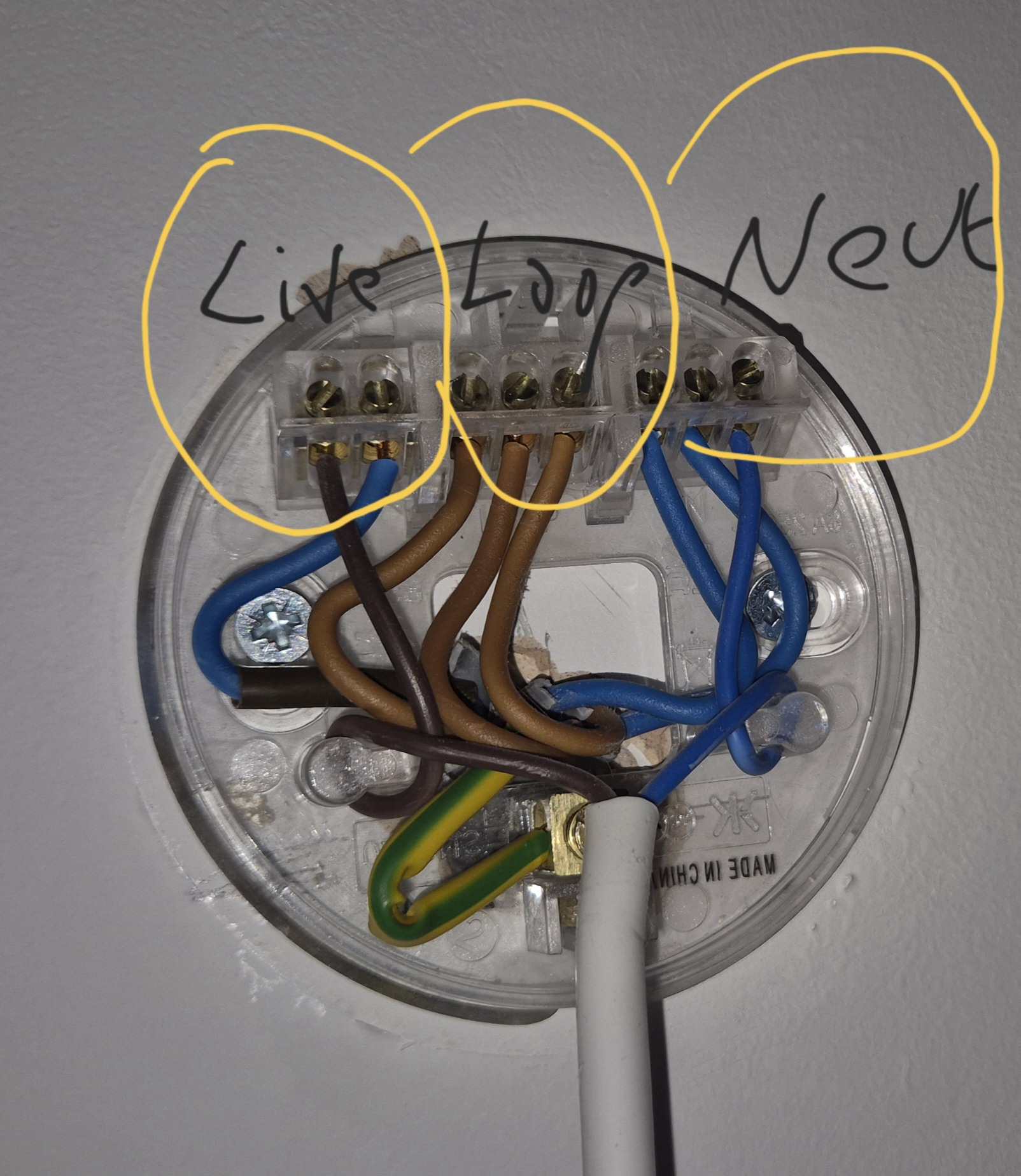

  1. OK one for tomorrow, the little lad is now tucked up in that room! I'll go over all connections again. Thanks
  2. Do the 3 brown wires need to be placed in the same order in the connector block as they are currently in the above original picture? The reason I ask is I've done the above, the new light works. All other bedroom lights still work too. As does the landing light. HOWEVER.... The upstairs bathroom lights (downlights) and extractor are now not working.
  3. Thanks, this all makes sense. Have picked up the 3-way and I'll follow those instructions. Thanks

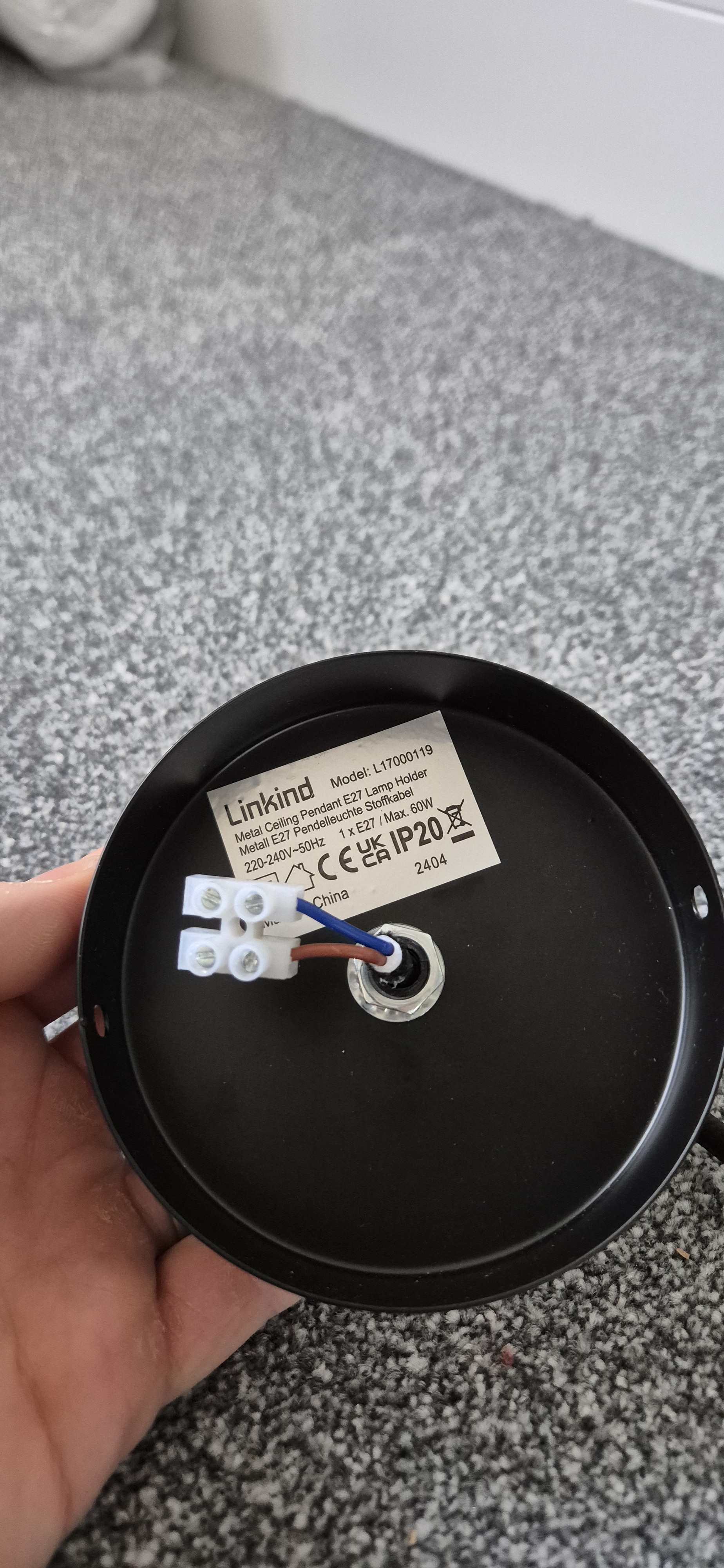

  4. Hello I've unscrewed the standard pendant light fitting to find the below combination of wires all hooked into various positions, 2 wires into Live, 3 brown into Loop and 3 blue into Neutral as labelled. My new pendant is a Class 2 and only has 2 positions for the Live and Neutral. See pictures. How do I go about wiring up the new pendant? Where do all the other wires need to go? I know for class 2 I'd terminate the earth and then wrap it up in electrical insulation tape. But no idea how to deal with the other 6 wires. Thanks

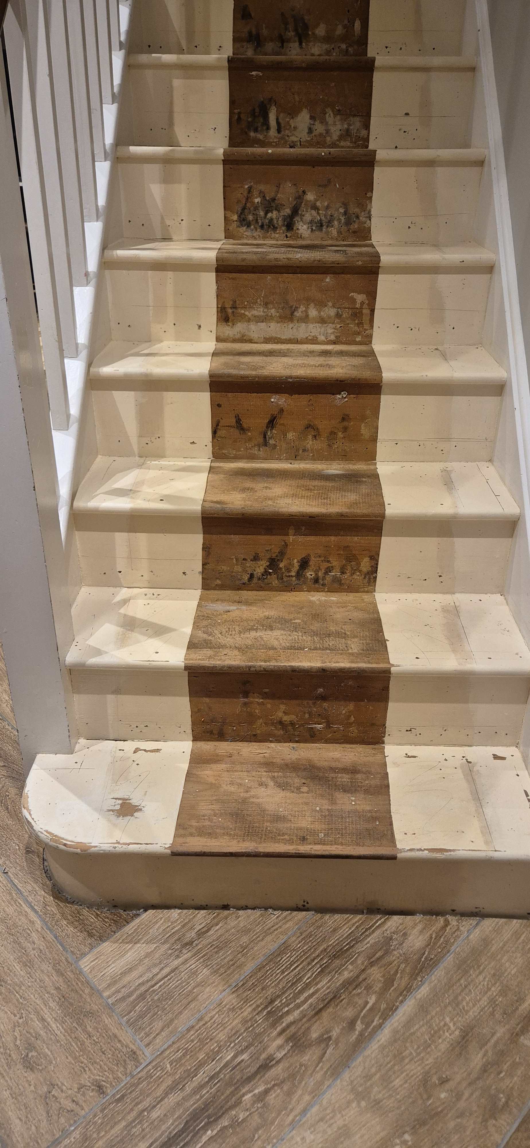

  9. Does anyone know where I should be looking to add additional screws to sure up some squeaky flooring on my stairs? Removed all the carpet and underlay today, ready for some decorating and a floor runner. However I'd like to try and address a few squeaks and creaks before getting on with that! I can't access under the stairs, so need to address from what can be seen in the photo. Cheers

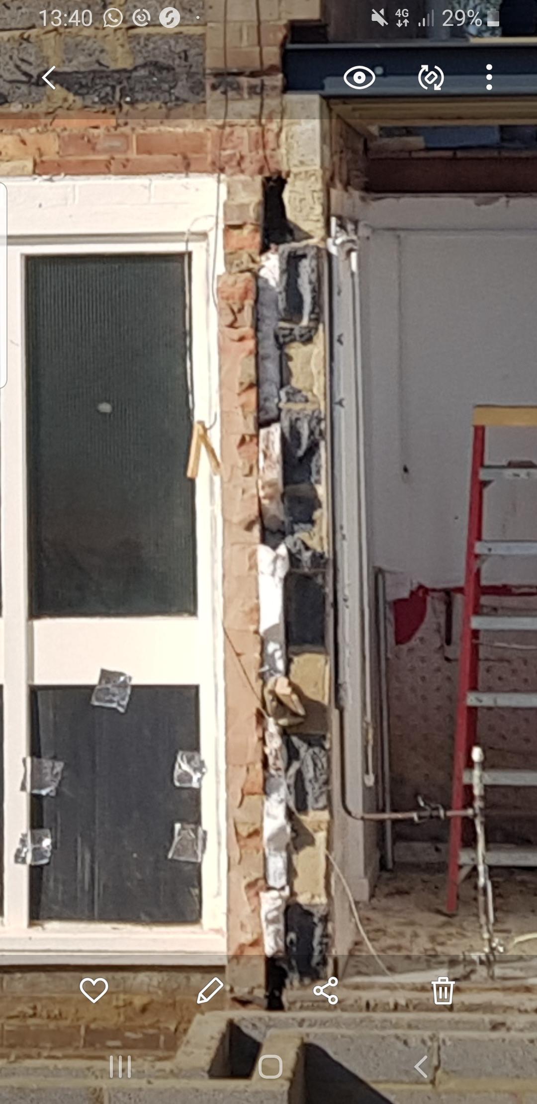

  17. This sounds like the stuff i have found in other other wall, i imagine it was done a long time back (can't really tell, only been in the house a couple of years) crumbles to nothing when you hold it. I was able to take it out in fairly large chunks. You can see some of it hiding in this small cavity, it's the white stuff protruding, comes out it largish chunks, but will crumble quite easily. Do I need to worry if it is formaldehyde? There are two piers, they line up with the two ends of the house, possible thermal bridging, but i am hoping to avoid messing around with them.
  18. Thanks @ProDave - You have me doubting myself now, we have taken down one of the walls on the leaf of the house which was brick and this did have the pumped insulation inside the cavity - but i will need to double check the blockwork forms part of a cavity. I was looking to hide the piers with the render TBH, as i am not a fan of the colour/type of brick. I take it you're suggesting that isn't advisable due to having to render over two adjoining different materials?

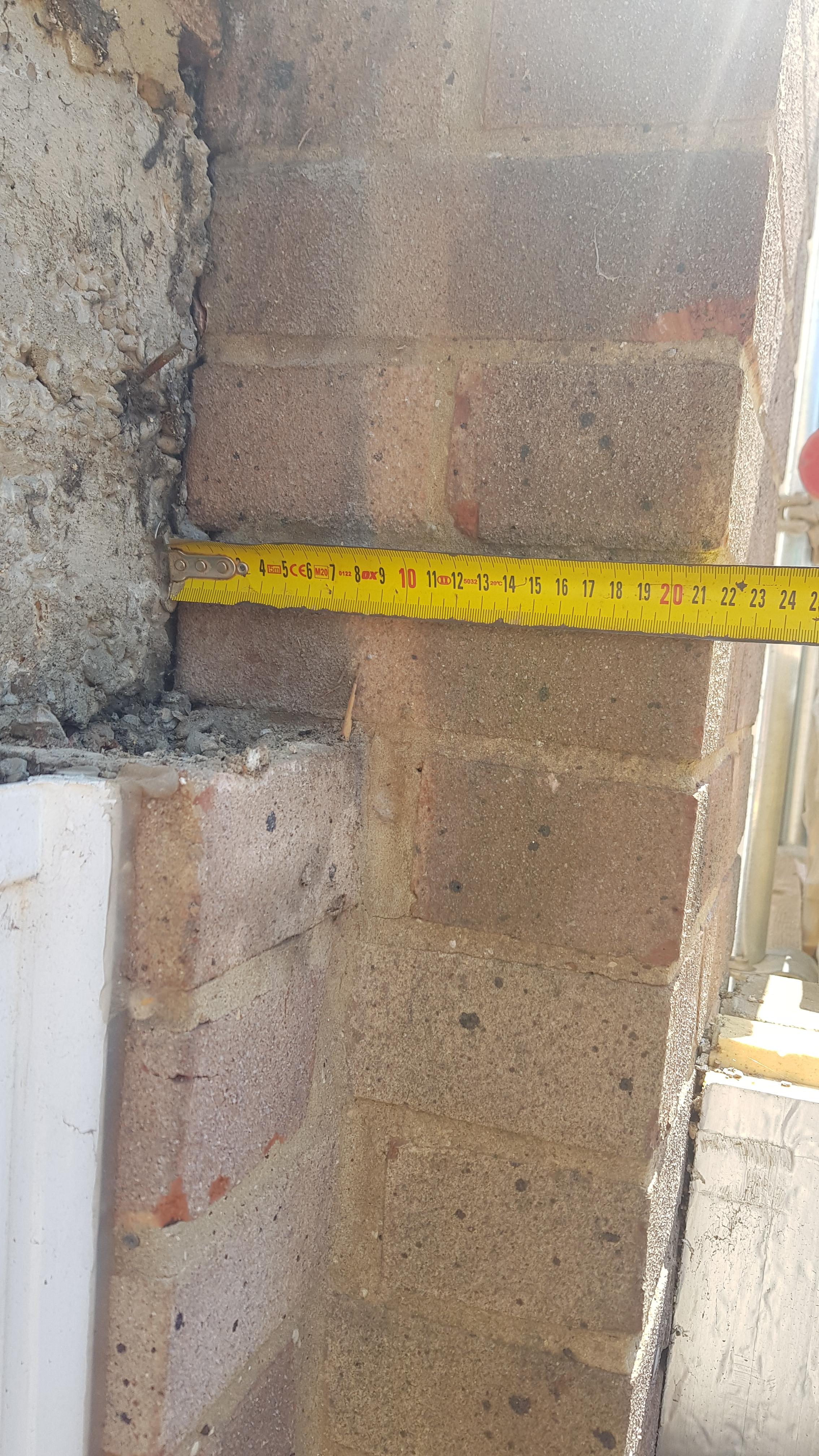

  19. Hello, we've removed old 1960's tile cladding from our house and intend to have a render finish. Before render, we'd like to add some external insulation (the cavity walls have an injected foam insulation, but it's not super effective). The hope for the insulation is that we can also achieve a flush finish with the existing brick piers at either corner of the house. As per the attached, you can see that the depth is around 190mm (200mm in places). I understand K Rend will have a finished thickness of somewhere between 14 and 18mm. So this means i need to find approximately 180mm of insulation. Does anyone have any ideas on what my options could be for application beneath the render? If i could aod having to do too much wood work to batten out, that would be ideal to reduce cost. So if there were any 'direct fix' solutions. I'm also not sure whether would need to leave an ar gap, as yo dou with a PIR when inserting into an external cavity. Cheers

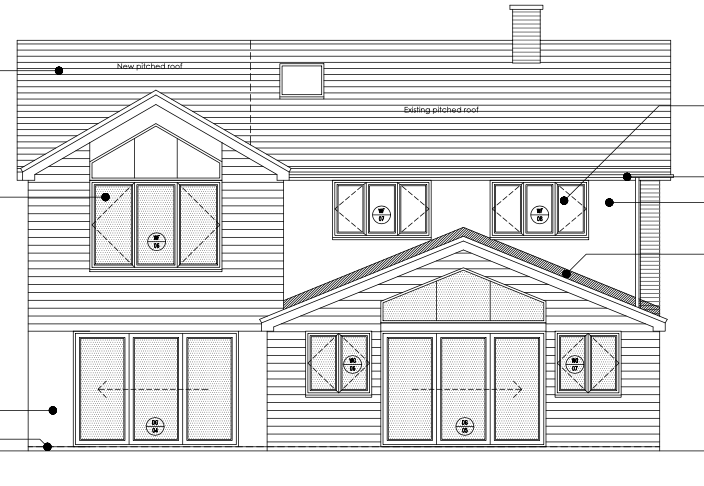

  22. We're into the build phase of our renovation and currently engaging with glazing companies to supply and fit our windows and doors, alu / alu-clad. The rear of the house is SW facing and as such whilst we're looking forward to the 90% of the year when we can enjoy brighter rooms, we also need to plan for the height of summer. Given i have windows, gable glazing and bi-folds, maybe i need to adopt a couple of different approaches. Keen to learn from anyone that have gone before me
