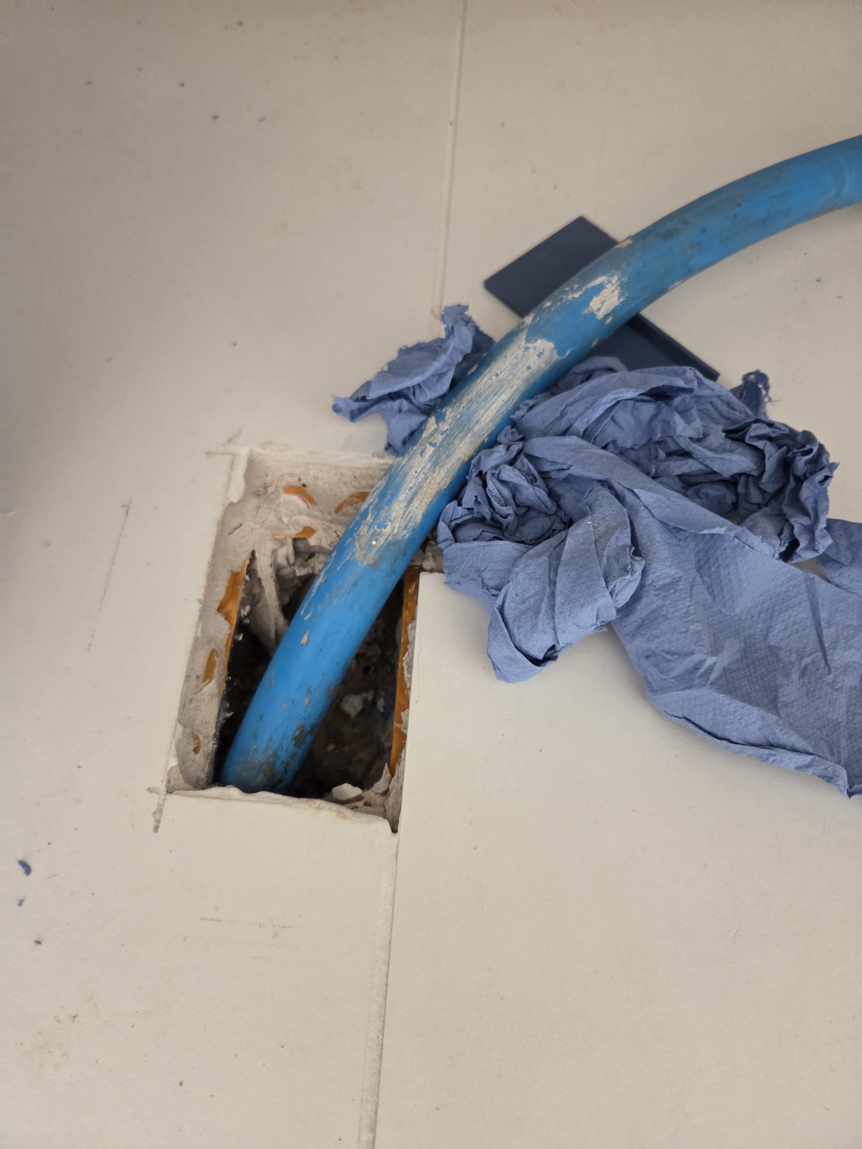

It's late 80s house build, I think, by David wilson. This has ducting is not the worse I've seen during the renovation. The other end is probably around the water meter 12m from this place and around 4m from the fron of the house, although I can't see it due to an amount of mess/soil around the meter. I spent 1hr digging and removing the soil just to be able to turn off water. If the condensation is from either some sort of leak (would need to be very small if the meter doesn't move when turned off) or rain/soil then isn't it better to let it escape by not pushing the pipe insulation to deep? If I put pipe insulation that doesn't go inside the hole than that covered pipe doesn't attract condensation and it just sits and breath on the pipe inside the hole.
Yes, unfortunately there is no leak at stopcock. I've checked it in number of ways. I can feel and smell damp further down and it smells like when you are inside bristol-bath two tunnels path.
I've now removed rockwool mineral wool from the hole and the pipe insulation from mdpe. The mineral wool is wet at the bottom. Not very wet but enough to assume that it may get quite wet if left for longer. I know it's breathable but will this not cause an issue if it attracts condensation quicker than it breaths? I wonder if just leaving it open is more sensible. I can cover the pipe partially as the whole and angle of the pipe doesn't allow to push it all the way to the ducting.

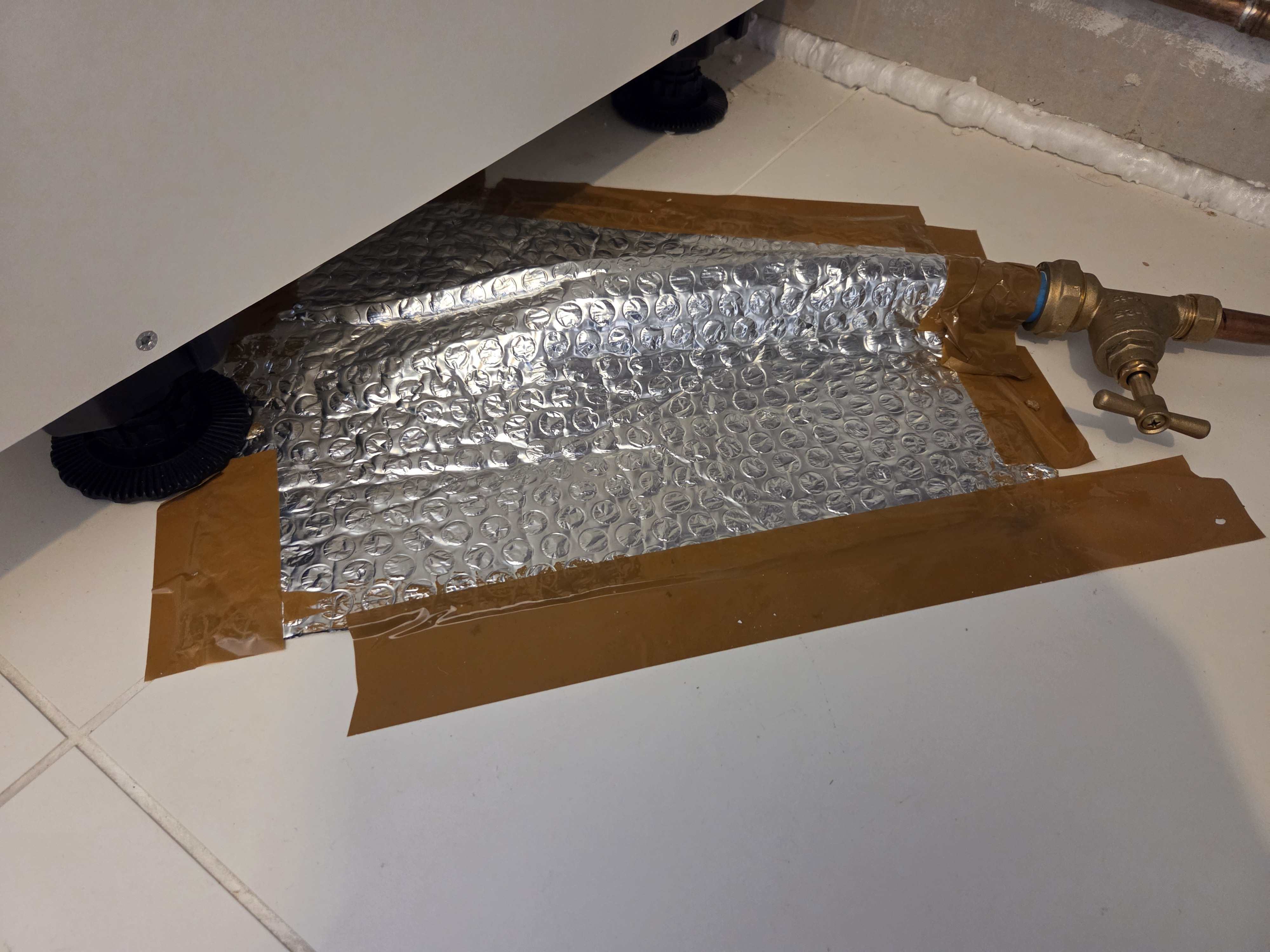

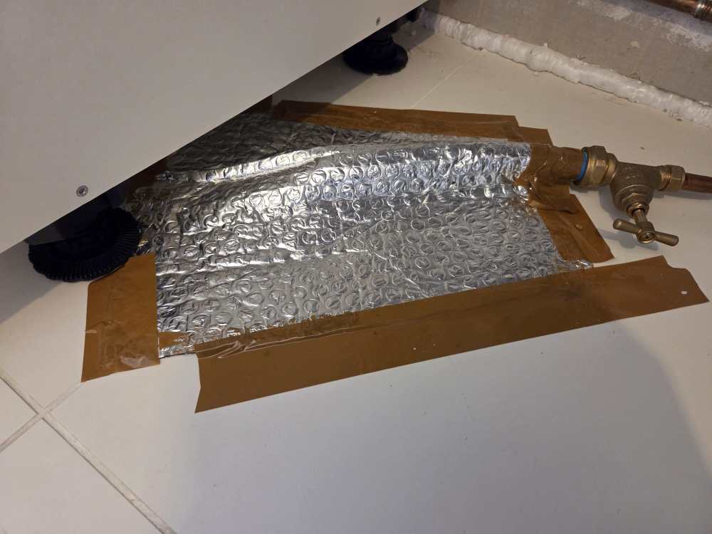

I've covered the pipe to see if this helps but also to make sure condensation comes from kitchen. To my surprise the foil is completely dry on outer side but wet on inner. Does the condensation come from the ground? Or is this some dpc issue? Shall I just cover it like this?
My worry is that when I close it with cabinet on top the condensation may cause mould.
New floor and everything rerouted to allow for more space and different kitchen cabinet layout but I spotted that the mdpe pipe is wet (just below the paper towels). I did a few observations and after sticking lots of towels into the hole I think it's just condensation. What's the best way to prevent it? Covering with kitchen cabinets will probably reduce it but shall I put some close cell foam into the hole?
