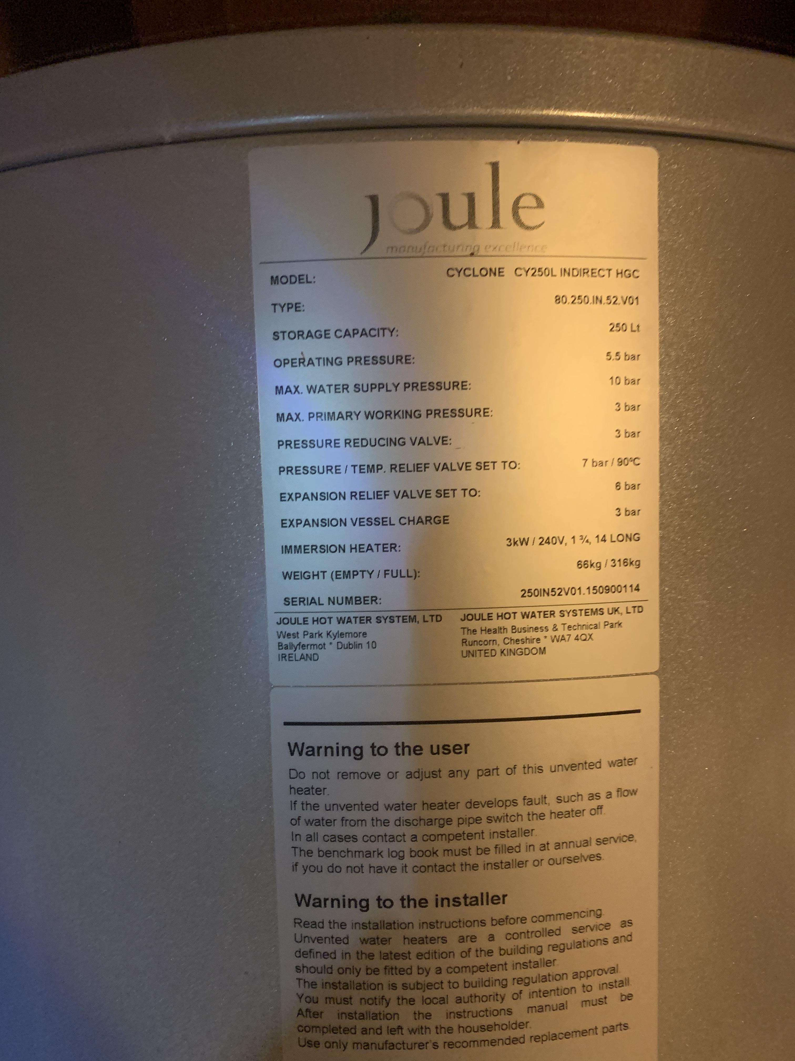

  1. Looking at a booklet that I have on the tank its described as a unvented Hot Water Cylinder which can have up to three water coils.

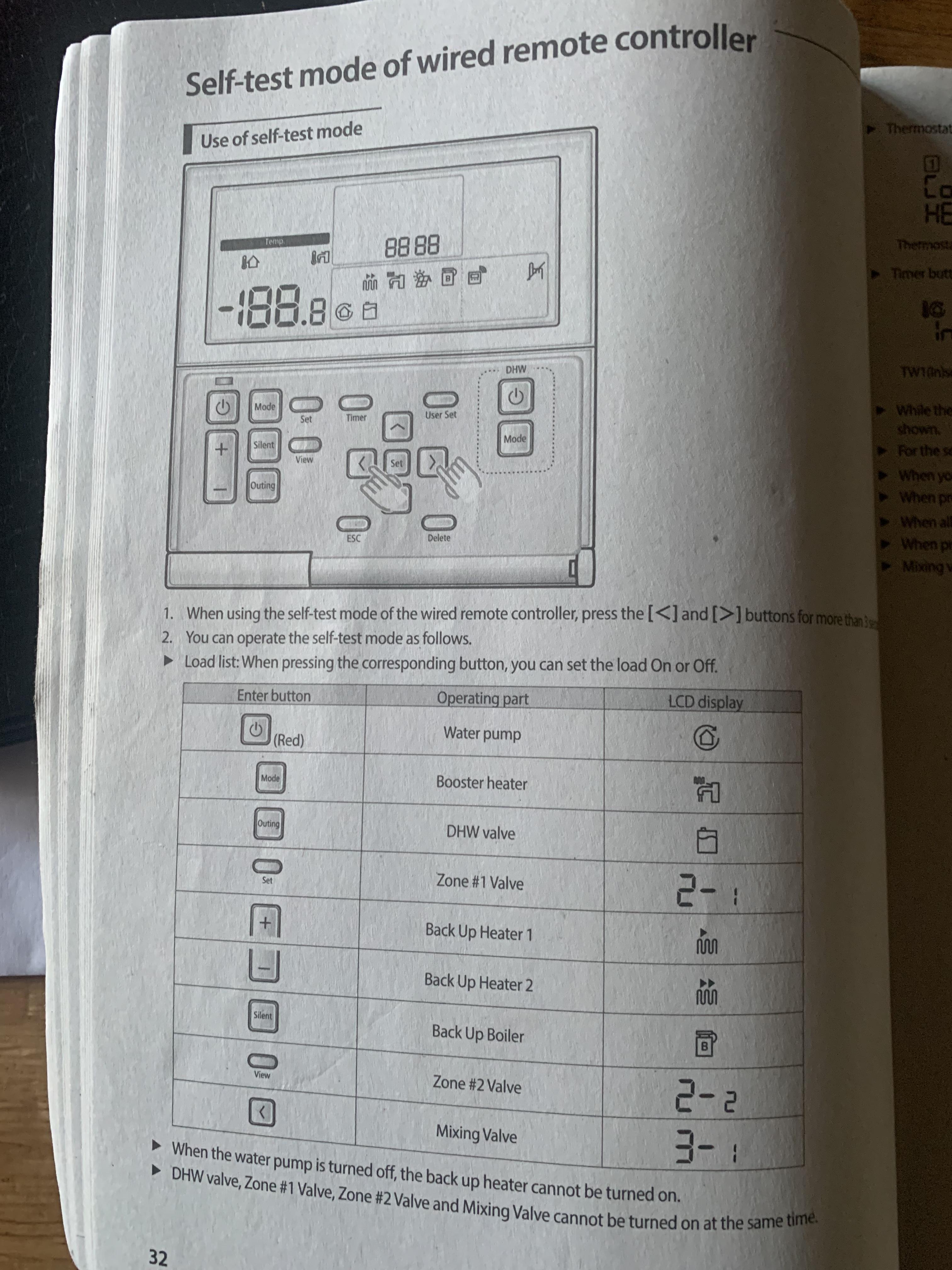

  11. To determine the switch over then ,there should be no heat icon showing at top right of controller , would that be correct , similarly the water tank symbol should not be active if rads/heat is on ?

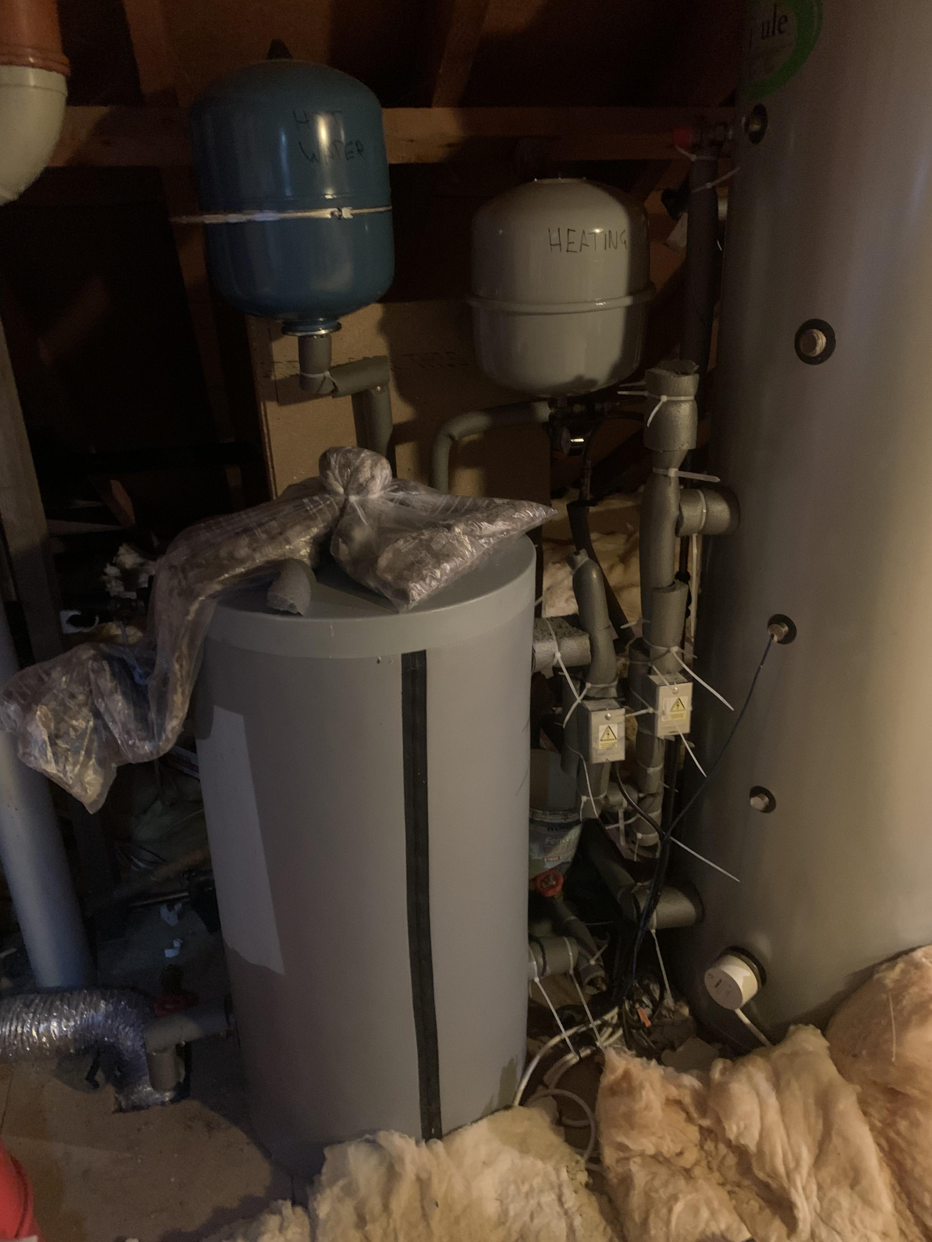

  15. So original plant was two pumps , not required they said , sold 9kw , reset 16kw with larger copper flow pipes instead of plastic, and further from wall. , better insulation , magnetic filter and glycol in fluid , plus a number of small things........ nightmare . Well you would wouldn’t you if you thought , finally it might work properly.

  18. Thanks Guys , once again , who is right about cylinder , I have no had any comments from an ashp service local to here or Black isle renewables , who have washed their hands to repairing or looking after this. I have set the flow to 51 and cylinder to 49 , so will see what happens. I will look at manual for clues.
  19. So continuing my circulation and hot water temp being low , anymore suggestions apart from getting a knowledgeable ASHP Engineer! You guys are the first to following up my particular problems and I cannot thank you enough. I will post 3 further pics of my insulation improvements and water tank specs. I thought I posted comments a wee while ago but I think that’s disappeared.
