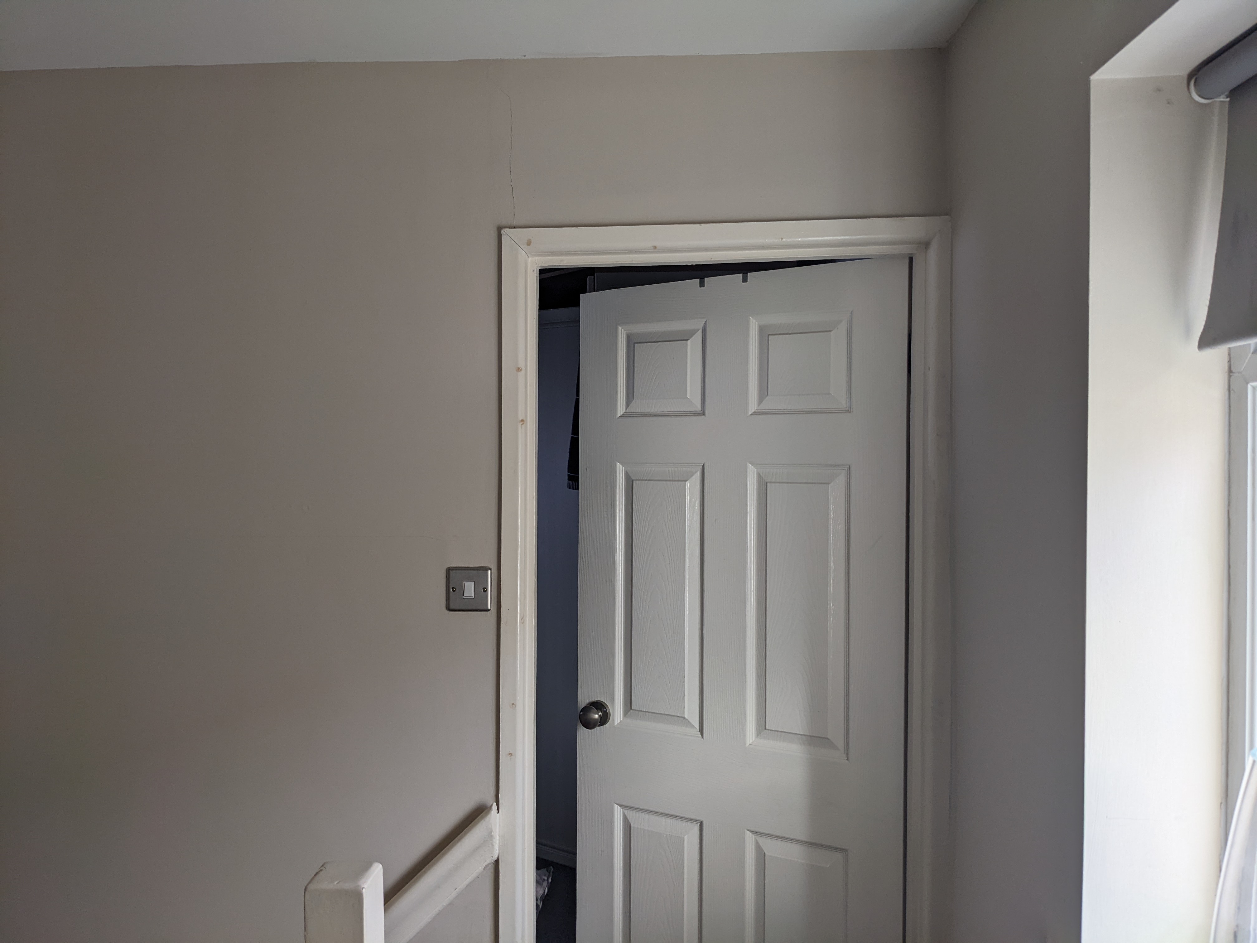

Recent Profile Visitors
garden4ork's Achievements
New Member

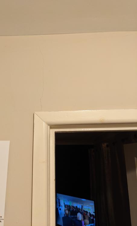

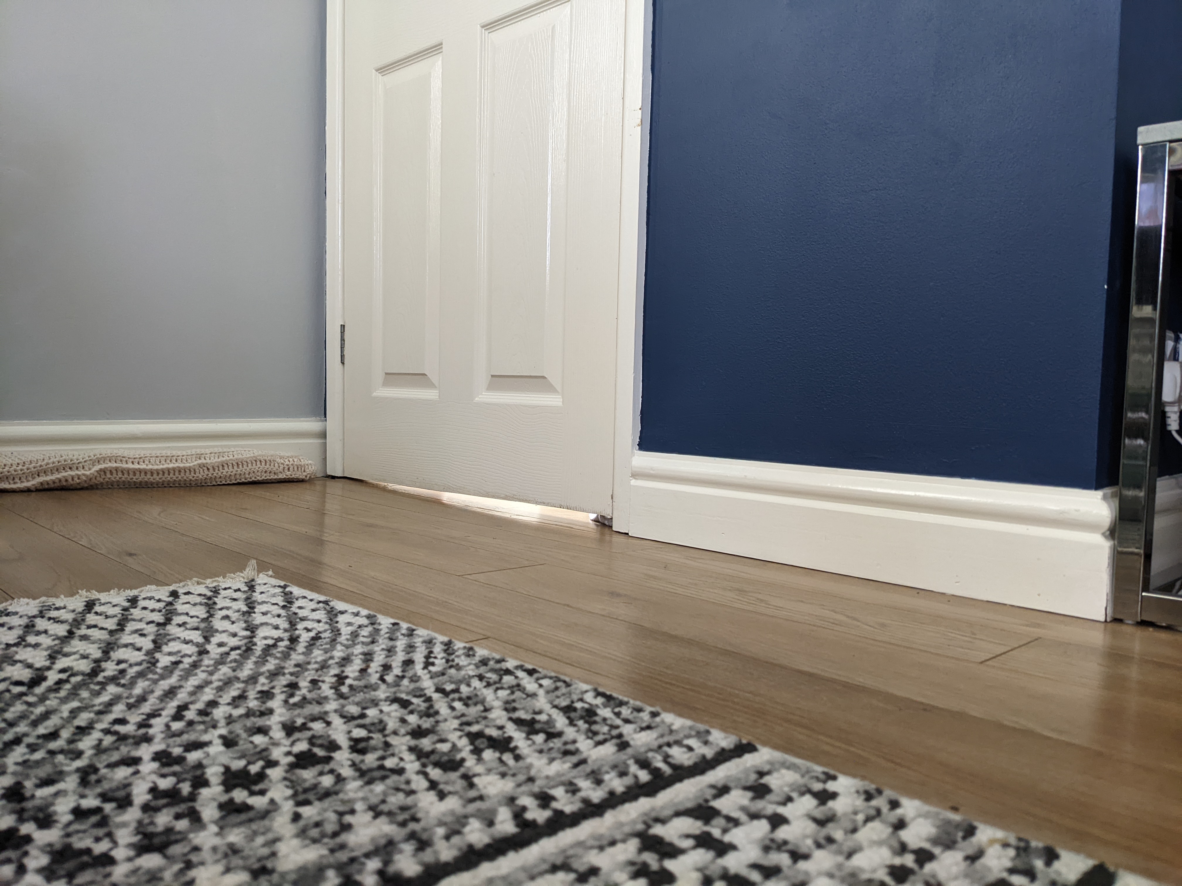

New Member (2/5)

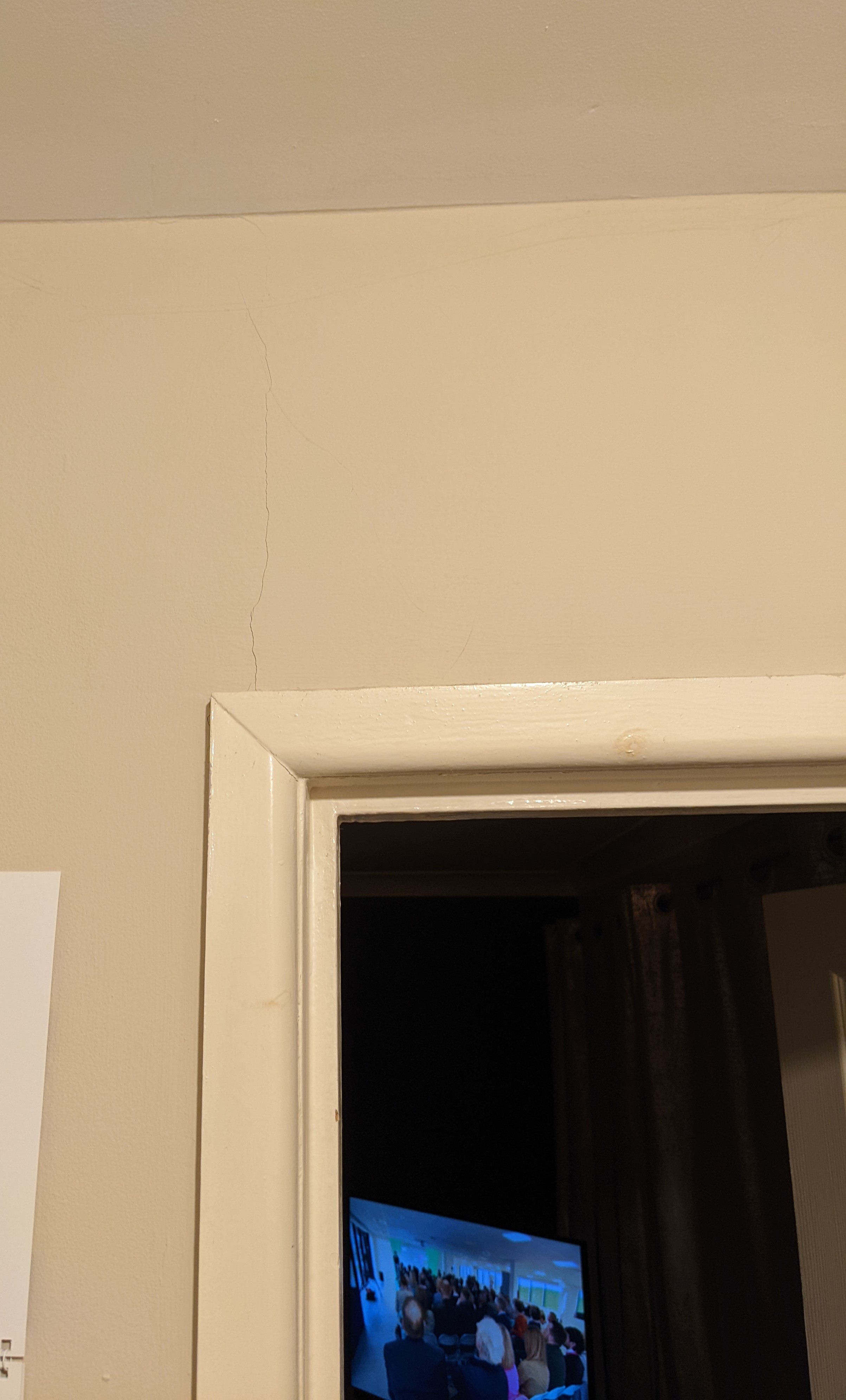

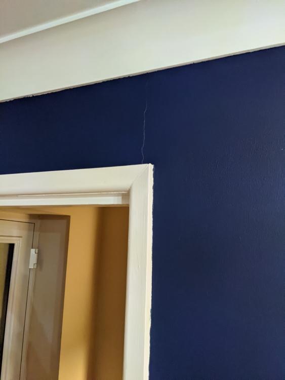

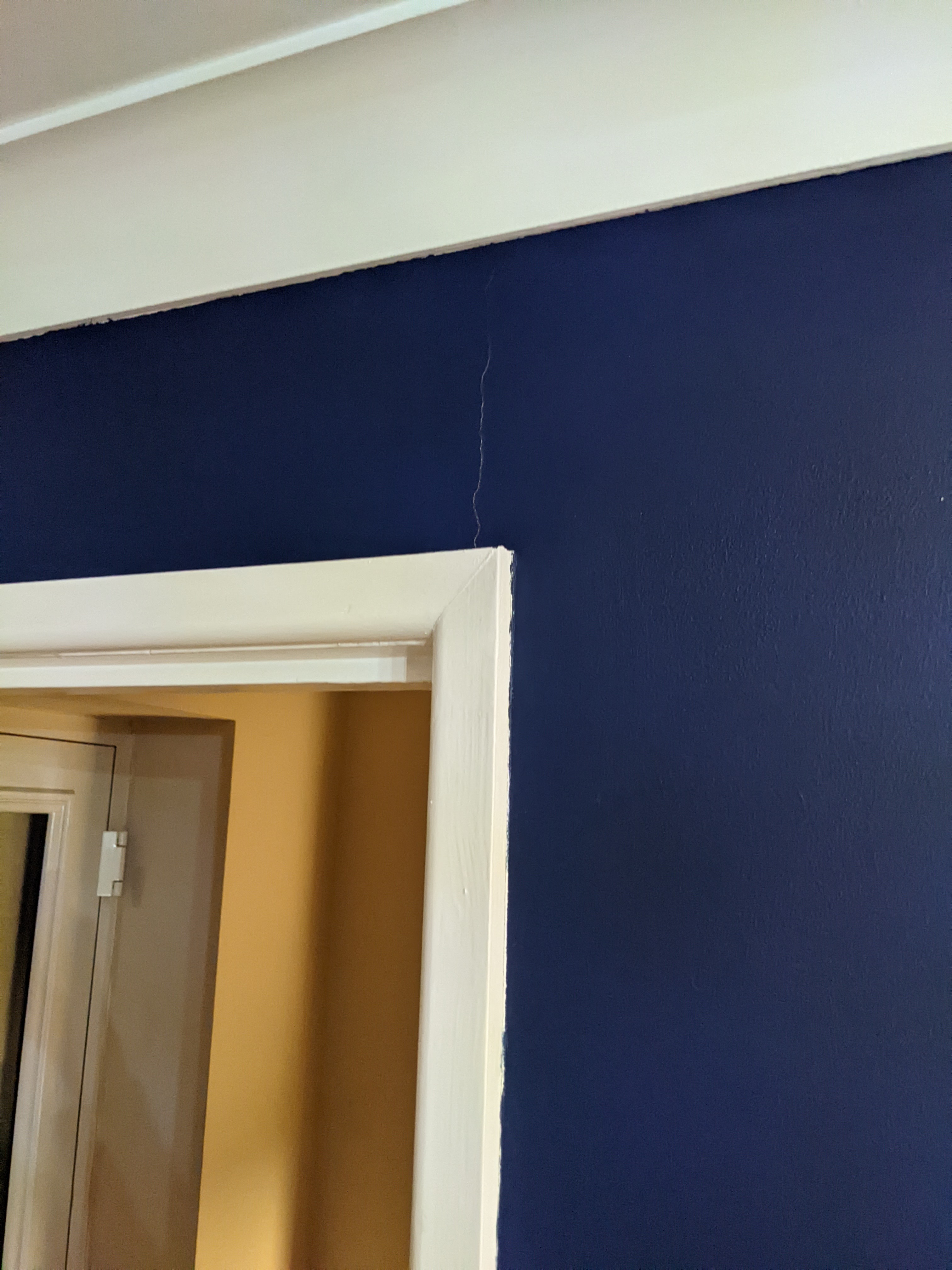

  6. Yes you can see the top of the frame is sagging towards the centre of the house. Also slight cracks in the plaster/plasterboard on both sides of the door The overbearing joist/joists makes a lot of sense as the central staircase wall (the only one which runs full height of house) sits on just one joist they both run parallel
  7. Attached images above Dave, while it doesn't look extreme we're planning on new windows/bathroom and I'd rather not sink money into that if it needs to go elsewhere

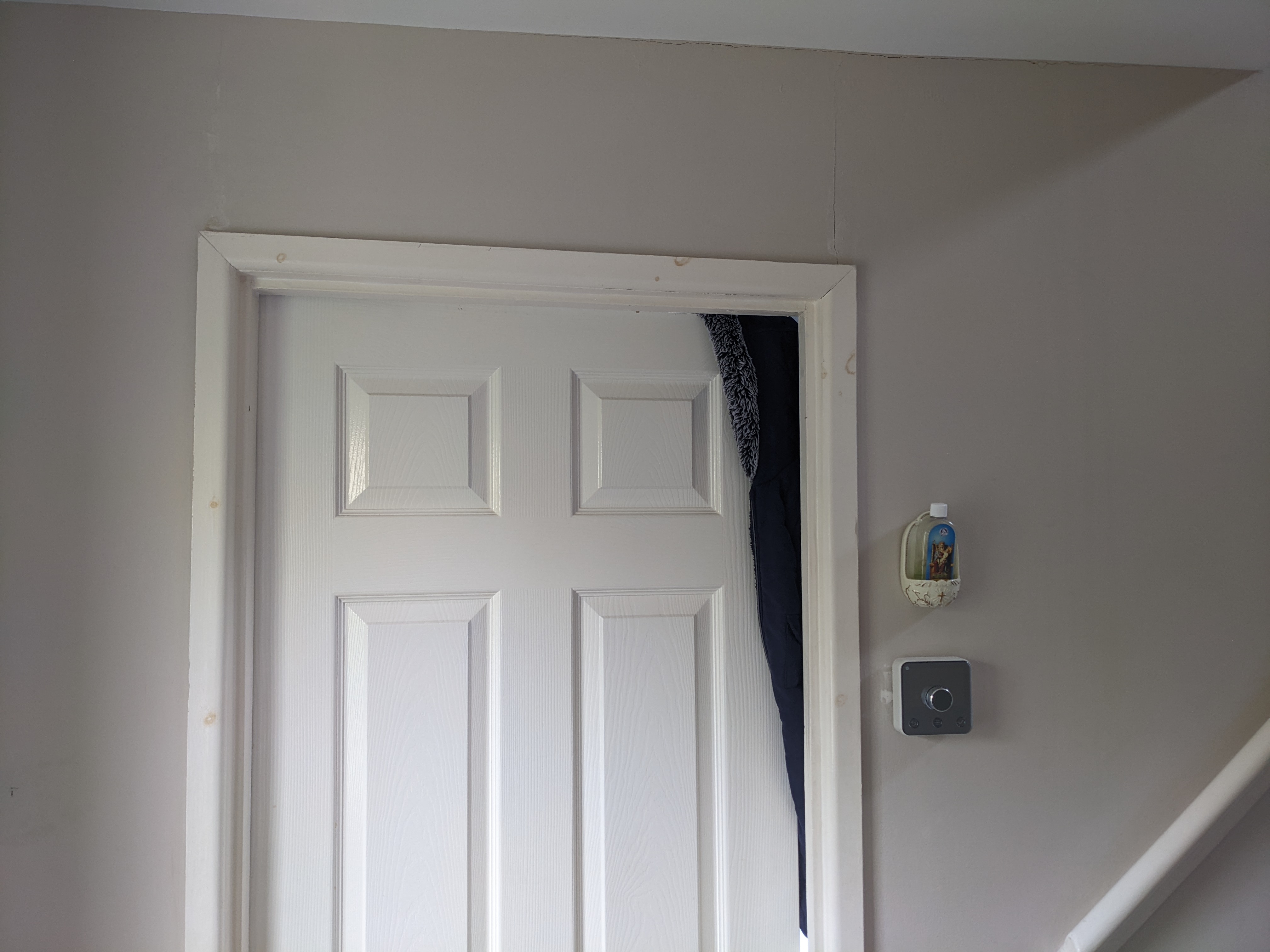

  8. Yes sorry, please see attached. The blue wall is on the ground floor, the floor does drop down and when the door is opened it catches on the laminate on the far left, so a considerable drop I imagine? If I lay a long spirit level down, there is a 'low spot' as well as bubble showing an offset to the centre of house Placing a ball on the laminate, it will always roll towards the centre of the staircase wall Image with the thermostat, you can see the door crooked and plasterboard cracking - it continues along the top of the wall. This is common for nearly all doors.
