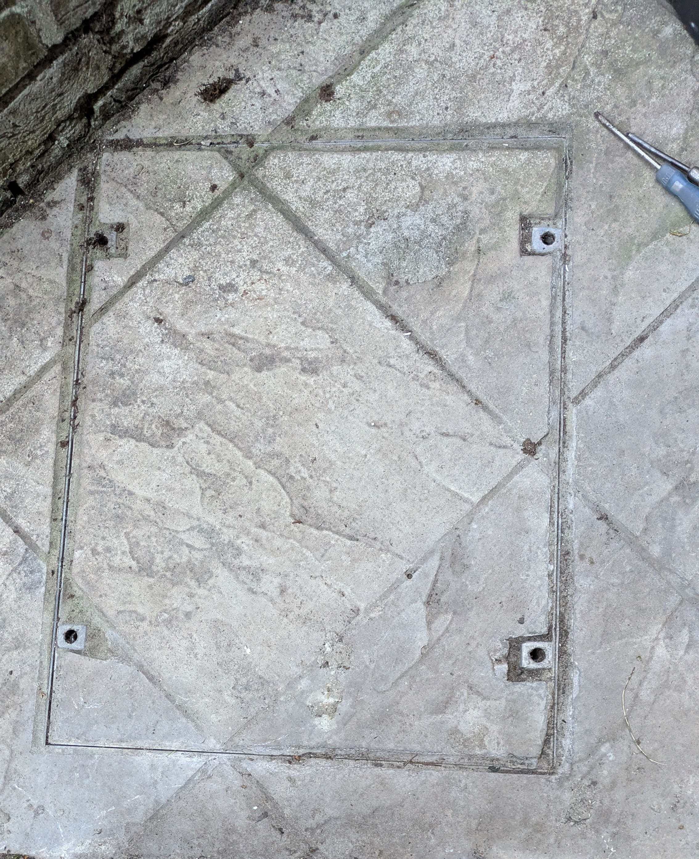

  4. I think I have found it, or at least it looks the same. Thanks all! https://www.wrekinproducts.com/products/access-covers/recessed-trays-floor-finish/38mm/c271m060045
  5. Thanks for replies. Those hooks look about what I had in mind. I have done picture searches, but nothing comes up. Maybe a chat at a drainage merchant,mas you say.
  6. Hello you helpful lot. Any guidance on how to lift this drain cover (picture attached)? Is it latched in some way, or is it 'just' a matter of getting the correctly shaped tools into the holes and lift? IS there a special tool/key for the job? I have tried a robust screwdriver, but cannot get any lift. Thanks in advance!
