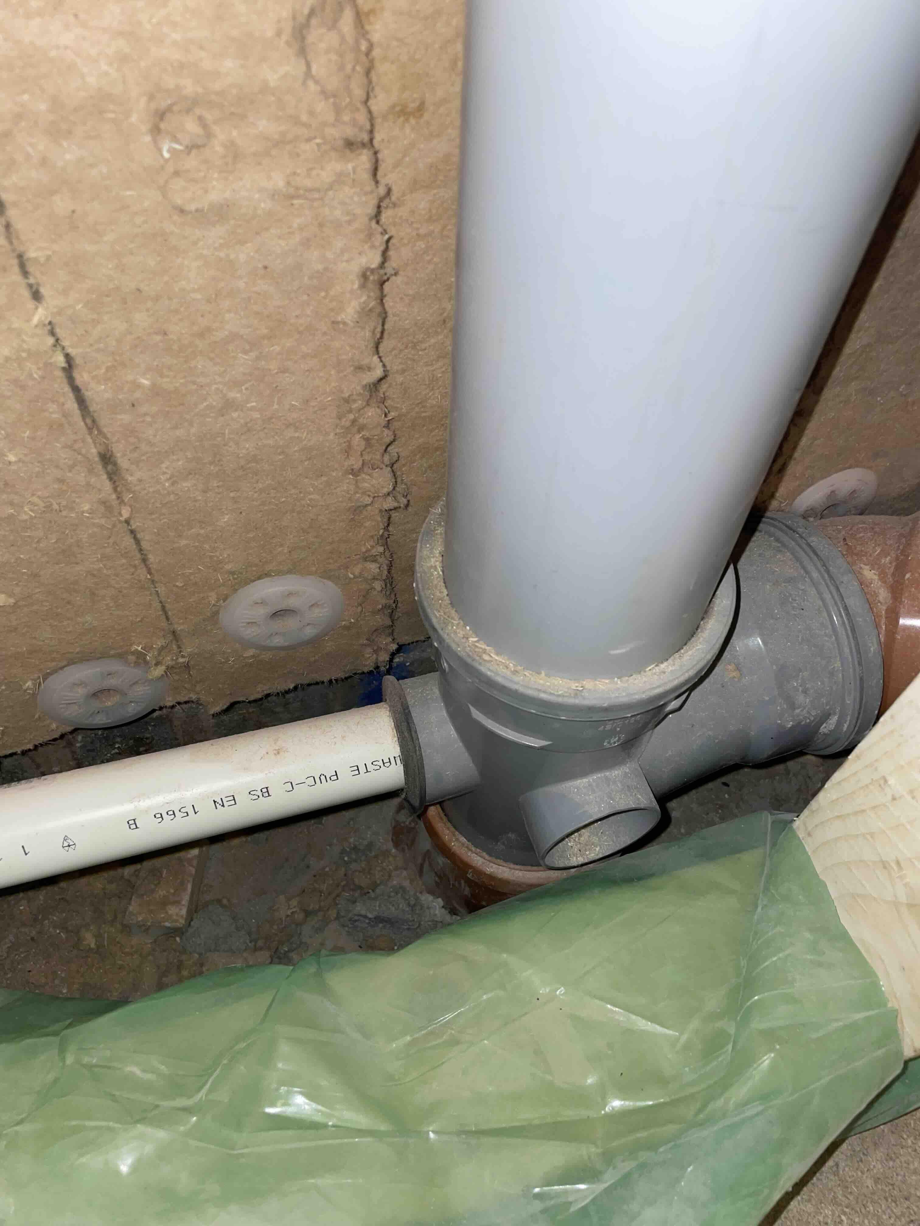

sorry for quality of pic - best I could do with the angles available ... the top of brown below-ground drain is essentially at finished floor level - the grey branch and pipe are above floor level.
Yep, there's a boss on the branch - problem is that's above the height of the shower waste! - hence the need to take an alternative route out.
Hi - thanks for the fast reply. There is a branch though it immediately goes into a rest bend. I don't think I can get a connector in there as the only options are the collar of the rest bend (too big), and the bend itself (too curved!) hence the approach of taking a separate shower waste out and joining outside.

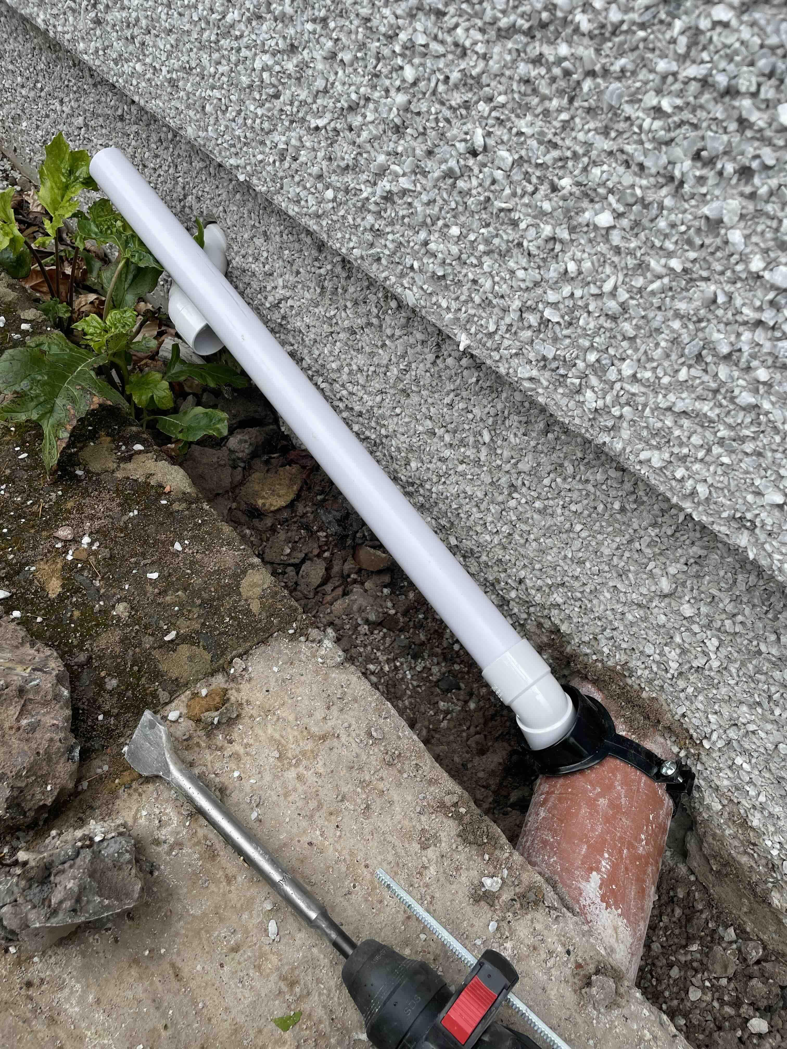

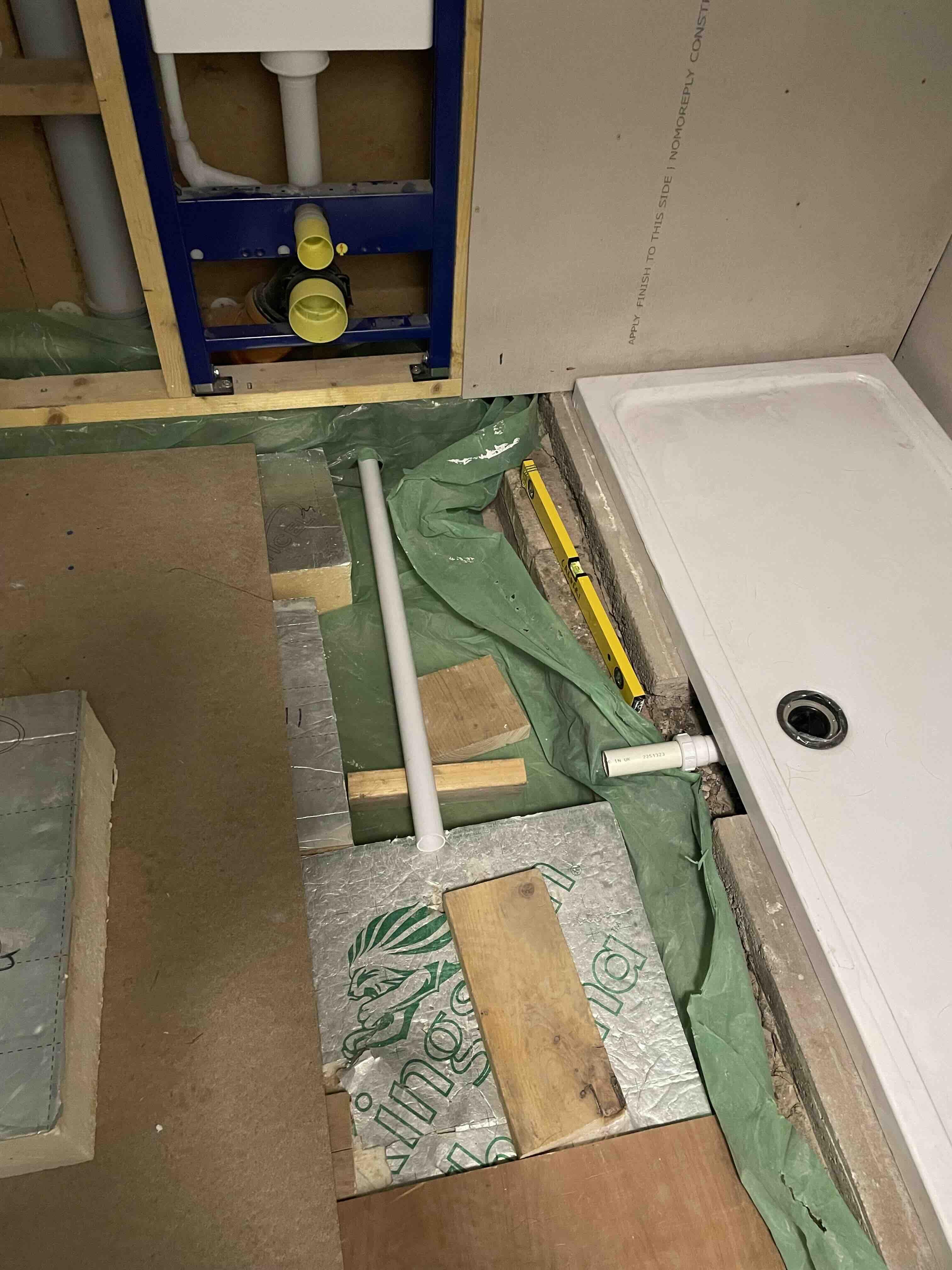

As part of renovations, we are putting an en-suite in. The original plan was to use a single stack which would be used for basin, shower, WC. Unfortunately the subcontractors put the new drain connection too high to allow the shower to be connected to this ... As a result, the proposal is to make the shower run separately to the outside 110mm drain, where it would connect towards the top of the pipe. Apart from the shower, all connections are to an internal sub stack with AAV. For the shower, the plan is to use 45' bends for flow/ rodding purposes. I think this is OK (certainly from a technical perspective) - though before going too far would like to test people's thoughts on how this may be viewed by building control. I've tried reading building regs though didn't get too far with them ... for what it's worth, we are in Scotland though assume the principles are the same as England! Cheers ...

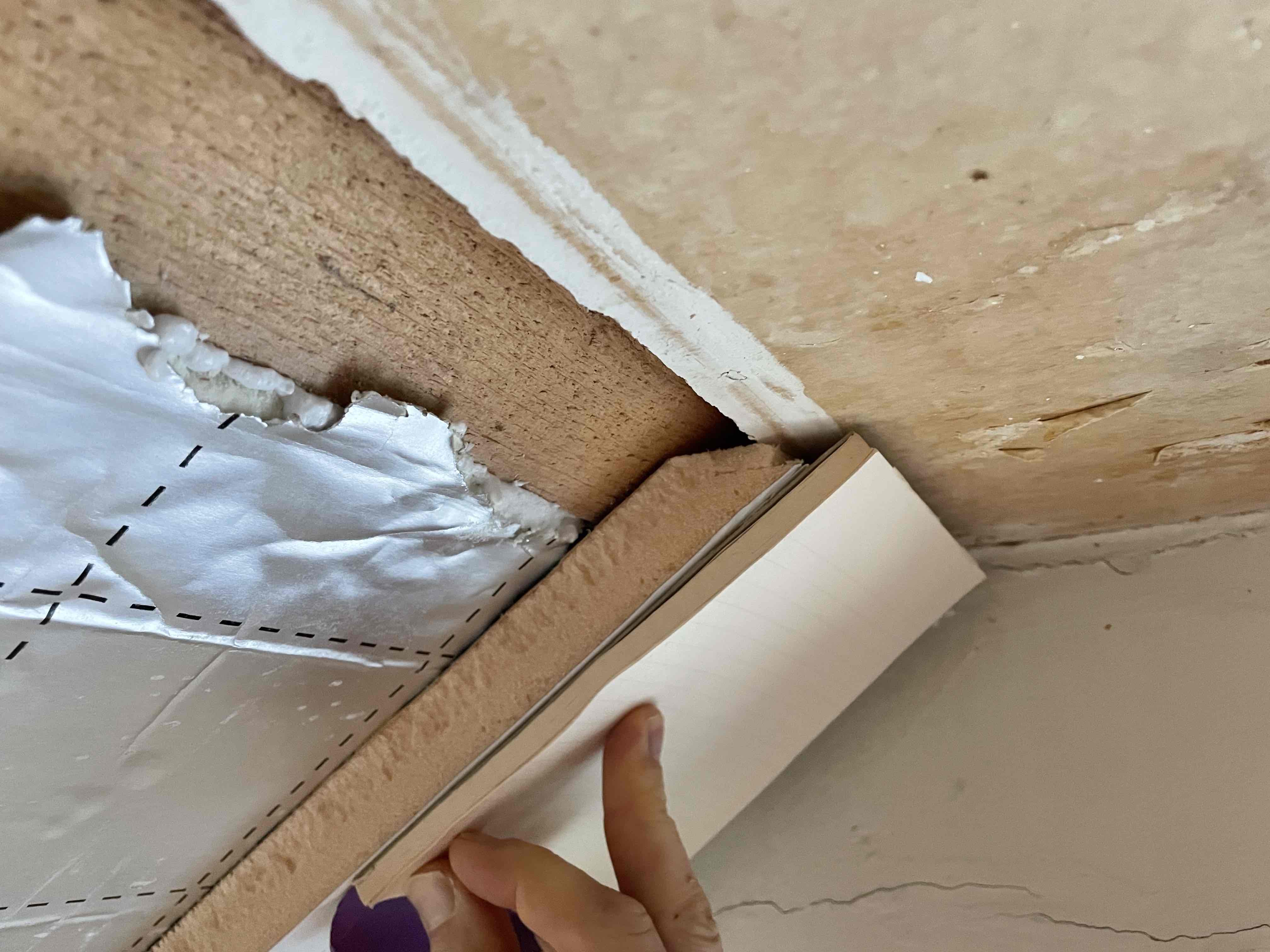

Morning. I've been struggling with this for a while and not found the solution here, so posting my query. I've been insulating the previously uninsulated sloping roofs in my 1960s house, taking existing plasterboard off and adding 75mm PIR insulation between the rafters. It's already had a satisfying 3-5'C improvement in the surface temperature of the roof! I'm thinking of adding 25mm insulation underneath the rafters, followed by a VCL (+ tape) and then plasterboard finish. I'll have it all professionally skimmed once done. I'm not clear how best to finish off the join with the existing plasterboard. I've knocked up a possible cross-section in the attached photo and would welcome feedback. While I'd taper the insulation, I was planning to leave the plasterboard butt-jointed (screwed into the existing horizontal plasterboard), leaving the finer details of taping, filling and finishing to the plasterer. Does this sound like a reasonable approach - or would I just be better leaving the boarding to a plasterer who can then do the whole job from start to finish?!
