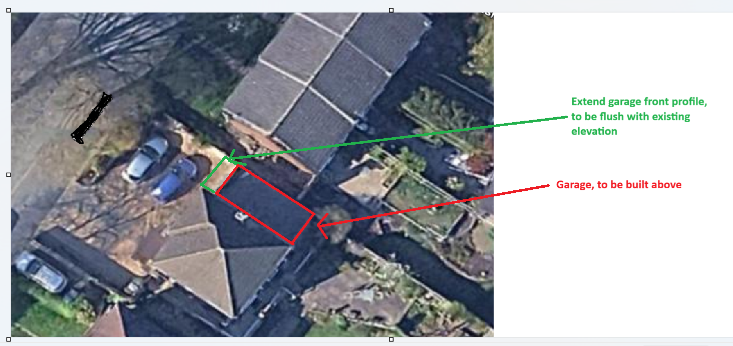

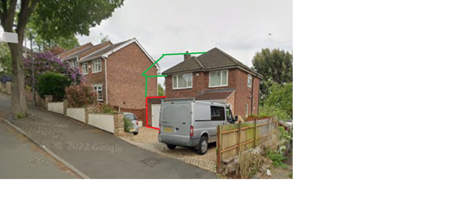

Hi again, Gus - hope you had a great Xmas, buddy đ Apologies for the late reply, but it's always a hectic time of year! đť I've enclosed some very basic drawings, which I hope help a little. Apologies, if they're a little crude, but hopefully they give a clearer idea. I can also provide a rear elevation if that helps - but maybe this already gives you a clear enough idea. Please ignore our property's exact roof layout, as it depends on final plans. But it should show it's (currently) a pyramid shape & the neighbours have a gable end facing us I've shaded our new extension a little, to highlight the changes we're hoping to construct I've also put a few rough measurements & projection lines on, to give an idea of overall perspective of us with the neighbour To recap: Their property front elevation is at least 2m forward of ours (& ours probably 2m further back from theirs, at the rear elevation). I'd guess their ground floor is 2-2.5m higher than ours. We also have the 3m gap between properties. The sun hits the rear elevation 1st & swings clockwise (the side away from the neighbour) to the front Hope that gives a better idea, buddy - feel free to ask anything else & I'll happily provide đ -

Cheers, Gus - those documents are excellent!! Really informative & clear. From what i can tell, the 2 main factors to consider in the design are: Orientation - avoiding a 'terraced' effect with other properties & being overly imposing Daylight & Sunlight - ensuring the proposal has no impact deemed significant enough for loss of light I've considered it as follows, for our side extension: Orientation: Our house is set back approx 2m from the neightbours There is a 3m gap between buildings The neighbours house is 1-2m naturally higher than ours Their roof is gable end, ours is sloped Our extension is 1m from the boundary line (neighbours building is 2m from theirs), making the 3m gap mentioned above Our side 2 storey extension 1st floor guttering is likely to be about mid-point between their ground floor and 1st floor rear windows Neither property has windows overlooking the boundary, nor will the extension There are a reasonable number of existing 2 storey side extensions in the neighbourhood, where they have built flush with the house front, and closer to their adjacent house, and in some cases not subservient in terms of profile or roof height (we'd add more details of the properties at submission time) It's likely we'd apply for party wall agreement, due to being only 1m from the boundary line Daylight & sunlight: Neither property has side windows, so the 25' rule shouldn't apply The 45' rule (horizontally from their kitchen window) - i can see by eye, that we currently don't cross this line with the existing garage, so wouldn;t anticipate the 1st floor extension to either The 45' rule (vertically from kitchen window - i wasn't aware of this until now!). It's unlikely we'd cross this from our 1st floor guttering level, but it would be within a meter i'd imagine Pitched roof - as ours will be a pitched roof, then it seems like we take the 45' vertical rule from the midpoint, in which case we'd definitely be fine. Is this pitched roof midpoint interpretation correct? Sunlight - both houses rear gardens are Southern facing (South-East, to be precise, so there might be some shadows cast early morning on their front lawn, side of house early afternoon & maybe the rear late evening/sunset As the roof is sloping and 1st floor halfway between their ground floor and 1st floor window, the amount of shadow is far less than it would be on even ground. The shadows would likely hit the side of their house (with no windows) likely no more than halfway up. There are a number of mature trees on the road that could obscure their property from sunlight, regardless of our extension, so hopefully we won't be causing any major impact We don't believe a VSC would be required, given the above All the above is only a high level appraisal, and would need more accurate measurements and assessments. But we feel this is a good starting point for our case This is a crude drawing of the proposed side extension (in orange). The footprint remains unchanged to the existing one, except for moving the front edge forwards 3/4m, in line with the existing front This is not to ask whether you consider the proposal would be successful, but more to enquire if there are other things we should consider when designing & applying...... -
