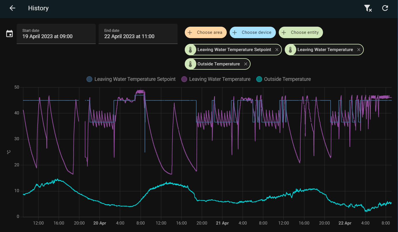

  1. I've got exactly this issue on my ASHP which I'm raising with Daikin Mine's a pretty simple heating only setup with a single LWT set at 45 degrees going via a plate heat exchanger, so quite a small primary loop. Above 8 degrees outside, the unit cycles between on and off as requested "normally" When the outside temp drops below 8, the unit drops the LWT to 35 degrees and keeps the unit on: In terms of power usage, I've looked at the period between 22:00 on the 19th and 02:00 on the 20th. Each 90 second burst of running uses about 30wh, which it fired 7 times in that 4 hour period. So it uses 210wh over those 4 hours. I know some units get a 180w crankcase heater that run permanently, 24/7 all year I'd love to know what setting they changed? Did they turn the freeze prevention off? Did they leave a new system config report? Did they update the installer manual with the new settings (they should have)? Ashley
  2. Those are reassuring graphs, thanks
