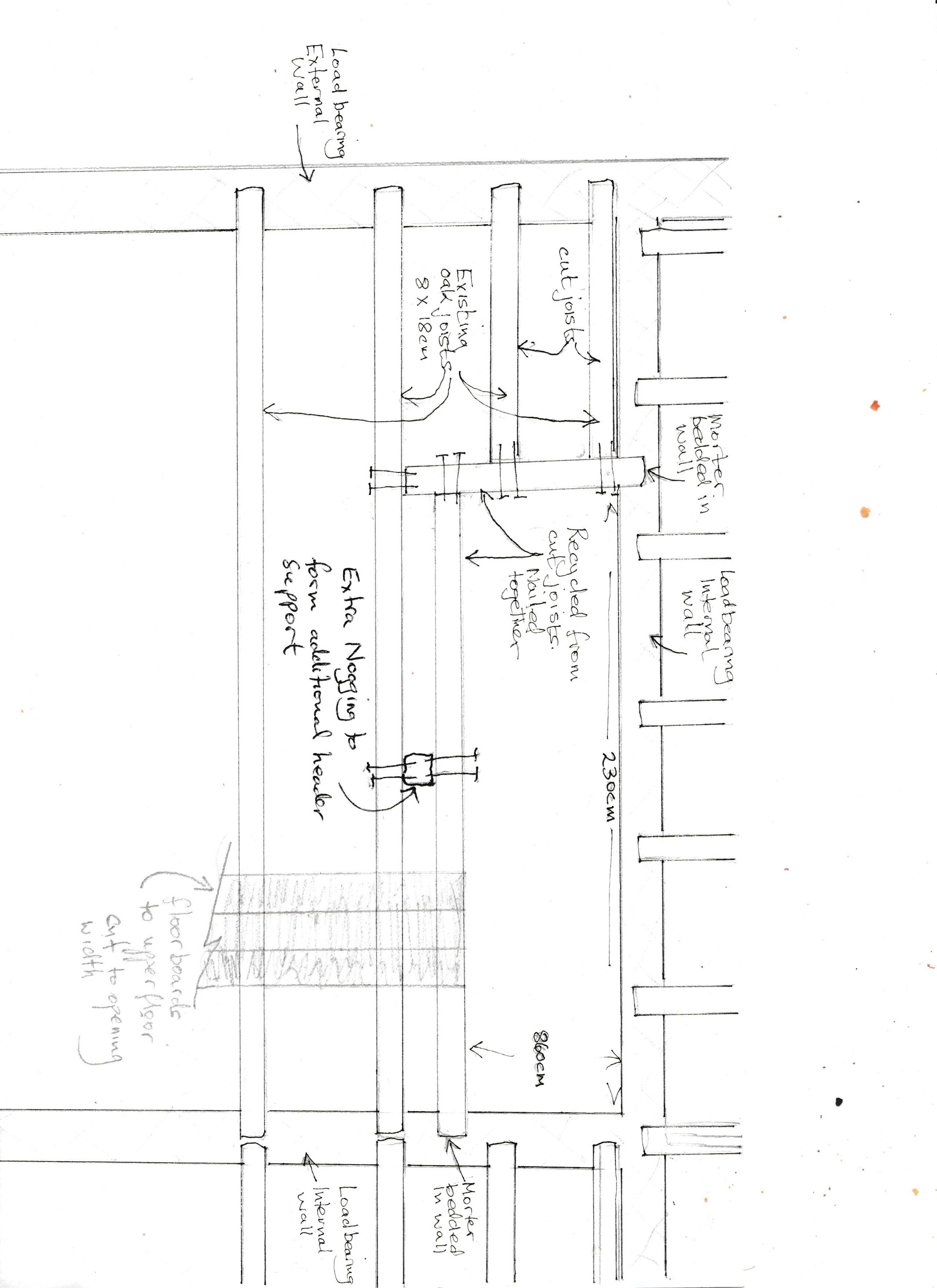

  2. Hello everybody, Here's hoping there is someone who can help with this.... I am converting the loft in my old house that has exposed beam (joists) ceilings. I need to make a stairwell opening. I do not want to use joist hangers or brackets as these will be visible. The joists are 3x8 inch (8x18cm) oak joists in very good condition, no worm or rot at all. The span is 4M and joists are at 52cm. I hope you can see my sketch. My plan is to support and cut back 2 joists to form the opening. To reuse one to form the header and the other the length of the opening, to reduce the opening width. I do not have the space upstairs to have the wider opening to the next full length joist. Please could I have you advice on this plan and will nailing these be adequate? I hope that makes some sort of sense...... thanks for looking.
