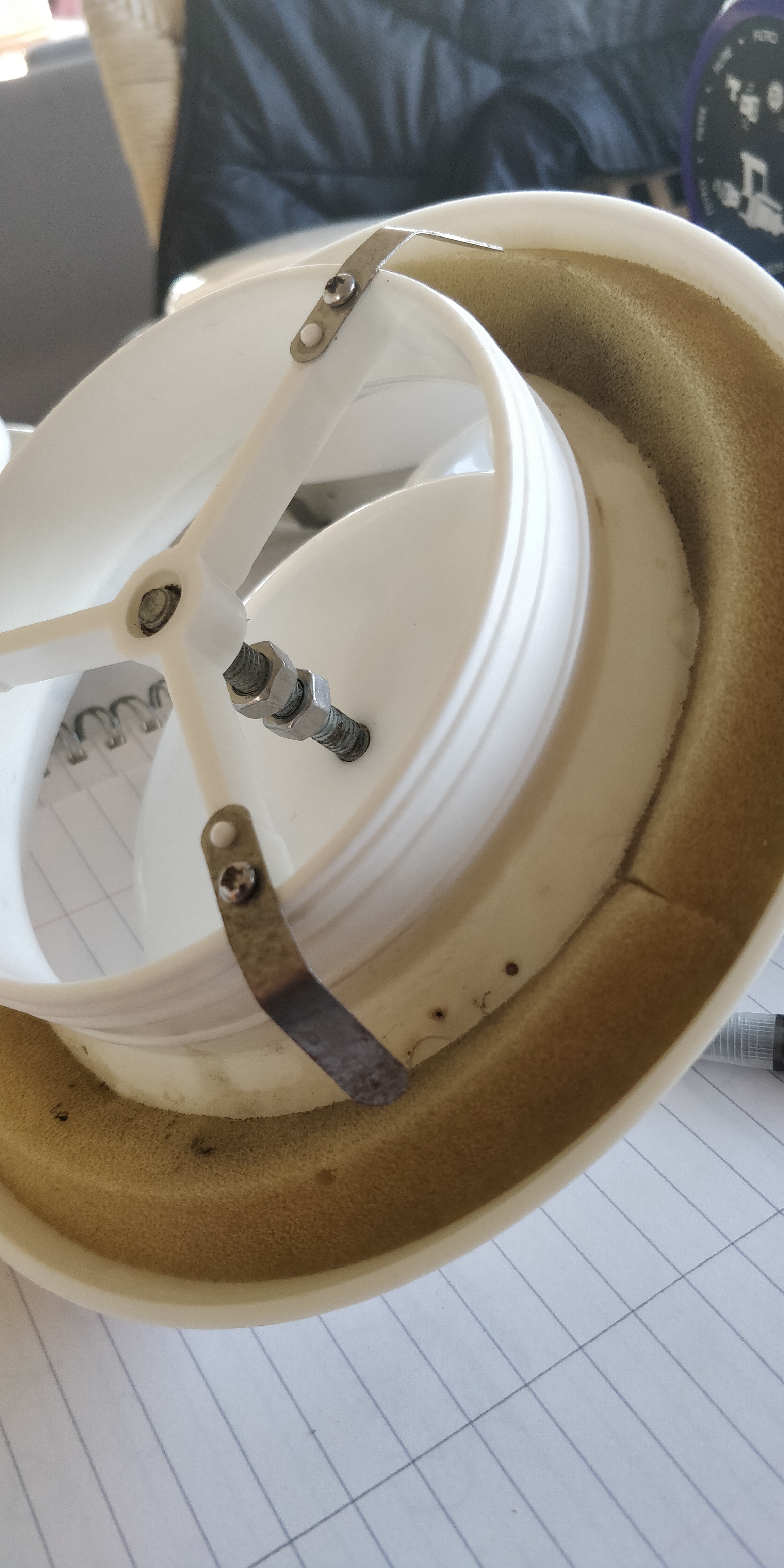

Excellent thanks you mentioned lock nuts made me realise I wasn't sure how they are meant to lock, my vents have nuts but they were not locked, most only had 1 but I have now put 2 on each, how should they be locked? Are they to just stop the vent being wound in too far or should they be locked either side of the threaded bit? -

Regarding terminals being 'fully open' mine are round screw in things with no markings, I have removed all the screw-in bits to clean them. Am I better off starting with the covers off or should I just connect them as far out as they will go, I am not sure if this would make any difference . I hope to complete the balancing by Sunday., wish me luck ;-) I thought I had read somewhere that the required flows for each room e.g. 13ls (45m3) for kitchen could be done on boost and that the normal running could be at a lower rate but I can't find where I read that. From your info I think I need to ensure that the required rates are available on the normal setting and that boost should be higher? Thanks -

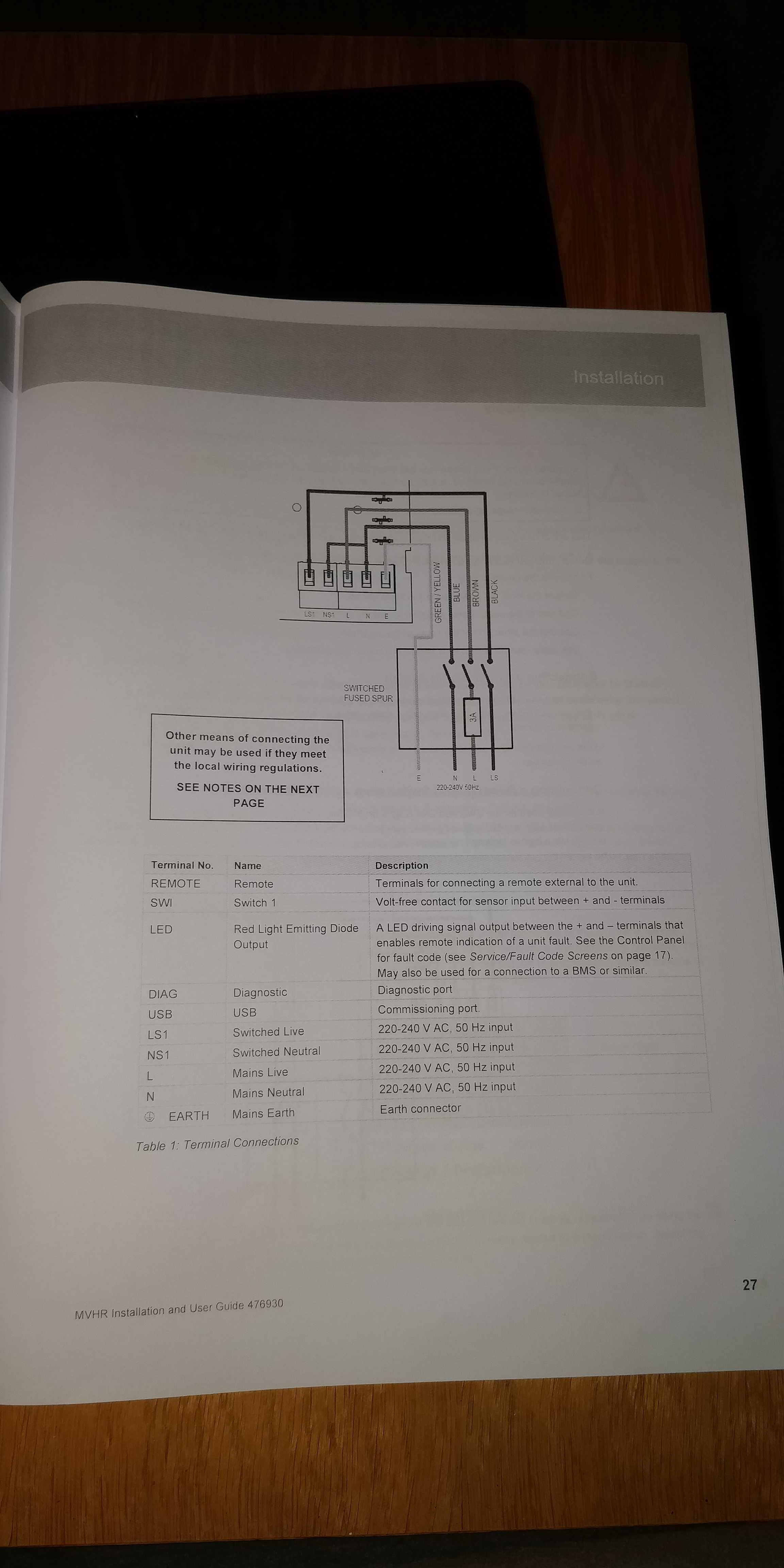

Thanks again Andy, yes I noticed that in the circuit but on the old unit the boost switches were connected to the unit live and the black wire so if any was switched then the black wire was live. There are 7 boost switches and they were wired in parallel to a common point near the unit. I think I will leave the boost wiring for the electrician as I wont be using it initially. The isolation switch will be next to the unit and visible -

Hi Andy Thanks for your reply its very helpful, the other means relates to energising the boost line when not using the MVHS supply to power it. I have added a scan of that page to this comment Yes they do state 3amp fuse is required and I will ensure thats done. Thinking about it a bit more as the boost line is energised from the MVHR supply then a 2 pole isolator to isolate the supply from the CU will also isolate the boost line anyway so I should not need a separate isolator for the boost line? I also found a statement in the 'Warnings and Safety Information section' of the manual that says 'The unit should be provided with a local double pole fused spur fitted with a 3A fuse having contact separation of at least 3mm....' -
I am about to wire my new MVHR, the attached lead is 4 core with L, N and Earth and an additional black cable that if energised (at 240v) will switch on the boast function. The boost wiring is connected to switches outside the wet rooms, these were (in the old system) connected to the live from the unit and if any switch was closed then the black wire with be at 240v and will initiate boost, I wont be using this boost initially want to be able to add it later. What is the correct way of wiring the unit for isolation, the unit wiring diagram looks as though it should be connected to a 3 pole fuse spur but I have not been able to find one (see attached) All wiring will be checked and signed of by a qualified electrician.
