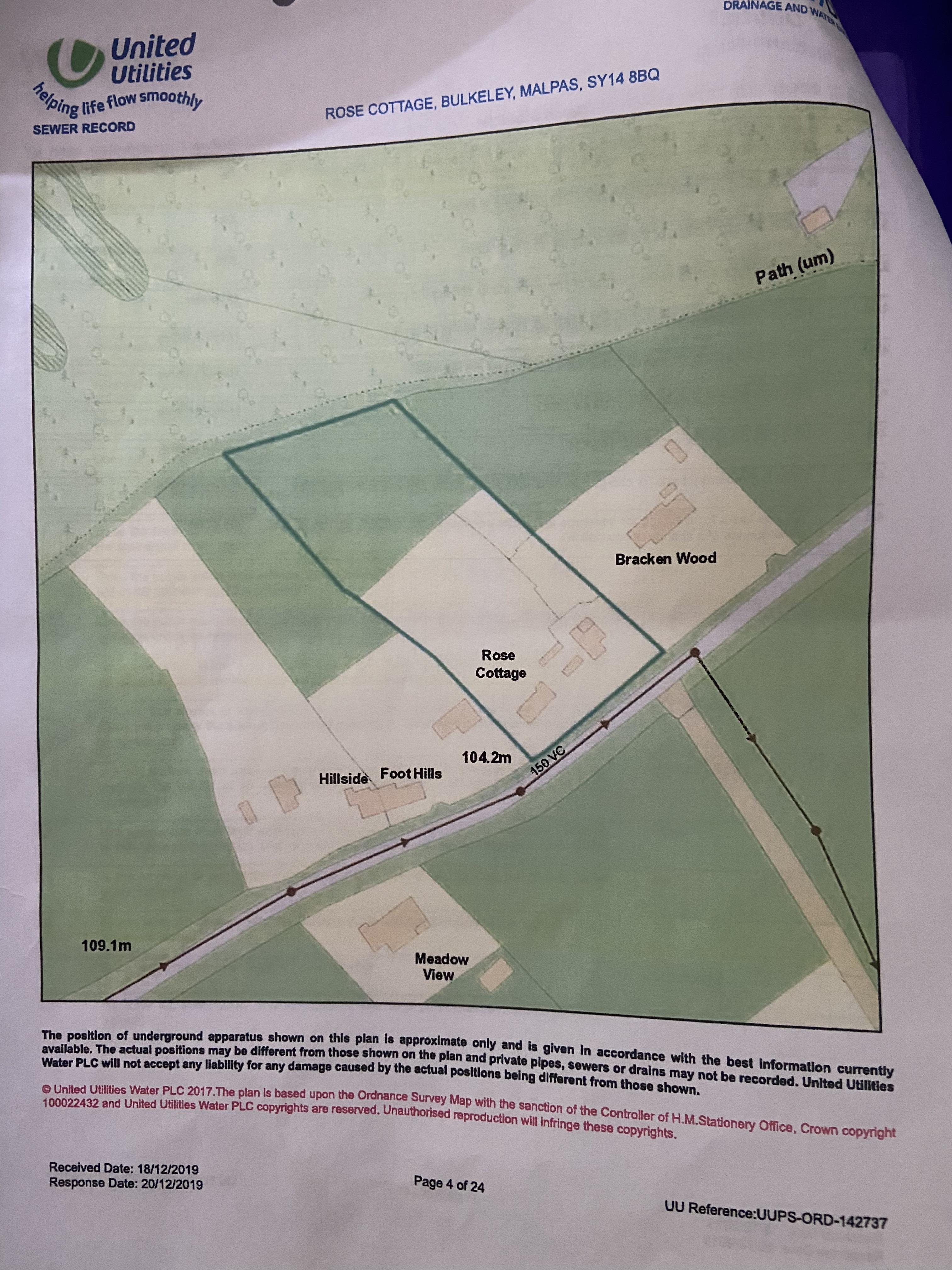

New Member

  1. I'm wondering how much liability sits with the contractor. Surely it's reasonable to expect the contractor would check the connection before allowing you to move in?
  2. Thanks Joe, I'm organising a cctv drain survey. The company (lanes group) are just checking if a permit is required to access the drains on the public road. Fingers crossed I'll have some answers and an economical way ahead next week.
  3. Hi Conor, Thanks for the response. The builder has promised to start digging trenches from Monday. Fall should be fine, as the property sits 1.2m above the road, and the main sewer is over 2 meters below the road surface. Unfortunately this means we'll have to dig quite deep to find the connection... if it exits! Thanks again!
