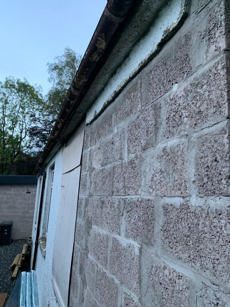

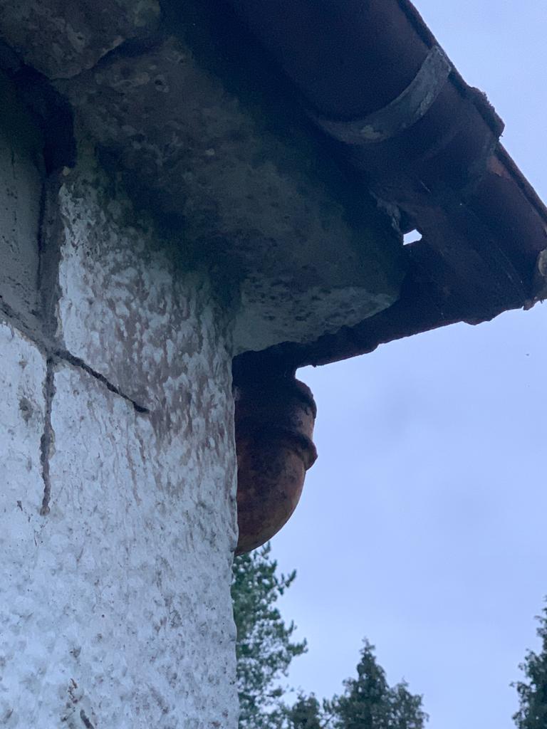

  12. Sloped plot with 1.2m going to 2.0m drop. Too late now but do have a beam and block patio. From organising that I have discovered the following. Beam and block has proven to be very expensive in Scotland. Robslee are making to order with 4 week lead. Much better prices down south, but few suppliers willing to ship. The ones who have quoted have big transport fees. Moving beams are going to be challenging.

  14. I googled bellcast as wasn’t familiar with it. So it looks like the roof would overhang the ring but not sure how this would change the cold bridge, unless the underside of the roof was also insulated. I might have misunderstood. I am adding dormers to the roof so it is planned to be completely replaced. I wondered if I used 150mm eps on the wall then a band of 50mm where the concrete ring is. This would remove any overhang. Obviously less insulation over the concrete ring but I might have to compromise from the perfect arrangement. Although this might mean the roof details need redesigned.
