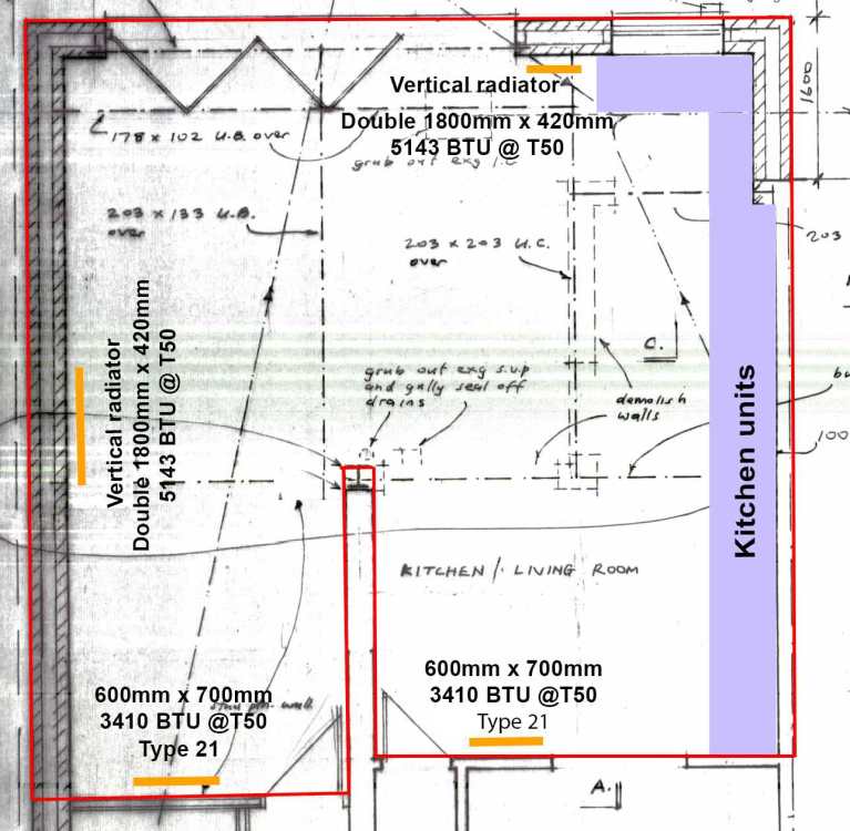

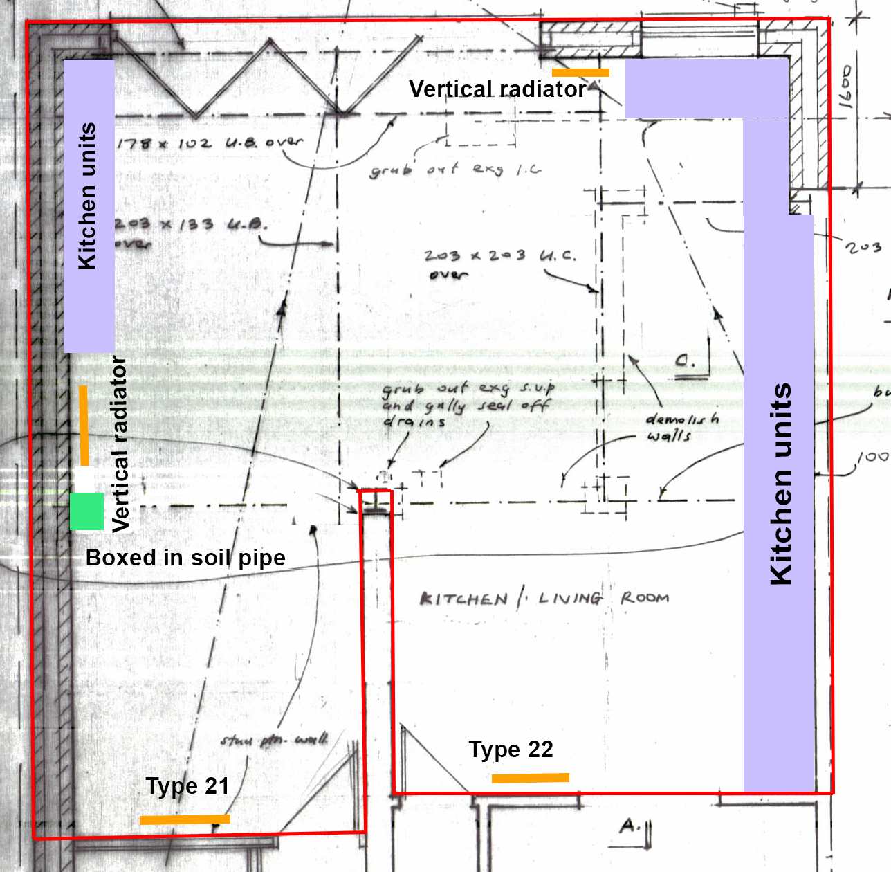

Sorry Nick I should have added the other kitchen units on the drawing, not sure why I missed them out. The reason for the vertical radiators is because of the limited wall space. on the long left wall there is kitchen units and then a boxed in soil pipe so a decent size vertical radiator fits in the space. -

Would you recommend going for type 22 radiators then on the basis can turn them down and they are heating a big open space -

This is all new to me so all the websites that sell radiators have a BTU calculator. I have run the calculator for all rooms to calculate the BTU I need. I have chosen radiators that exceed the BTU given as I could turn down the radiators if needed. I was initially going to get Type 22 radiators but couple of reasons. I seem to have type 21 in all the rooms on the original part of the house. Also I have tried to go for radiators that look in proportion to the wall they are on. With type 22 I would need a much smaller radiator and the BTU output still massively exceeds what the calculator states I need for each room so type 21 sort of fitted the bill. Could get radiator for right size for the wall and it still exceeded the BTU I needed by 10-20%. however I have not ordered them yet so I am open to suggestions if I have got this all completely wrong -

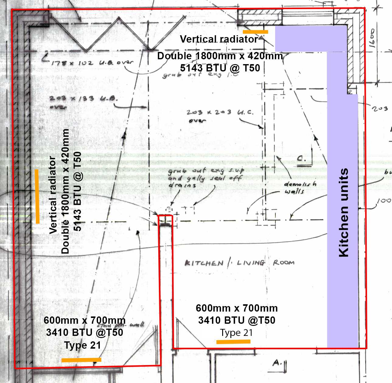

The external walls are cavity walls full filled with Knauf DriTherm 32 150mm Cavity Wall insulation so when using a calculator gives a u value of 0.19 W/m2K. Floor is 100mm Celotex, double glazing and it is a gas combi boiler. The boiler will be running at a flow temp of 60C -
Hi all, I am just in the process of selecting radiators for a quite large kitchen, diner and open plan playroom. The room is 7x7m with a wall in-between but the area is still open as you can see on the plan. We have bifolds measuring 3.6m x 2.19m with double glazing and a double glazed window 1.09m x 1.12m. The suspended timber floor underneath is insulated with 100mm PIR and the rooms above are heated. Would the number of radiators shown on my plan be enough to adequately heat the space? I would really appreciate your comments as we are not having underfloor heating.

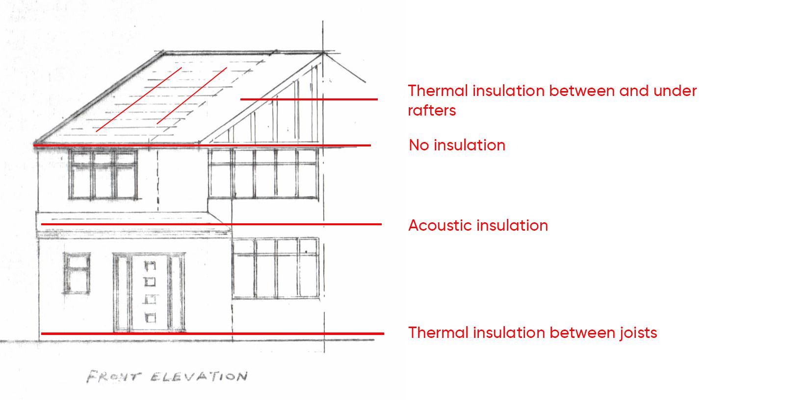

Hi all, I am about to extend my house and plan to insulate it as it seems the ideal time to do it. The ground floor is and the new parts will be suspended timber flooring with quite a void underneath. I plan to insulate between the joists. The loft will be insulated at rafter level so my question is what do I do with the ceiling void on ground floor and first floor. I have heard some people insulate between the floors but from what I read online if the floor on ground level and the rafters of the loft are insulated then you leave the floors. I am not sure what is right to it would be great to see what you guys suggest.

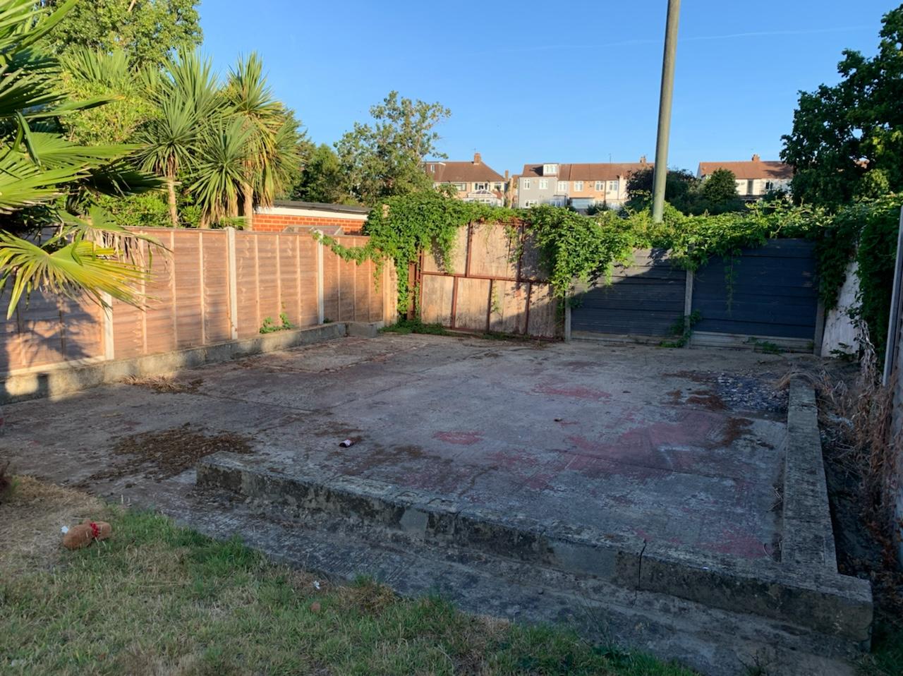

I have a feel that the concrete base in the photo is quite deep as I believe the previous owner used to fix cars and he built two vehicle inspection pits. You can still see them when you stand on the concrete but they have just been filled in now.- 5 replies

Thanks for your reply markc. Thanks for the advice. I definitely don't want any issues at a later date. So what would your advice be regarding the neighbours garden on the right hand side that drops down. Recommend a retaining wall?- 5 replies

I have a large concrete base at the bottom of my garden which is approx 40m2. I would like to build an outbuilding made of bricks at the side and breeze blocks at the front and back. I would also like to build a cavity wall to ensure the building is well insulated. When looking at picture IMG_8756 on the right hand side the neighbours garden drops down significantly as can be seen in IMG_8758. There is a small single wall that has started to lean to one side. How would be the best way to deal with this? Would you recommend removing the single wall that is leaning over and replacing with a retaining wall? I would appreciate any advice. Also happy to provide more details if needed.
