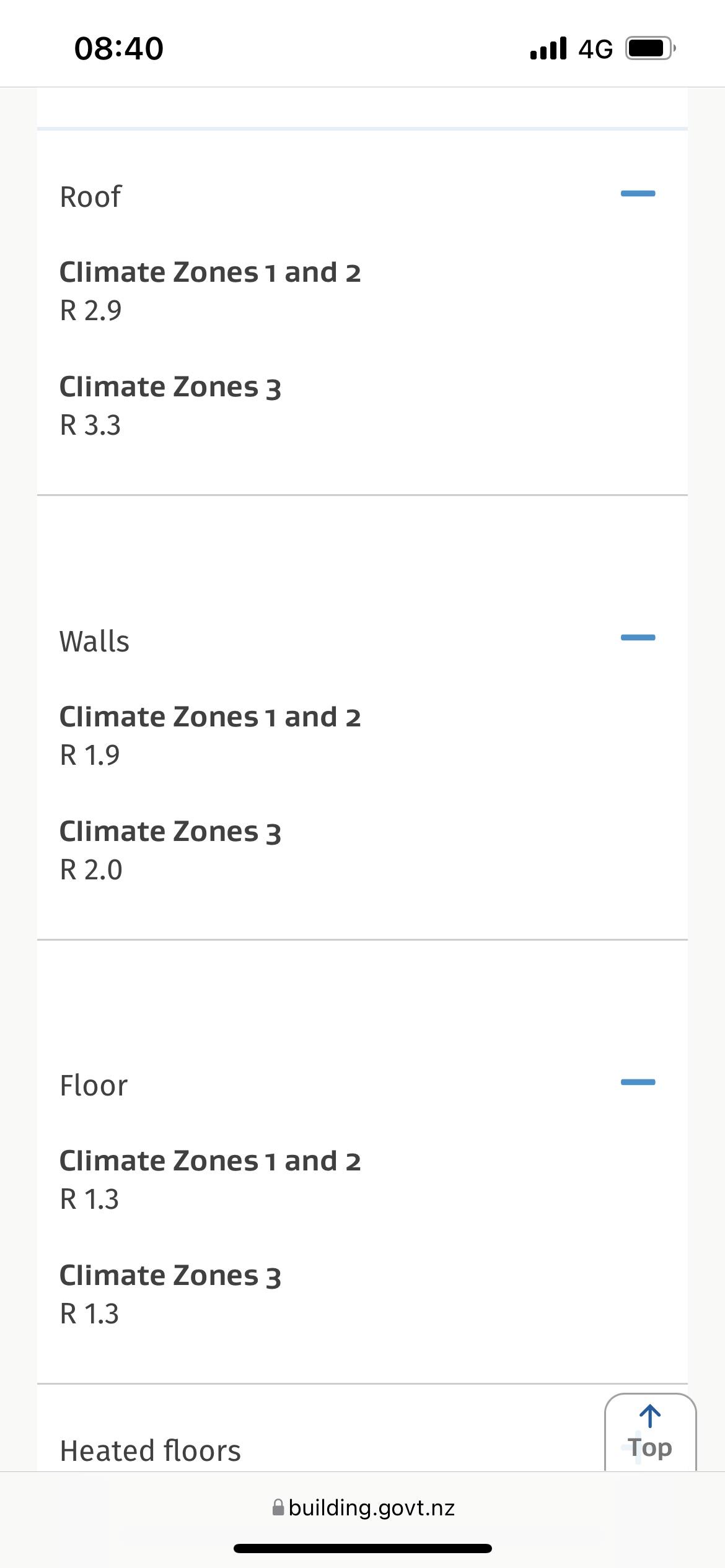

Not keen on them. Dry my eyes out and is hard to explain but it’s never a nice heat as soon as it turns off the room feels instantly cold. it’s not so much that it’s draughty it’s just houses here are poorly insulated. There’s not a whiff of celotex anywhere it’s bog standard polystyrene at best unless you import it. Here’s the building regs as they stand today for insulation I’m in climate zone 3 which is about as cold as it was in south west uk I reckon. Zone 1/2 includes the far north which is similar weather all year to Sydney!. Not much difference in the regs considering. -

Anyone know how well a ashp will work with a large thermal store setup?. I’m a uk gasfitter currently living in New Zealand and about to buy a house and have to fit some central heating. Underfloor is not an option for retrofit so I’m left with rads as the only option. costs per kWh are: LPG 14p Diesel 15p elec 11.75p elec is renewable here mainly hydro and has not risen in cost during the 2 years I’ve been here so hopefully won’t be as inflationary as the others. Diesel has doubled since January and kerosene is dearer than diesel. Nightime temps go as low as -4 daytime is normally sunny 5-15 degrees. Because of the daytime temps I’m looking into fitting a heat pump to charge the thermal store can get 1-2000L tanks. Demand will be roughly 15kw over 10 rads. Insulation is not as good as in the uk and timber frame so no thermal mass apart from the concrete slab but generally these are not insulated. Walls are 100mm timber stuffed with rock wall and ceilings rock wall about 250mm thick. House is 200m2. How will a heatpump work with thermal store effiency wise if I was to run it in the day charging the store then pump around the rads at night and morning. I will need 15kw output for probably 6hrs a day will 2000l heated to 60/70 degrees do this?. I know heat pumps don’t work best at higher temps but looking at the kWh pricing even if it runs at a COP of 1 it’s still cheaper than gas or diesel. We get about 5 days a week of 6/7hr days sun as well in winter so solar is an option although the upfront costs for solar, 2 massive buffer tanks and a vaillant arotherm plus 16kw is going to be £20k plus. Winter is about 4 months long I need about 700kwh a week so about 11,200kwh a year. Looking online 2000L of water heated from 20-70 degrees takes 116kw how do I work out how long the thermal store will supply the rads for I’m guessing I will get roughly 116kw back out obviously at the end it will be pumping 20 degrees water back out so pretty useless at that point.
