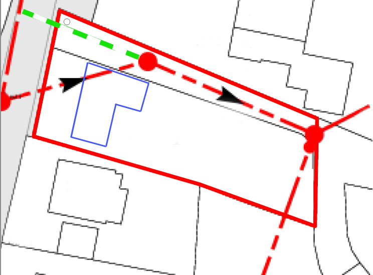

Thanks all. I have got a couple of companies coming back to me with quotes for moving the pipe.
Thanks for everyone's replies. Re the plot itself, the water table is very high and therefore the ground wet, hence needing the deep piles. It is a viable plot though, with houses either side of it. As for changing the shape of the proposed building, I don't want to do that because I need to maximise the financial viability and this shape best achieves that. Also, I don't want to push the house back as it's likely planning will be refused due to both moving off the current build line and affecting next door's light. I have now had confirmation from Thames Water that I do indeed need to divert - they will not sanction a Build Over agreement for a new build. It doesn't seem like a very big diversion is needed though, as per the green dashed line below. The question is what sort of cost this will be.
I've read on here and other places that going down the diversion route should be avoided if possible but from what you're saying it doesn't sound too bad? When you say it looks a little strange and the records may be wrong, in what way are you thinking?

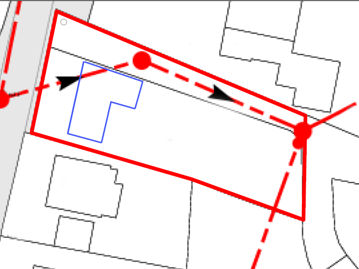

Thanks for your reply, appreciate it. When you say "they don't like you building a new house over the actual line of the sewer unless there is an existing house there already" - are you saying there's a very good chance they would refuse a build over agreement?
Hi all, I am wondering if anyone can offer any help, advice or pointers. I am looking to purchase a plot which has a foul sewer pipe going diagonally across it. In order to make the most of the plot I would like to build over the drain as per the diagram below. There are inspection chambers (the red circles) either side of where I am proposing to build over (proposed house outline in blue), so access should not be an issue. The reason for my post is that even though I know a buiid-over is possible, I am concerned whether it will be more hassle than its worth. Just to add to the situation, due to the water table and soil conditions, piling is going to be needed (down to 18 or 20 metres). So, my main areas of concern are: 1) What are the chances of the water company just just refusing to allow a build over agreement? 2) The pipe being damaged by the piling vibrations 3) The requirements (and additional cost) for calculating, designing and actually installing the piles 4) The negative effect this may have on any potential sale (as it will come out in a survey) I am therefore wondering whether any structural engineers or anyone else who have had to do similar on their projects can offer any any wisdom, advice or any other extra information (either positive or negative!). Many thanks!
