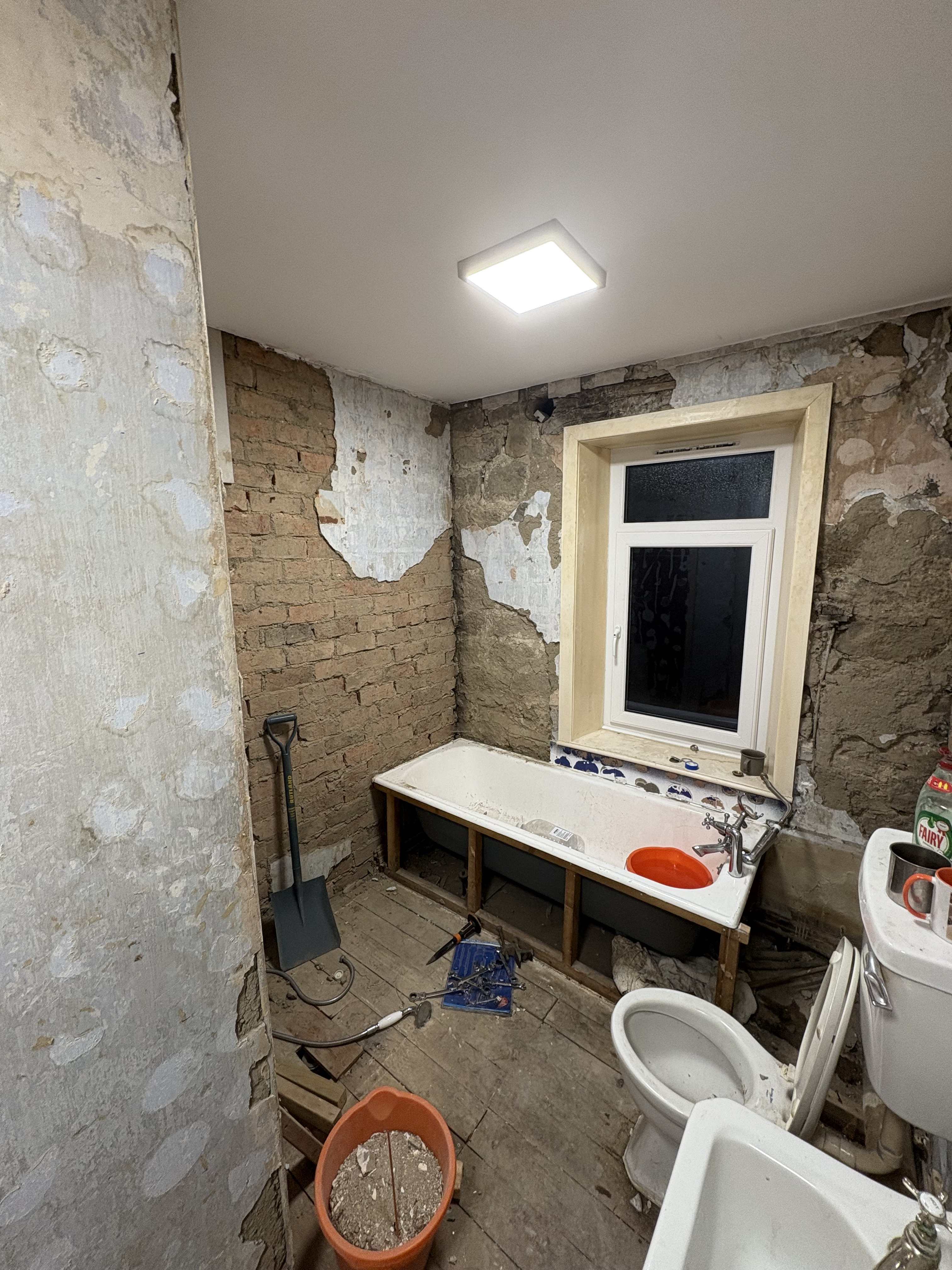

  1. I’ve added some pictures. I am going to remove the bath and go from the bathroom side into the bedroom. The still plastered side is the bedroom I’m going into.

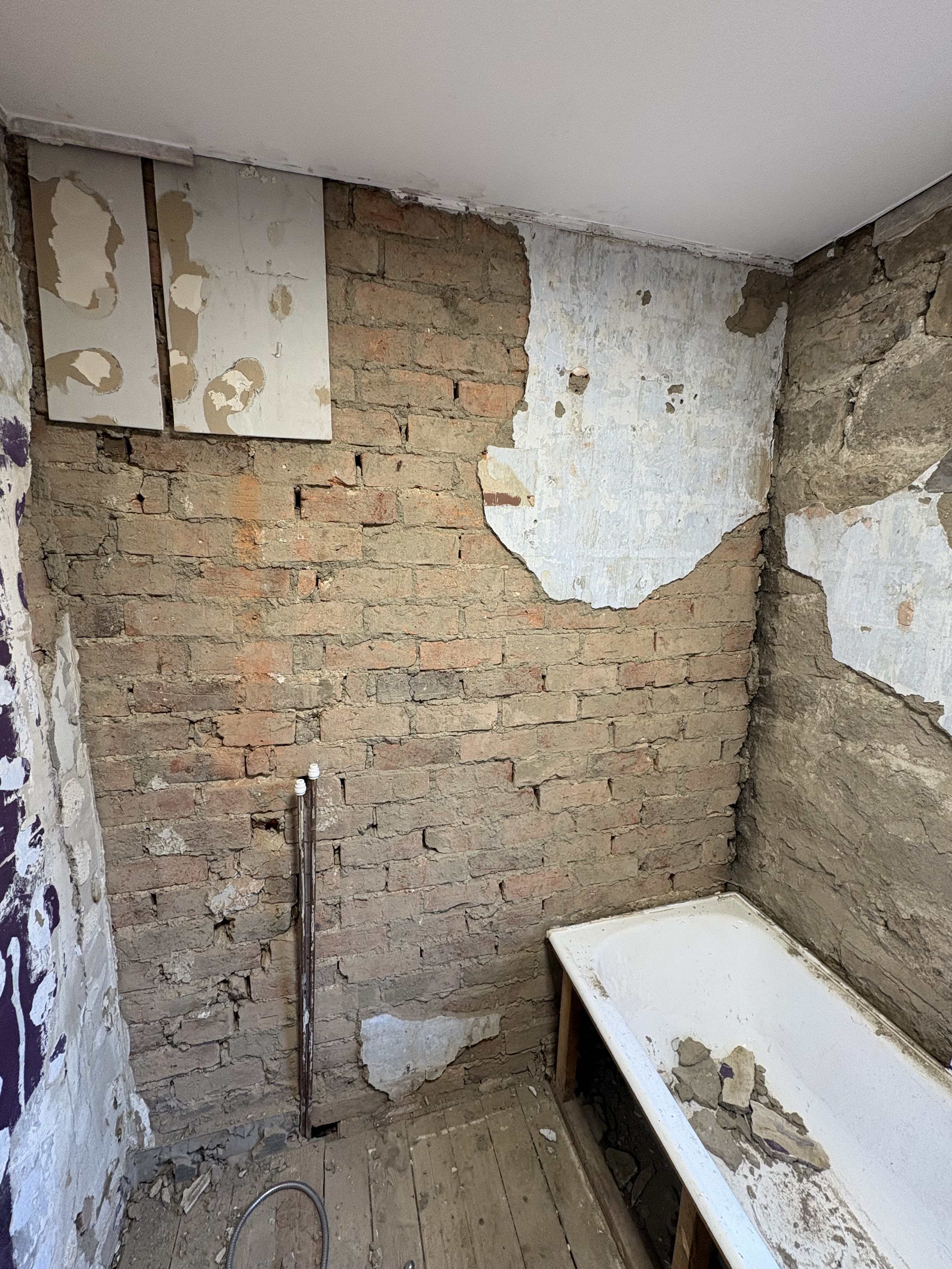

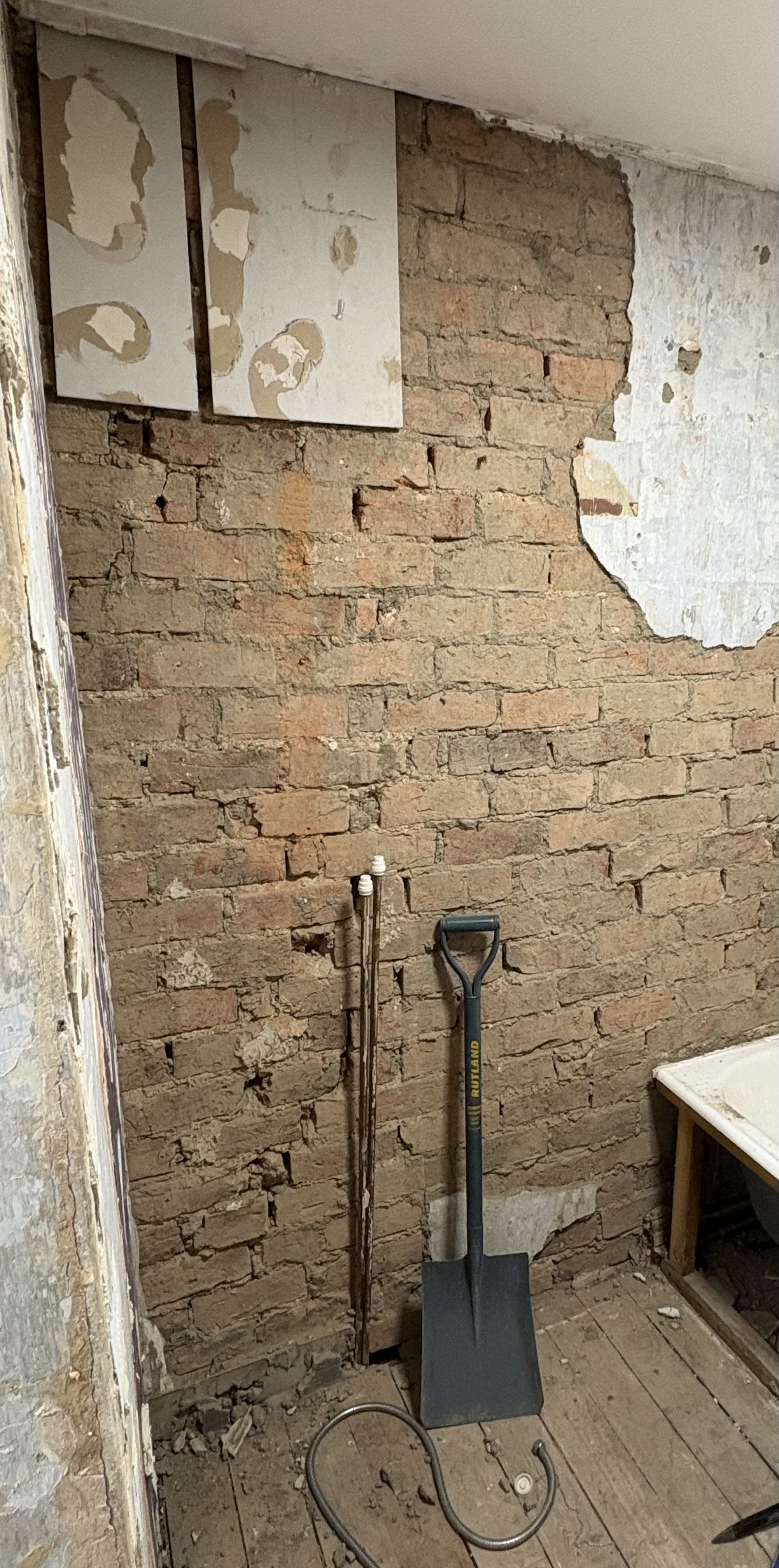

  2. I have removed all the plaster from the bathroom side of the wall as it was all blown. I will be going from bathroom to bedroom side. So i can make my measurements and cut into half a brick and hopefully have it sat nice and neat.
  3. Its of brick construction. Built 1900/10. The brick is the old thick bricks
  4. Apologises, I didn't mean thickness either side. I mean thickness of the lintel itself. I've seen one from jewsons with the measurements of 1200 x 140 x 100mm. Would that be standard spec? https://www.jewson.co.uk/p/supreme-concrete-prestressed-lintel-r15120-1200-x-140-x-100mm-LNBRN155 The DIY one you shared is £18. The Jewson one is £68. Any reason for such a big difference? Thanks.
  5. How thick would you say it needs to be minimum?
  6. Hello, I am going to make a doorway between my bathroom and bedroom, making it ensuite. I've been watching a few videos and reading about how to do it. It seems doable even for a DIYER. This post is looking for any information people can share about making a doorway. Points I've noted down, standard UK doorways are 826mm wide. Anyone go bigger? Lintel above the doorway is extra 100mm either side of the door. Would anyone go bigger? What thickness would be acceptable? Above the wall where the doors going, there is only one beam across it. A builder had a look at it and said there no structural issues/its not supporting anything about it. Any thoughts/information would be much appreciated. Thanks.
