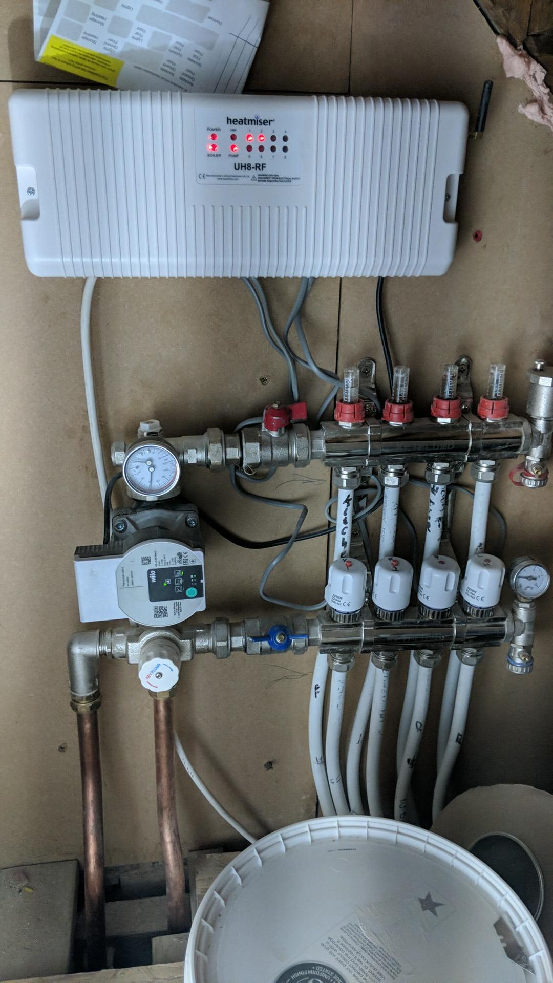

Hey Guys... I have the below setup currently and need your advise if installing weather comp will provide me better way to get the most efficiency out of my oversized boiler. its a long story reg why this big boiler was installed as at the time of install i had no idea about sizes etc and it was all done by the stupid plumber who did he whole thing. Now im just trying to get the most out of the setup i have. Vaillant 637 system boiler with Horizontal unvented tank 210L. - both are in the loft eves. I have Hive system for controlling the Rads and using Heatmiser Neo for the UFH. I have ground floor (kitchen 30 sqm and living room 24sqm) which is running on UFH. 1st floor (3 rooms) + Loft room has Rads installed along with towel rails in the 2 bathrooms. UFH heating works fine no issues on that part apart from the fact that i need to run it at slightly higher temp than i want to (50c at manifold TRV). Boiler flow is set to 65C at present. My issue: 1 - if i run the kitchen UFH alone (its a single zone) - then the boiler hits the desired temp and then goes into the egg timer screen (Anti cycle i believe). and keeps doing this - i assume this is because my boiler is too big 2 - If the kitchen and living room UFH is on together then i dont face the anticycle issue and boiler would be sitting at the target flow temp just going up and down 1c (if i rem correctly). 3 - I have hive TRV's on the 4 rads (in each room) and generally only need to warm up 3 rooms - when running just the rads i get the anticycle mode. From my above issues I know my boiler is too big for my house and for the setup i have, i know i can change the settings to reduce the kw it runs at but im not sure if that's a good way? Would installing Weather Comp would help me in my current situation. Im just trying to get the best out of what i have, or if i can install anything else to make this better. I had the boiler serviced recently and during that visit i asked the engineer if he thought my system was not setup correctly and i asked if the boiler was too big >> his response was "everything is running as it should and its good to have a bigger boiler" >>so i didnt even bother asking about weather comp to him. Hence i've come here as there are a lot of you guys who seems to know hell a lot more than some of the pros. Happy to provide more info, if i have missed anything.
I have a system boiler with 4 port manifold and I have two zones, kitchen is Tiles and living room is LVT and i find that when the UFH is On in the kitchen the boiler cant get rid off the heat quickly and would go into the anticycle mode often, so it would reach the target temp of 60c and then id get the egg timer while the pump is running. However i noticed that when both zones are on the boiler is happy to be at around 60c constant while the UFH is on and return temp at about 54c (i believe the ideal condensing temp). Also if one zone + Some rads are running the boiler doesn't go into anticycle mode.
Like you i had a similar setup with the Manifold Temp set to 55C and the boiler set to 70c (15c difference) and pump speed to 2, this setup worked well with my kitchen and living room heating up in good time. However as i have LVT in my living room i think at 55c on the manifold the floor was getting too hot so recently i have reduced the temp down to 45c and the flow on the boiler 65, changed the pump speed from 2 to 3 so i get better flow in the loops. I have been using this for the past week and seems to be stable. I think once the temp drop to 0c or lower the time it takes to heat may take longer if you are running the UFH all day.... i would say keep 10/15c difference between the temp on the manifold and boiler... or as someone pointed out above the Salus actuators could be a option too...im thinking to get them so the flow and return temp are controlled automatically.

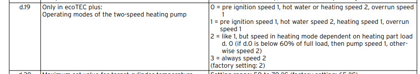

i found this in the Boiler install manual today, this is for the pump inside the boiler. I can get a gas safe guy to confirm this but would changing the setting from default would help push the water around faster from the boiler to the manifold? since the boiler is in the loft and manifold is on the ground floor im wondering the return flow to the boiler is slow?

Thanks PeterW, good to know regarding the TRV...so i assume leaving it on 55c which is what its currently set to is ok for the floor type i have if i do opt to get the Salus actuators. Just another Q would i need to adjust the Flow Temperature on the boiler at all which is currently set to 65c? On your Q regarding the Zone Valves yes there are 3 under the boiler:>> Hot Water Tank, UFH and Radiators (heating). Sorry but what do you mean by "Ideally you need the UFH flow setting to be higher than the boiler " are you suggesting the Flow gauges on top of the manifold to be fully open?
