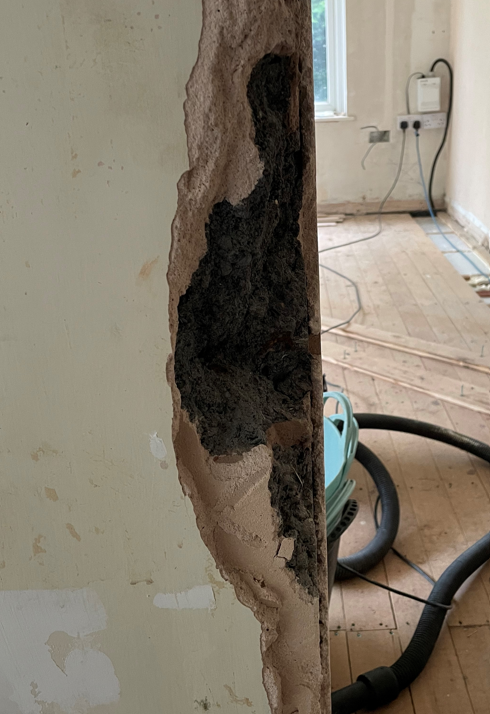

  1. Nice one, thanks. What ratio mortar mix is recommended?

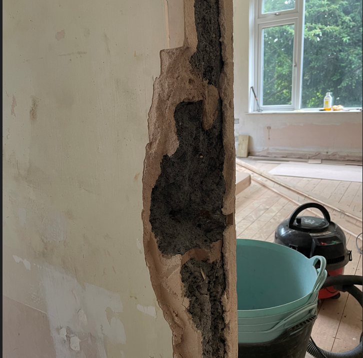

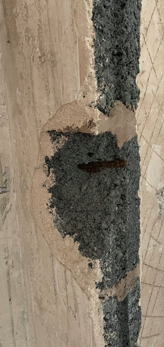

  2. Hi all, I'm replacing some door linings in a 1960s property which is mainly made up of clinker blocks, some of which are quite brittle. When I removed a door lining (held in place by cut nails) a big chunk of one of the blocks came away with it (lesson learnt!). I have some questions on how best to put this right: 1) What is the best way to repair this? 2) Should it be patched up before or after the new door linings go in? Doorlinings will be fit by a professional chippy. 3) Can it be filled with bonding when it gets re-plastered? Thanks! (pics attached)
