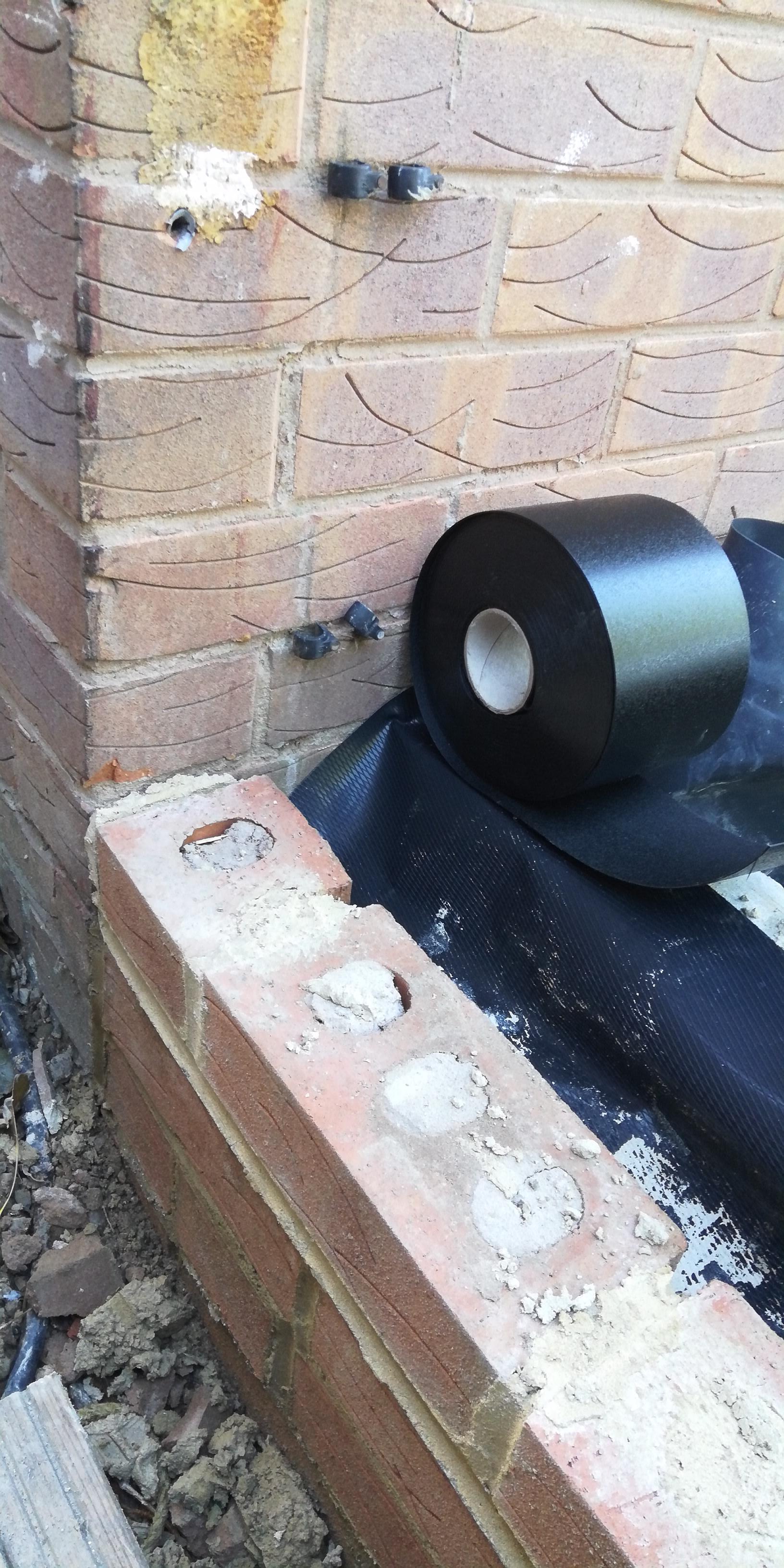

  3. Thanks again. How deep a slot vertically? Do I need to go thru to the cavity or just 40mm ish? Do I need to wedge dpc in the virtical slot? How often should I position weep holes above the tray? Cheers

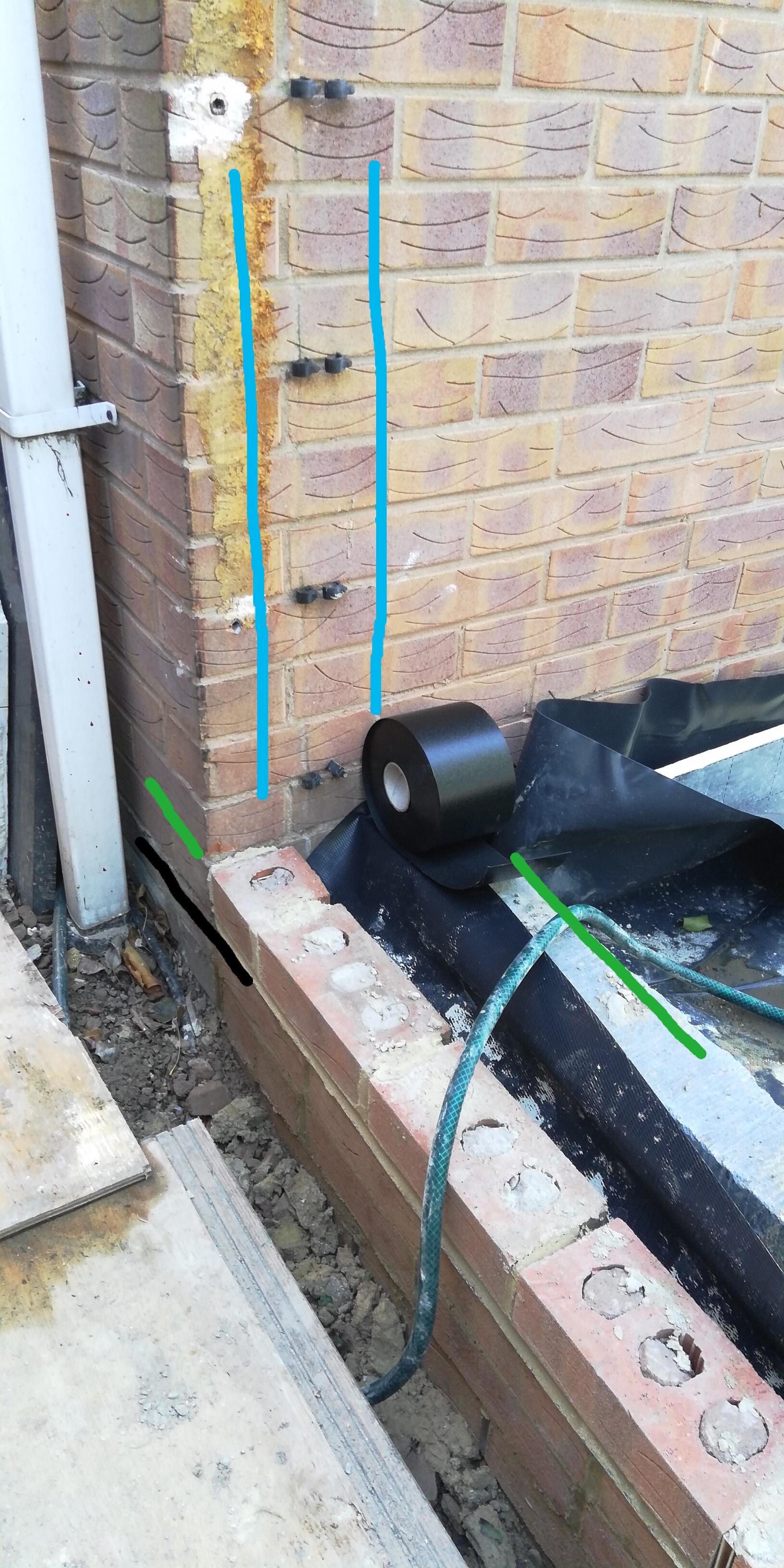

  4. Finished floor level of house and therefore extension is green line and dpc on house is black line. Stainless crocodile wall starter will obviously be where blue lines are roughly. How do I overlap into house dpc? Do I carefully cut the mortar joint exposing some of the house dpc, do I additionally apply some sort of sealent? How do I cut vertical barrier, how deep etc and overlap it with the horizontal dpcs below it? Many thanks in advance.
  5. So far thank you I will take photos and do a sketch tomorrow. ?
