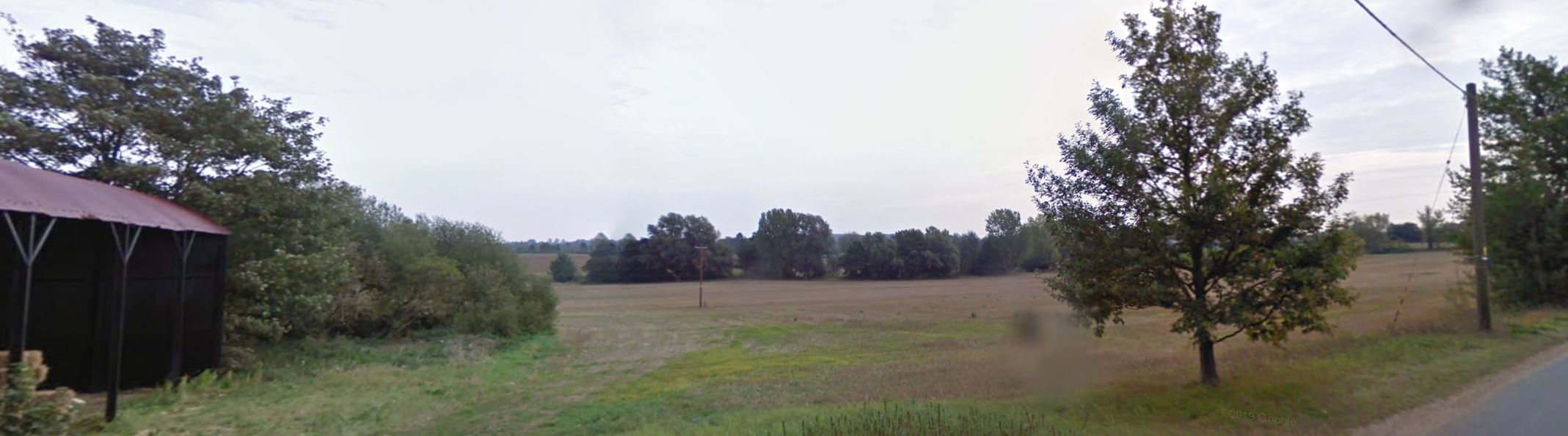

Yes, architect and planners didn't object ! No doubt he was after a design award or something but with little thought as to how someone would live there afterwards ! Yes, an entirely new steel frame being built over the same footprint, with new slab and/or deeper pads as needed. The old stanchions need to be retained apparently, but will be bolted to the new frame and hidden. They will not be load bearing. -
Wow !..........so much to learn and so little time !
Canoehq replied to Canoehq's topic in Introduce Yourself
There is no slab. Just a dirt floor with the current stanchions on shallow concrete pads. -
