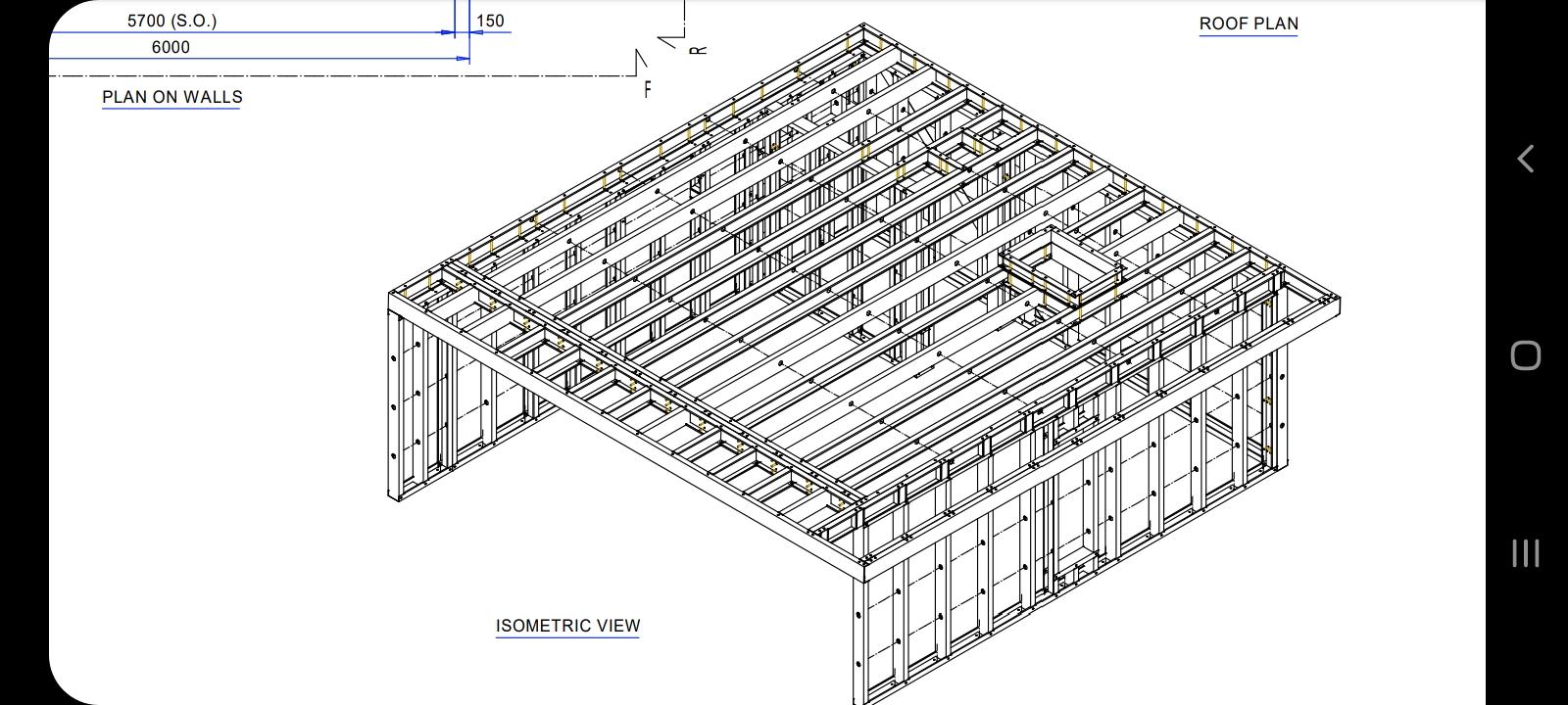

  1. Hello! I am going to build a steel frame garden room (light guage steel) of size 6m x6m, with slimline sliding doors spanning the whole width of the front wall. There is essentially no steel on the front wall apart from where the side walls (150mm studs) come up to the doorline and past it on the left side for the 750mm overhang. I wanted to achieve that true floor to ceiling look with the sliding doors so opted to have no lintel underneath the roof joists where the sliding doors will sit. I'm now worried that this will lead to a compromise in the structure either from day 1 or some point down the road. I have attached an image of the structure I am looking to build which will hopefully make what I'm saying make sense. Any advice would be greatly appreciated!
