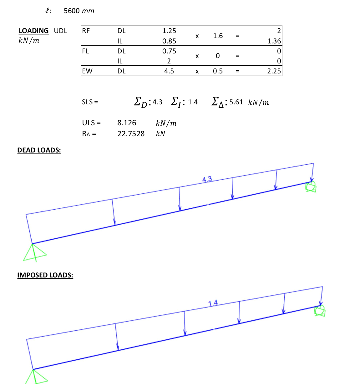

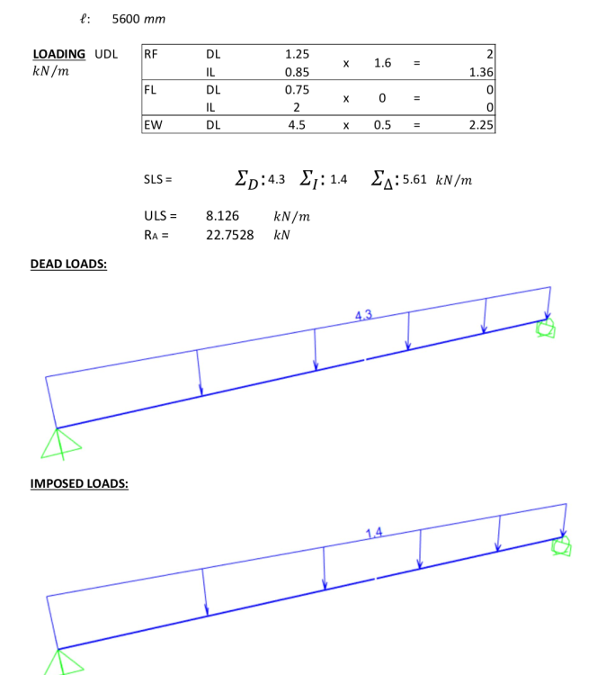

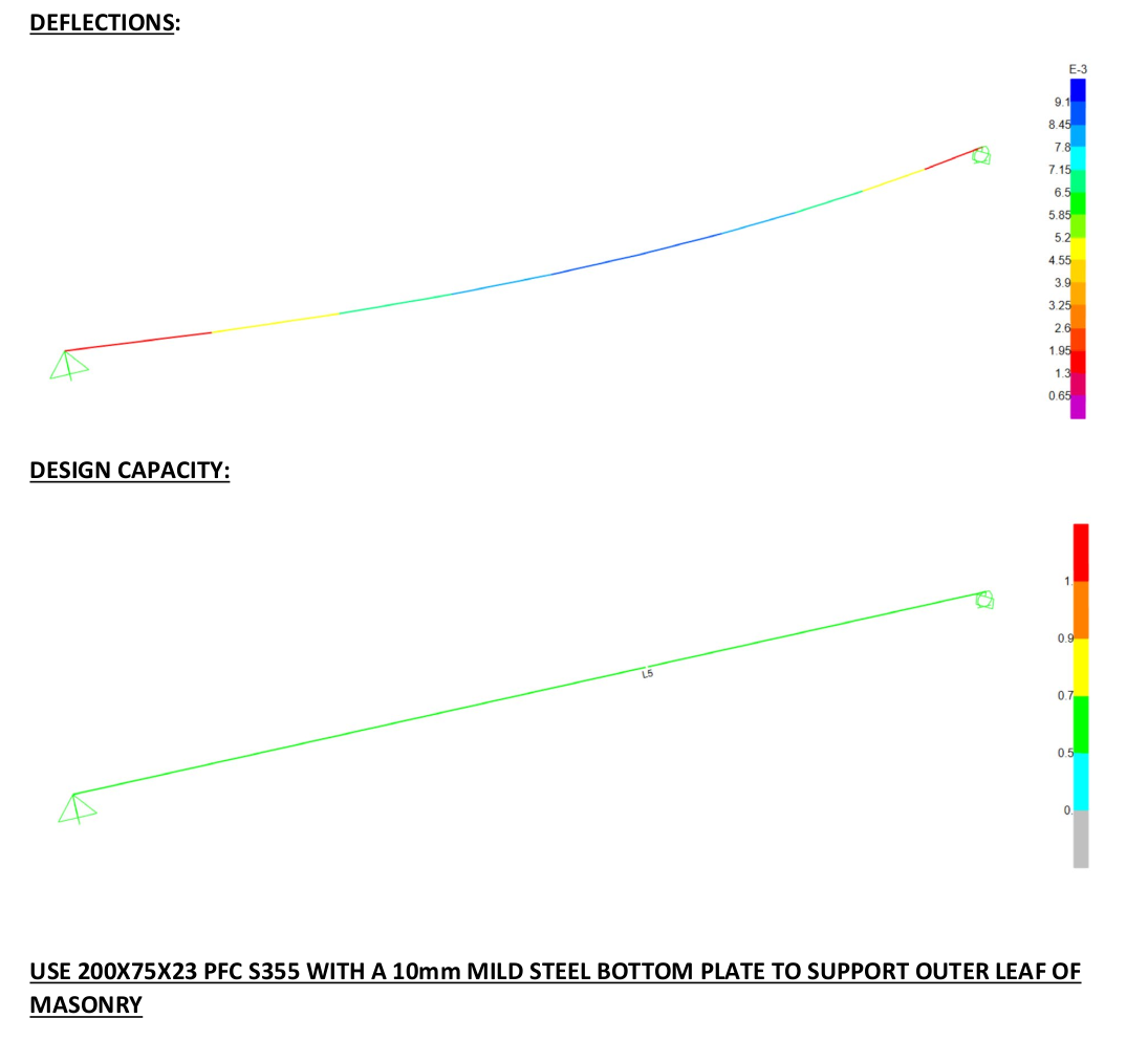

It's a 200mm cavity (400mm total wall width), so I guess I best query that. Sliding doors rather than bifolds, I've attached the relevant bits of the calculations. Thanks - I best raise this with the architect then to ensure we have the space to add this detail.
Hi Folks We have a few large spans (5m) and my SE has specified steel lintels resting on the inner block leaf with a 10mm bottom plate spanning the 200mm cavity to the outer brick leaf. I raised this with my architect as I'm concerned about it being a cold bridge and his reply was that it was standard detail and unavoidable. Is this the case? I appreciate this is a large span and we might well be stuck without another option but I also think they're fed up with me querying everything so might just be fobbing me off 😳 On the smaller spans such as windows, the SE has detailed catnic thermally broken lintels. Before we sign off, is this the best option here? I've seen some threads talking about using prestressed concrete instead as it's much cheaper but I'm not entirely sure how that would work... would there also be a steel on the inner leaf and they're just not connected? If so, what's the general method of closing the cavity? Thanks!

Thanks all, I'll query this with our SE.
