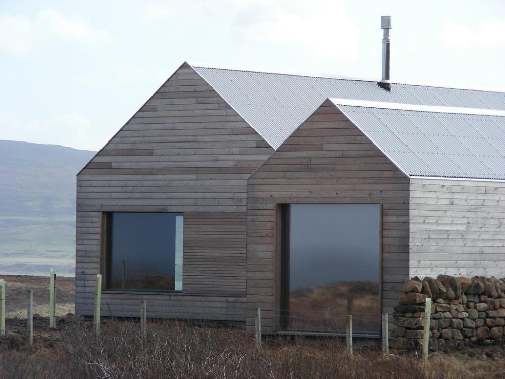

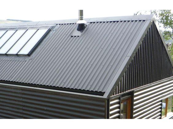

  1. We've finally settled on our roof finish and have decided that a corrugated roof is right for us, it suits our agricultural location and we like the simplicity of the design. I am now trying to refine the detailing however I am struggling to find slim, neat trims for the edges of the corrugated metal sheets. I'm trying to avoid large barge boards/trims (as shown in image with black roof) and instead would like slender profiles as used by Dualchas. I am thinking of using a dry verge product by Kytun, usually used for slate tiles, in black to match the corrugated roof -http://www.kytun.com/p/slate-dry-verge-t2-aluminium-pack-of-4/p-c02 Does this sound feasible or are there more suitable products available? Any help would be much appreciated!

  3. Hi All, Very interesting reading your thoughts on corrugated sheeting profiles. We are also influenced by the Dualchas designs and would like to proceed with a corrugated finish on our build. I have looked into Marley Eternit products but would prefer a metal profile (in black) which is suitable for a residential project and has longevity. Does anyone have any supplier recommendations?
