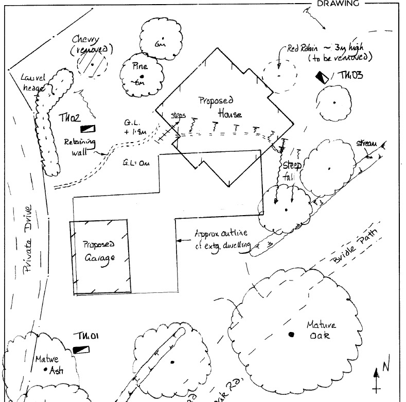

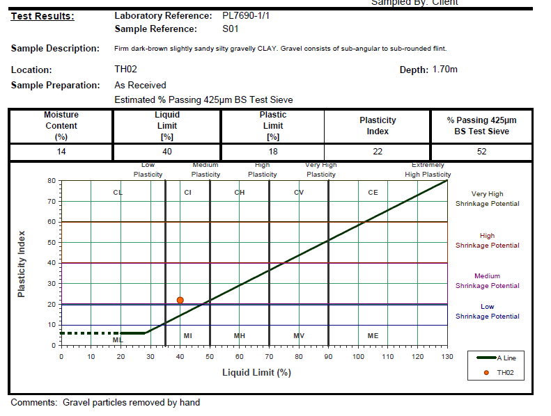

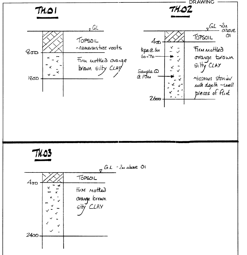

  2. Hi all, We have our planning app in with the local authority at the moment, we are working with a timber frame co. to provide a design and build wind and watertight package. They don't offer a groundworks/civils package so we are looking at establishing requirements, with a view to appointing a structural/civil engineer shortly. We have a soil report already and the ground conditions are determined as firm silty clay, med shrinkibility. Bit of detail on the site (see topo detail & proposed dwelling/garage attached)and what we'll need to incorporate into the design: Foundations & B&B Ground Floor - TF co. will provide structural loadings once they've completed the design & BRs. post planning approval. Site is pretty flat so I'd hope foundations should be fairly standard in nature (multiple fingers crossed!). Storm Drainage - We are off grid, our existing bungalow discharges rainwater directly into a small stream that runs along the front of our land within our curtilidge or onto the driveway or surrounding garden, all very Heath Robinson! Foul drainage - Again, we are off grid, the existing bungalow has a cess pit that requires replacement. We are looking at a sewage treatment plant solution, general consensus seems to be something with minimal moving parts, an air blower type (Bio Pure, Condor, etc). Our understanding is we will need to get EA sign-off to discharge the treated water into the stream for this solution. Need to consider placement of the unit so that it is far enough away from the house. SUDS/Soakaways/Rainwater harvesting - Given we currently discharge rainwater directly into the stream and it's unlikely we'd get permission to continue doing so, we potentially need to look at viability of soakaways (given clay soil), SUDS or rainwater harvesting solutions to offer betterment, we'll need some advice here. So a fair amount that we need to package up, design and get the relevant permissions and approvals. Does anyone have a view on how best to go about approaching this and could anyone recommend a civil/structural engineer that could assist us with it? Is there anything I've missed above that we need to consider and design in? We are based in Hertfordshire, is someone local necessary given we already have a soil report or would you suggest local knowledge of soil conditions be significantly beneficial? Any help much appreciated.

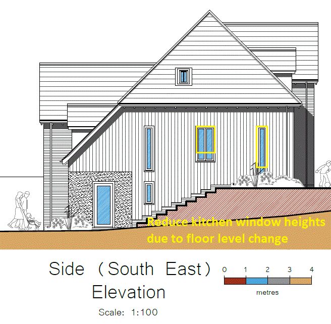

  5. Hi again all, it's been a good few weeks and we've been through a few iterations since I last posted and I feel like we're pretty much there and have landed on a design and configuration that we're really happy with. A summary of the changes we've made: - Tidied up the windows to make them more consistent across all elevations - Switched out the kitchen slider for a large picture window (this elevation benefits from the best views to the rear garden) - Increased the downstairs hall space to remove the pinch point at the bottom of the stairs - Reconfigured the master suite walk-in wardrobe and access to bathroom - Reconfigured the utility/plant room to improve the amount of units that can be housed - Increased canopy size so it now covers the front door porch (this isn't obvious from the drawings) - Shaved c400mm from the back of the house as those rooms could accomodate it - Added solar to the standing seam roof (this is an area we are now looking at in terms of viability and whether we will need to install Solar PV to meet the revised SAP calcs under new BRs) - Updated material finiahes: Roof & East elevation - Standing Seam; Main house - Brick; Pop-out extensions - vertical larch/thermopine; Canopy - render - Various tweaks to window placements to even up elevations I think that just about covers it. We'll be looking to submit to planning shortly, just drafting the other supporting documents on materials, design and access. Interested to know peoples thoughts on the (almost) final design:

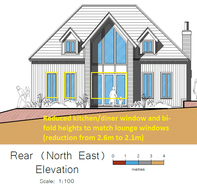

  7. Thanks Ferdinand - Wow, that veranda sounds huge! If you did things all again what would you do differently? Reduce number/size of windows, modified glazing? Or a combination of all/most of the solutions you mentioned above?

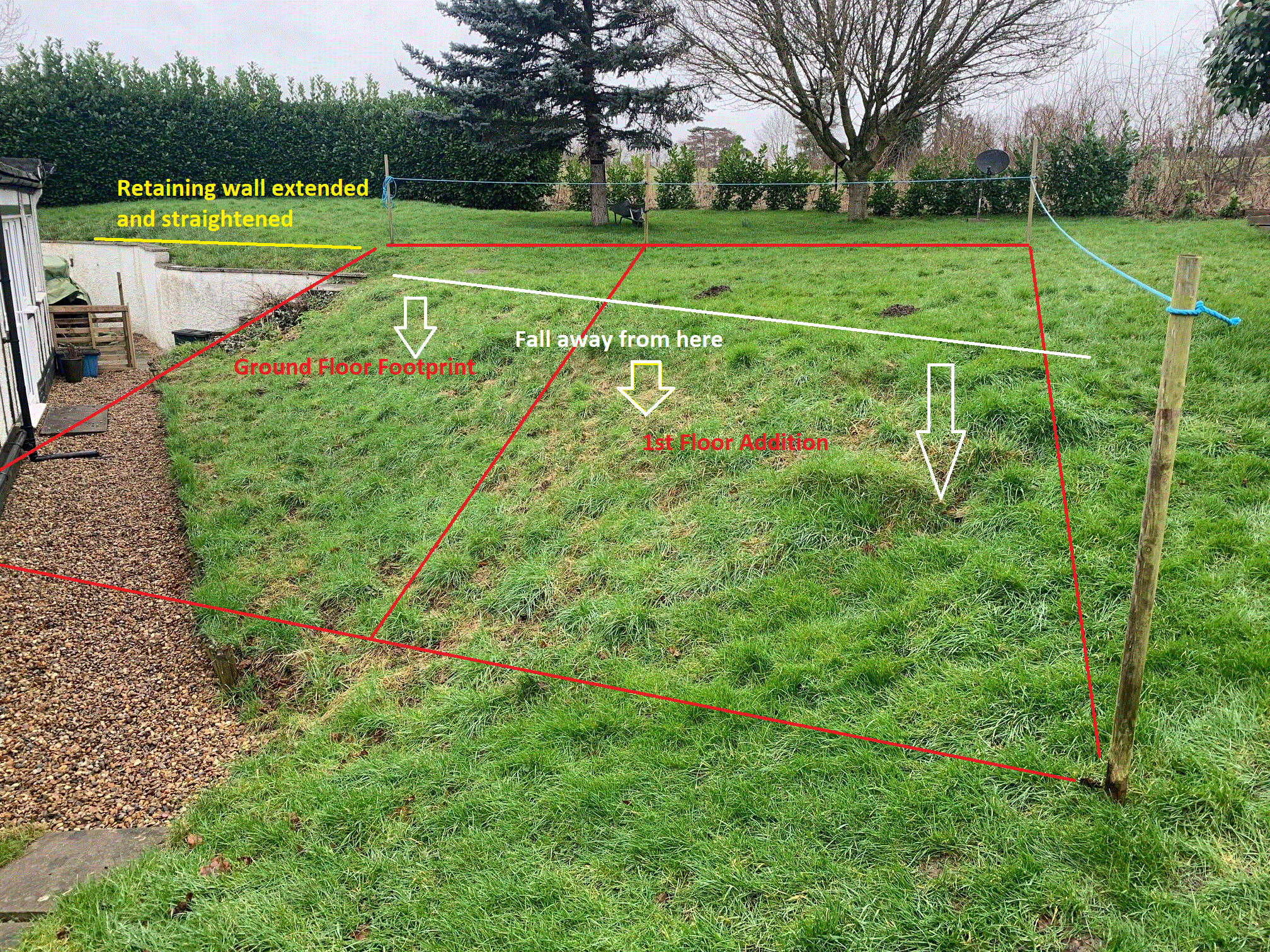

  18. Thanks Conor. A whole new app or an amendment to existing, or is it only the planners who can advise on this really? Will do, as we have a slopping site I think we could lose a fair bit here by levelling that out but it could need some retaining walls (sleepers maybe) to help with this, I'll investigate if there are any other local options. The top soil we'll certainly use it's whether we can find a home for the silty clay underneath.

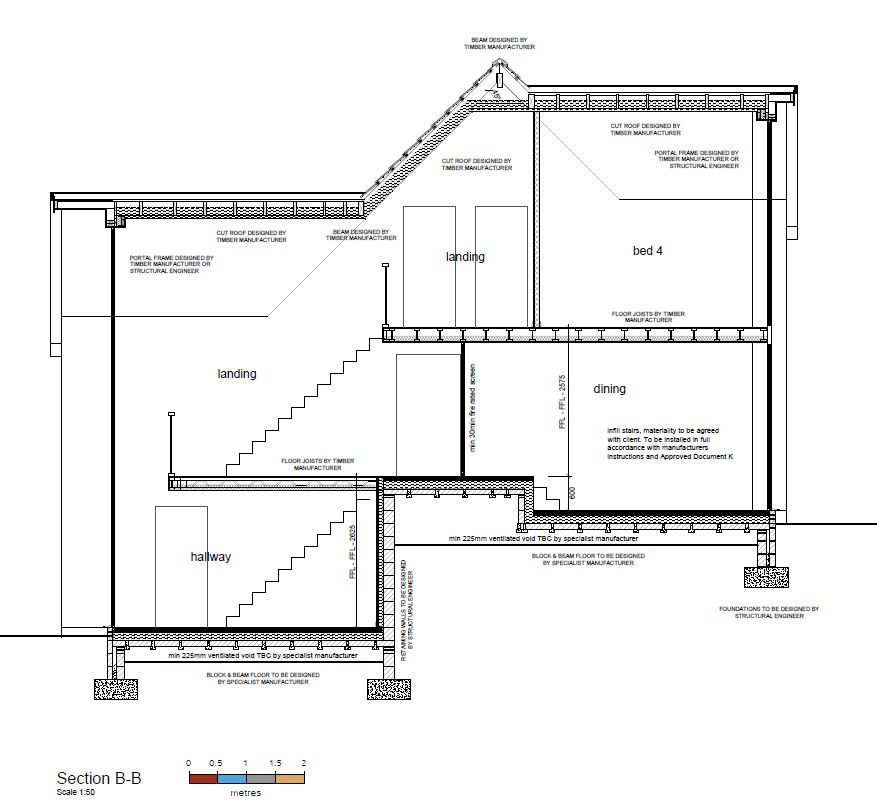

  19. Thanks for the responses guys, pushing the retaining wall back does make sense, additional costs, yes, but these would be balanced by the simplification it brings and the increase in square m on the ground floor, cinema room, gym, plant room are options here (budget won't stretch to the former two, but can leave unfinished with that as an option in the future). Plant room in here also frees up space in the utility which was doubling as our plant room. We do have a large garden where we could lose some of the soil by landscaping and we will need to backfill the SE side elevation so we can reduce muckaway cost here. A level change in the kitchen/diner would remove the need for steps/handrails and will reduce the height of the bifolds and windows, both will bring costs savings (not huge, but savings nonetheless!). First floor can then have all timber joists throughout instead of mixed timber/concrete, whether this saves cost I'm not sure but certainly looks simpler from a design/build perspective. The next logical question here is the impact on our planning permission, I would hope the change in window/bi-fold sizes would be classed a non-material amendment, but building out the basement and increasing the sq m on the ground floor and adding access to the basement rooms from the hall/bedroom 1, would that require a new planning app? Fundamentally the super-structure remains as is in size and form so I would hope the planners would be sympathetic to that, but who knows with the planners, all a bit of a lottery. Here's what we have approved at present with my amendment overlays in yellow as I see them: Any views on planning implications? I can stick a post on the planning forum to garner opinion before I have an initial chat with architect, just conscious of starting too many concurrent threads!

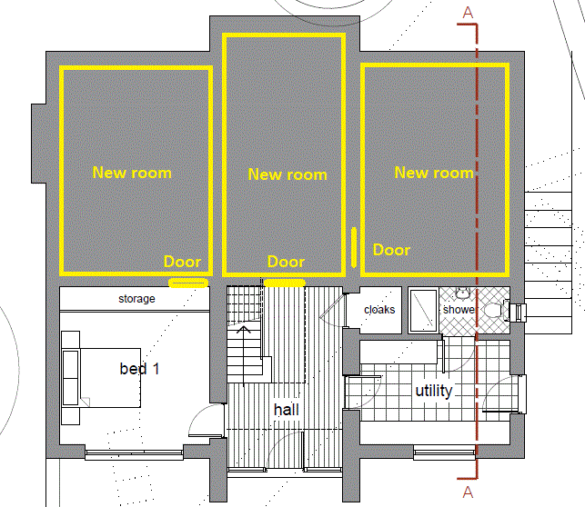

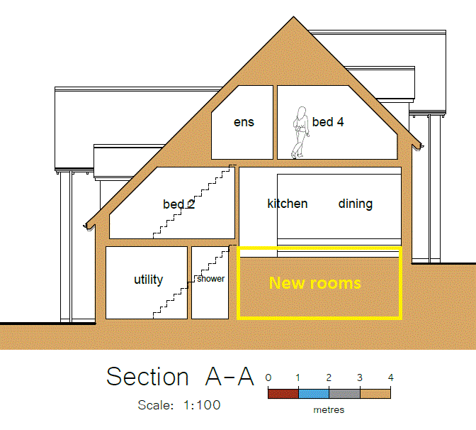

  20. Hi Bitpipe, Yes, we did get a topo survey done and this was passed to our architect. This is what I was afraid of, even to my untrained eye it looks complicated. We have discussed extending the basement as an option, just need to consider additional costs of muckaway, retaining walls and slab as we're doubling the size of it if we go down this route. The step down was to increase head height in the kitchen/diner, I don't feel foregoing this would be a huge issue, the 1st floor would all then be on the same level with a ceiling height throughout of 2575mm which I think would be workable. This is what MBC suggested as the way to go when I spoke with them, it would mean a passageway around the basement level and bridges to access the garden from the 1st floor, we're getting into fairly significant redesign territory here I fear!

  22. Here are the details of our soil tests: Site plan: Ground make-up: Test result from TH2:

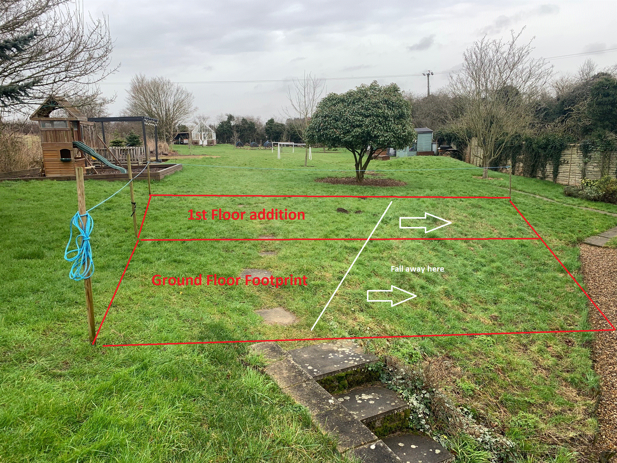

  23. Hi all, Recent joiner here looking for some advice on our foundations/retaining wall/semi-basement on our sloping site. Here’s a pic of our site, I’ve marked on it approx where the new dwelling will be sited: We have PP for a three story dwelling, the ground floor is less than half the area of the first floor, you can see a few design 3D’s on my intro post here of how the dwelling is situated on site and what we are proposing, here is a sectional diagram showing the split level: The architect has added notional B&B flooring on both floors for BRs, I think we need to look at slab for ground floor as we will have UFH throughout (we're off grid so ASHP in the plans), first floor could be a little more complex as approx. half of it is over ground that slopes away. I’m struggling to see how this will all hang together and want to be clear on possible options we have and requirements when I instruct our SE. We only envisaged excavating for the ground floor, building up retaining walls and ground floor in blockwork with timber frame from 1st floor up. If we excavated the whole house footprint there would be considerable additional muckaway, retaining walls, etc for what would effectively be a ground floor void with no light and reduced head height. Any input you guys have would be hugely appreciated, if there's any other info, floorplans, etc that would help please shout and I can add them up. Thanks
