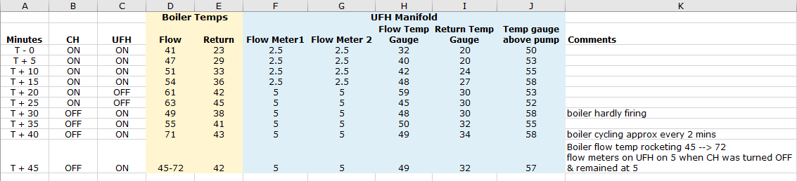

@SimonD - so I ran the system by first increasing the boiler temp to 70 as requested and taking readings generally at 10 minute intervals unless shown below otherwise. Observations from this were 1) the pipe between the manual gate valve and automatic bypass valve was very hot (pipe shown on the attached photo and circled in yellow) 2) I could hear the sound of water circulating through the pipework in the airing cupboard 3) after about 50 minutes of the system running, the boiler started cycling every 3-4 mins and flow temp rocketing from 45 to 60-71. It may have been doing this earlier but I was not standing by the boiler all the time. The main pump continued to run. After 80 minutes of the system running, I then increased the pump speed to 3. Immediately I saw the boiler stopped cycling and the flow temp remained at 70 with the boiler still firing. Some radiators far hotter than others which I assume is due to the TRVs. Radiators furthest away getting much hotter when speed turned to (3). Overall, it appeared the boiler was running better with the main pump speed at 3 with only the CH on When I turned off the system, I did notice the return temp rising from 62 to 69. dropping down to 62 and then rising up to 67. Not sure if this has something to do with the pump overrun when the system shutsdown. Not sure what the next step is now π. -

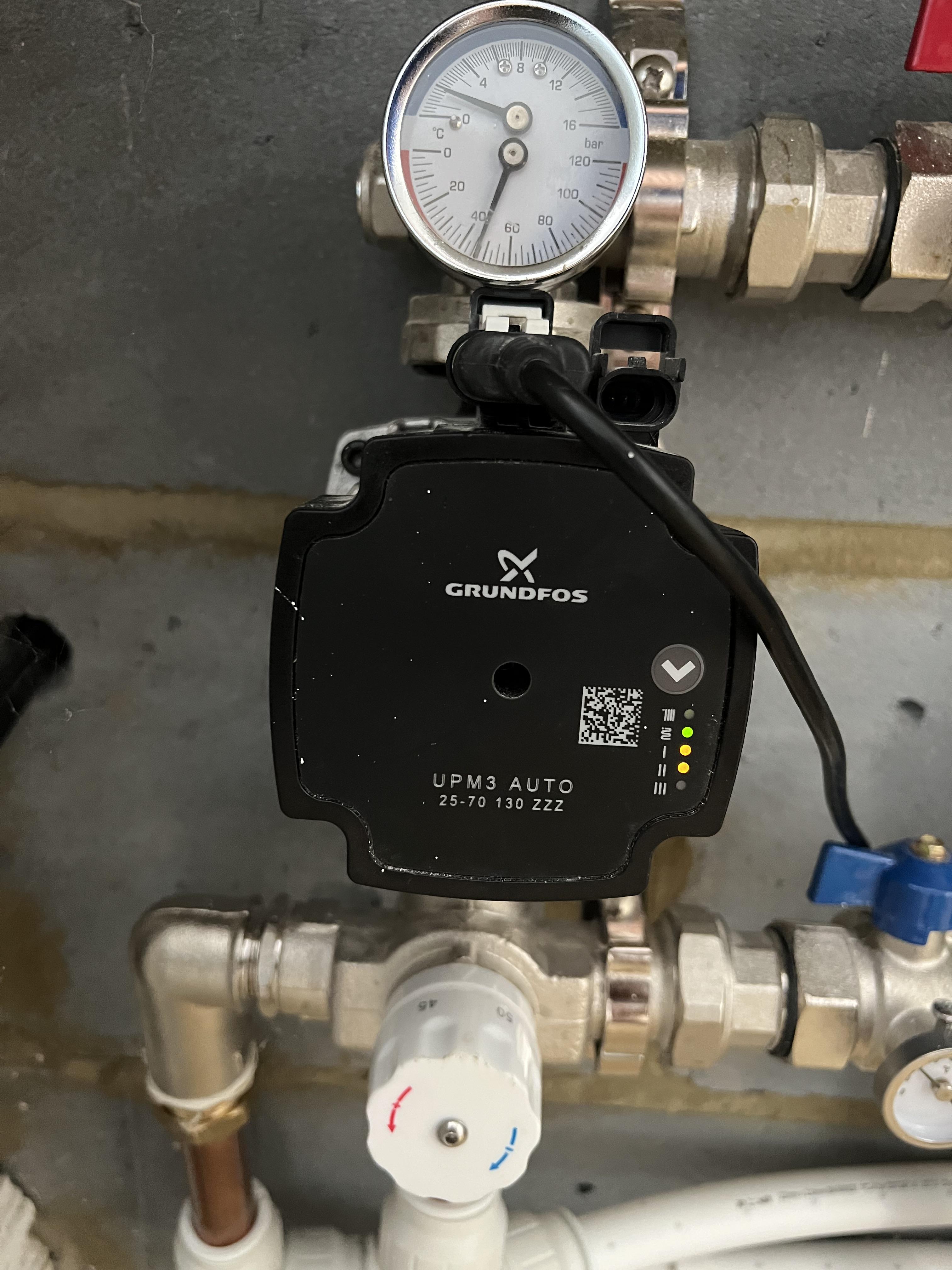

@SimonD - thanks for this. Yes, you are correct in that I do not get this behaviour/issue when the rad zone is open. I do possibly think the heat exchanger on the boiler is partially blocked as the boiler was making a kettling sound earlier in the week. Regarding the pipework on the UFH, I have attached some photos of the pipework in the airing cupboard in the landing where the main pump, 3 zone valves (HW, CH, UFH) and the UFH pipes (2 white plastic pipes) come up from the UFH manifold which is located in the room downstairs. The flow & return pipes come up from the boiler in the garage up to the airing cupboard (photo 'pipework around pump' and labelled '1' and '2'). To your question "where is the UFH connected to the primary pipework" - photos 'Airing Cupboard 8 & 9' shows the UFH zone valve connected to pipework from the CH pipework and then connected to one of the UFH white pipes. The other white pipe is connected to one of the existing pipes which is connected to the pipe going to the boiler. A few of the heating engineers who have visited have said the pipework is correctly installed. The flow & return 28mm pipework runs from the boiler to the airing cupboard is 6-7m in length. The distance of the UFH pipes from the airing cupboard to the UFH manifold is around 8.5m Let me know if it would help for more photos. I did some further readings today and results are below. General observation is that when the UFH is only on, boiler continually cycling. When CH turned on, majority radiators luke warm with rads furthest away cold. Only when the boiler flow temp went up 60+, did the radiators start heating up. Not sure if this is due to the main pump speed being turned down to speed (1). When the main pump speed was (3), all the rads definitely get heated pretty quickly (with the furthest rads taking longer). When both, the CH and UFH were on, and the boiler flow temp got into the 60s, I noticed the higher temps on the UFH manifold readings. Are the readings still strange? Anything I can do to determine if there is a flow restriction in the UFH? -

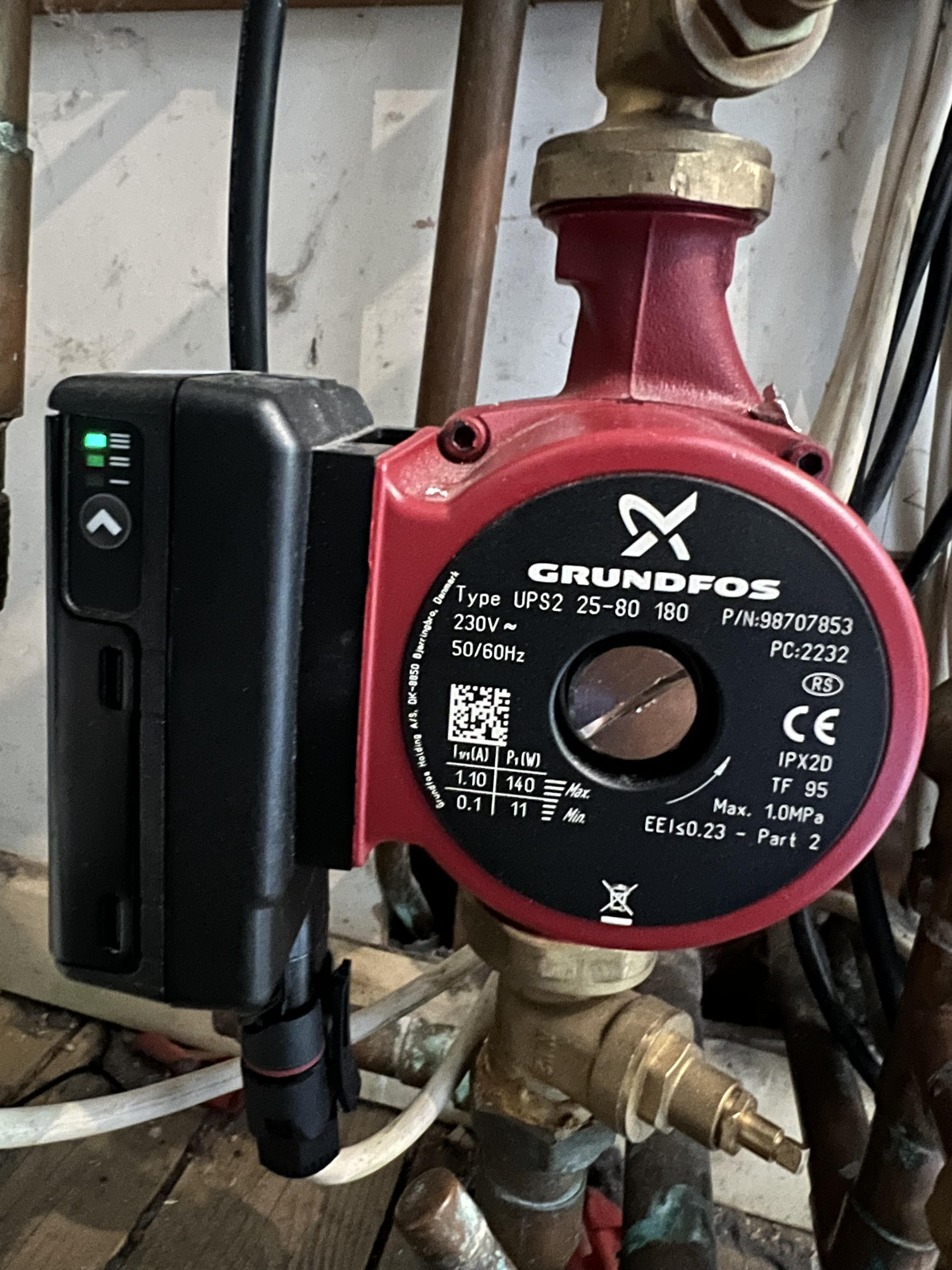

@SimonD - just to run some further tests, I reduced the speed of the main pump to speed (1) from speed (3) (photo attached) and took the following readings with just the UFH on. -

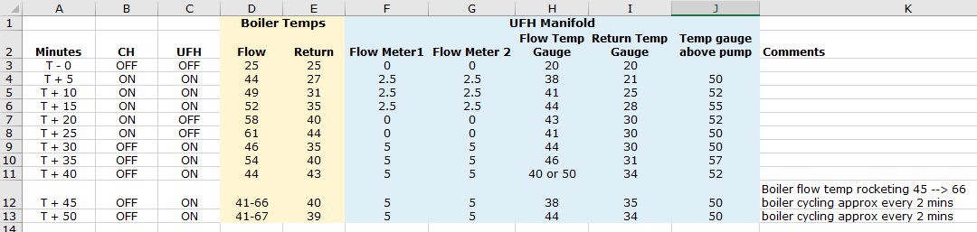

@SimonD - I decided to run a fresh test today and the readings are shown below. The boiler temp is set at 65 degrees. When the UFH is off, the flow meters are 0 so I must have taken a wrong reading yesterday. Also, on T+40, the flow temp on UFH was either 40 or 50. I wrote down 50 at the time but I think that was wrong and it should have possibly been 40. Are the readings still strange? No kettling sound from the boiler when I was running these test readings. I have also attached photos of the main pump and UFH pump when both, the CH and UFH are on -

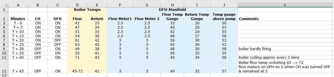

@SimonD - so here are the readings below (I also attached a file showing these readings incase the image below did not come through) . As well as taking the flow & return readings from the boiler, I also took readings from the UFH manifold. The blending valve on the UFH is set around 47 degrees. I took the readings across 5 minute intervals. What I found is that when I had both, CH and UFH turned on, the boiler was happily firing (without any sound of kettling which there was earlier in the week). The flow meters on the UFH was showing 2.5 (range 0-5). When I turned off the UFH, the flow meters on the UFH went to 5 and these flow meters stayed on 5 when I turned on the UFH and turned off the CH. After about 10 minutes of the UFH only being on, I could see the boiler short cyling (every 2 mins) and the boiler flow temperature would rocket from 45 to 72 degrees. I hope this helps but happy to do some further tests to get to the root cause of the problem. -
