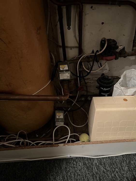

@marshian, thanks. The honeywell kit replaced a previous controller if I recall. One thing I'm not sure on is what to do with the wiring going to the Honeywell relay/receiver HC60NG/R6660D as I'm assuming this receiver will become redundant once the Tado has been installed? -

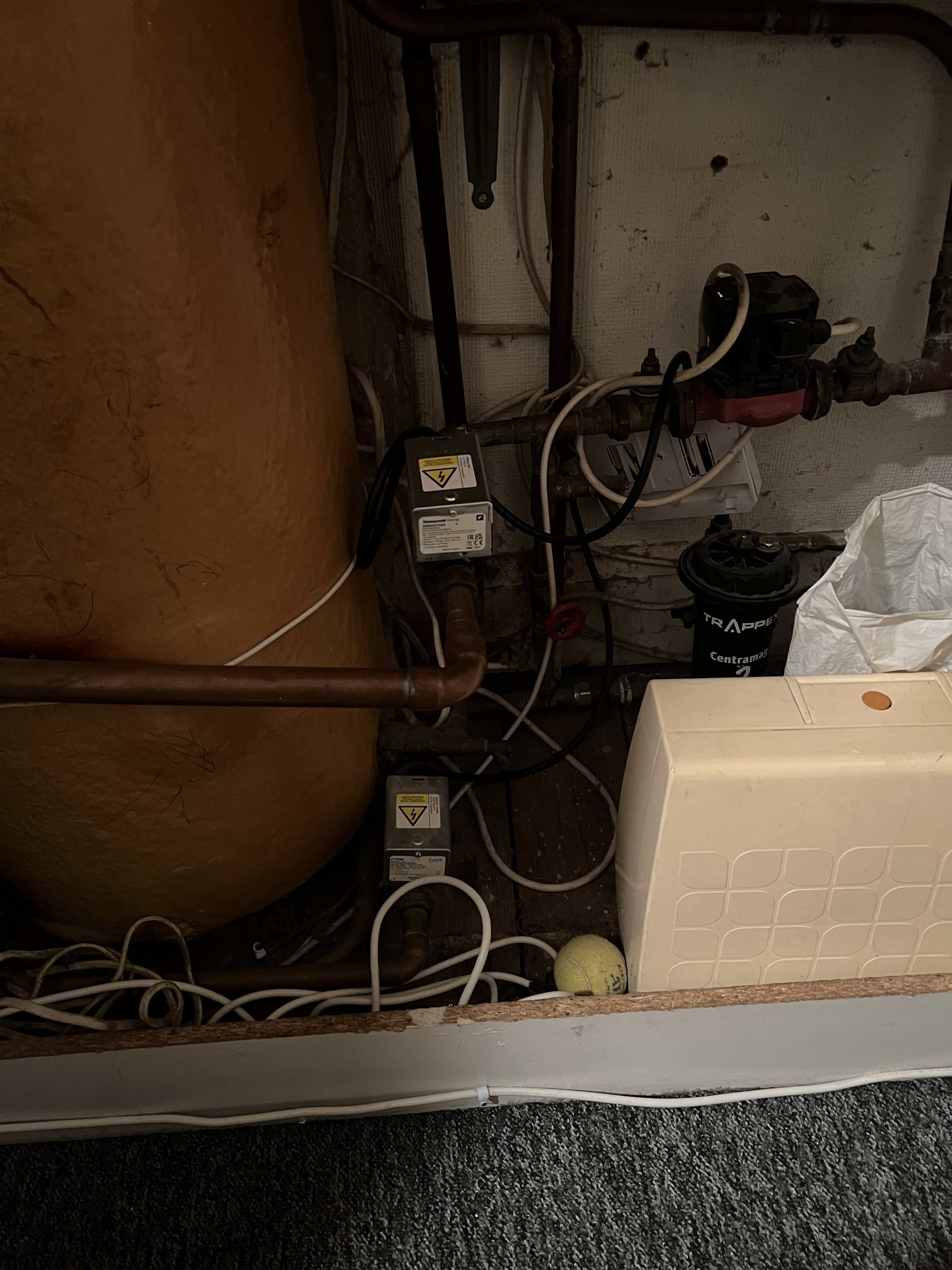

In my 3-bedroom semi-detached house, I currently have a conventional central heating system comprising of: a MAIN HE Condensing boiler (located in lounge) a Honeywell programmer ST9400C (located in lounge beside boiler) a Honeywell HCW80 (Y6630D1007) Battery Powered Wireless Room Thermostat (located in hallway) a Honeywell relay/receiver HC60NG/R6660D (located in a bedroom cupboard beside the hot water tank, zone valves, and pump) a wiring box (located in the same bedroom cupboard where the hot water tank is) I believe I have a S-Plan setup with 2 x 2-port motorised valves controlled by the room thermostat and hot water cylinder thermostat (photo attached) I am looking to replace this with the Tado Wireless Smart Thermostat Starter Kit V3+ with Hot Water Control, or an alternative smart system so that I can control the central heating and hot water remotely. Assuming the Tado Wireless Thermostat Starter Kit V3+ is compatible, is it fairly straight forward to remove the Honeywell set-up and replace it with the Tado system? I would like to do it myself but there are a fair amount of wires.

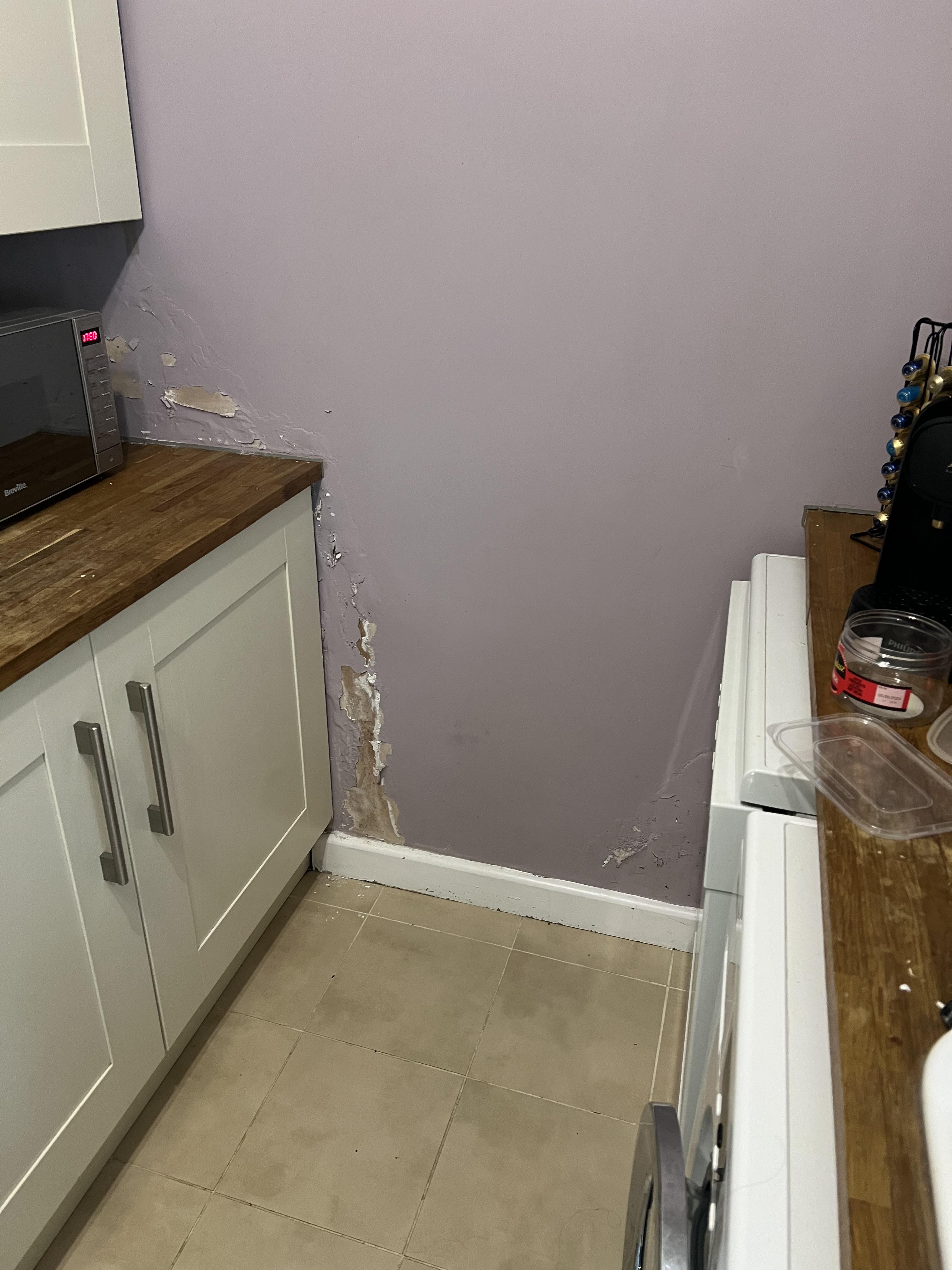

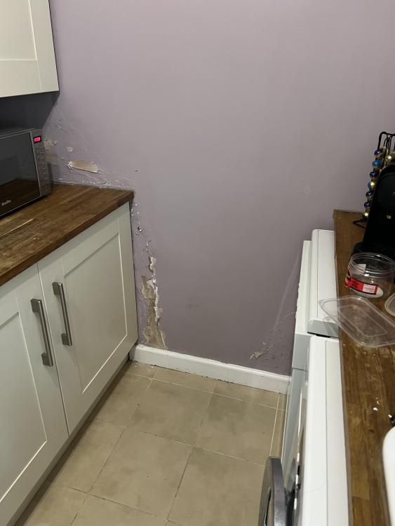

Unfortunately there is not enough gap between the wall and the kitchen units to allow for insulated plasterboard
The ground floor consists of a through lounge and then the kitchen. Since the house is near a roundabout, there are no trickle vents on the windows at the front of lounge and at the back of the lounge. There is no door between the rear lounge and the kitchen. The kitchen contains a window which does have a trickle vent. The damp/flaking paint is on the external wall of the kitchen. The kitchen units touch this external wall. Not sure if thernally insulating the inside of the wall will help. I have attached a photo of this wall.
My son has a problem with his kitchen wall where paint on part of the wall (external) is flaking. I have had a damp surveyor visit his home and he said that due to the lack of airflow, there is high humidity within the kitchen which is likely to be contributing to the problem. The surveyor recommends a humidistat extractor fan is installed in the kitchen. Can anyone recommend a particular extractor fan that is effective & silent, and will reduce the humidity within the kitchen? We did not particularly want to fit airbricks at the top & bottom of the kitchen wall (to help with airflow) because of traffic noise coming inside the house

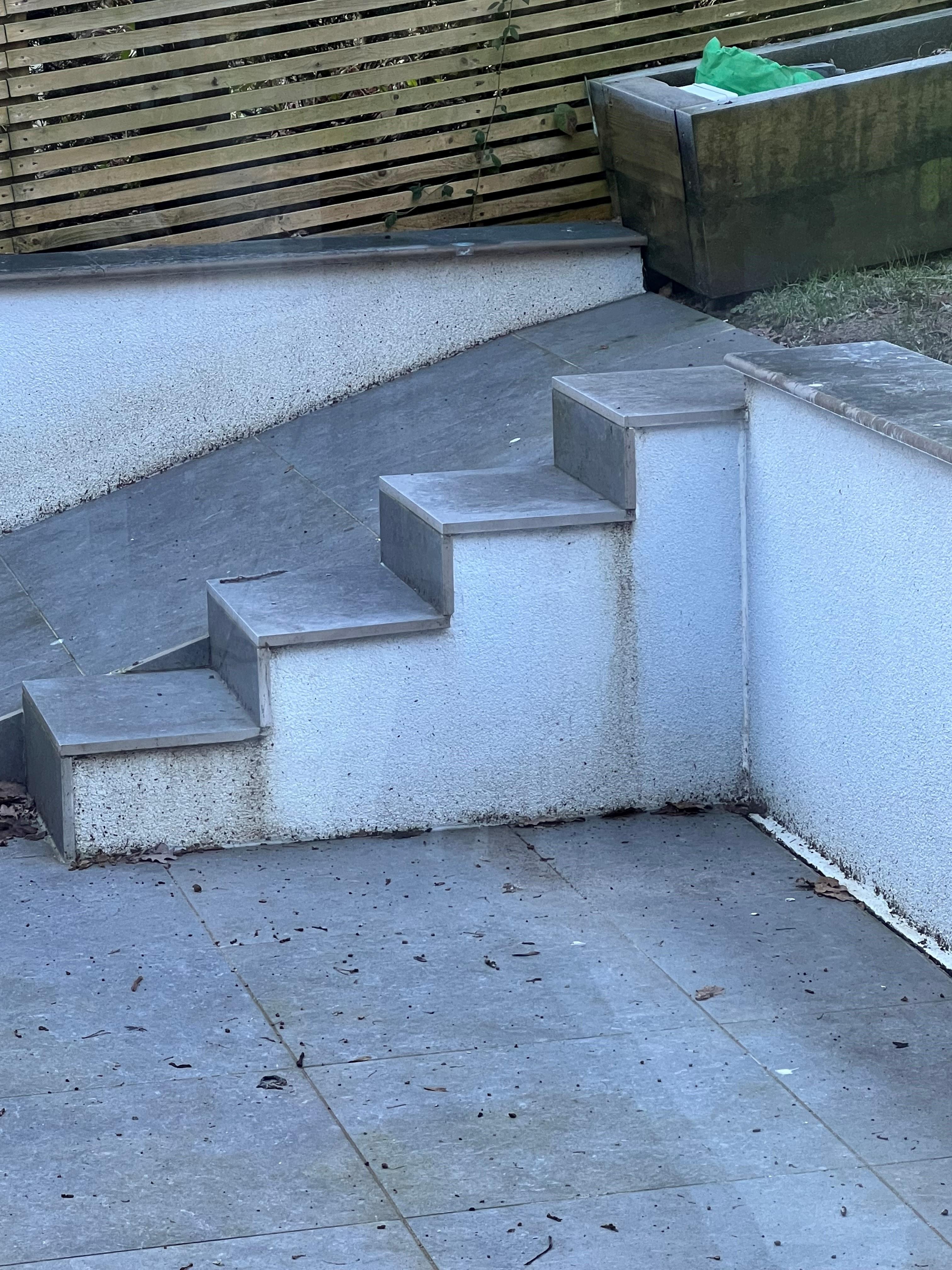

Thanks @Iceverge, I’ll give the silicone sealant a try once the weather gets drier and I’ve cleaning the wall and porcelain patio. The masonry protection cream is incredibly expensive! Would something like this (Thompson’s One Coat Water Seal) not do the trick? https://amzn.eu/d/gjoq1MX
thanks @Iceverge. I'll give what you suggest a try. I like the idea about applying a thin dab of clear silicone along the edges of the tiled steps but I'm not sure how I could achieve a neat finish with the clear silicone. Where you say "get a brush on silicone based sealant" - would that be to apply on the wall once it has been cleaned? Would you be able to recommend of a suitable sealant?

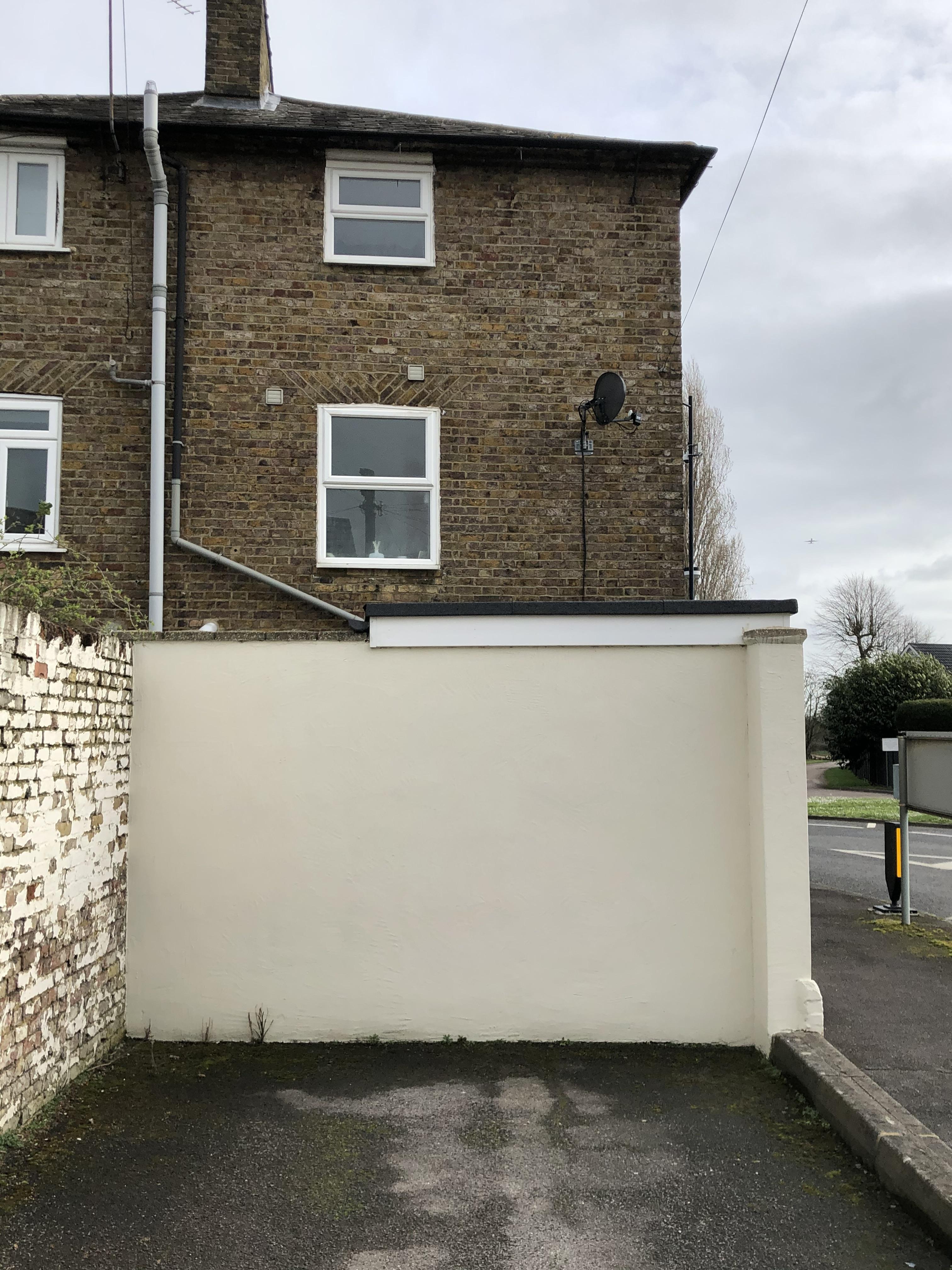

Hoping someone can advise..... I had a garden wall built around 18 months ago and the front of the wall (from the top to the ground) was k-rendered. With the wall touching the ground, I find that when it rains, dirt from the ground splashes up on the wall. I have attached a photo of my wall showing the dirt. Can anyone advise how best I can clean this, and is there anything I can put on the wall to minimise the amount of dirt sticking to the wall?

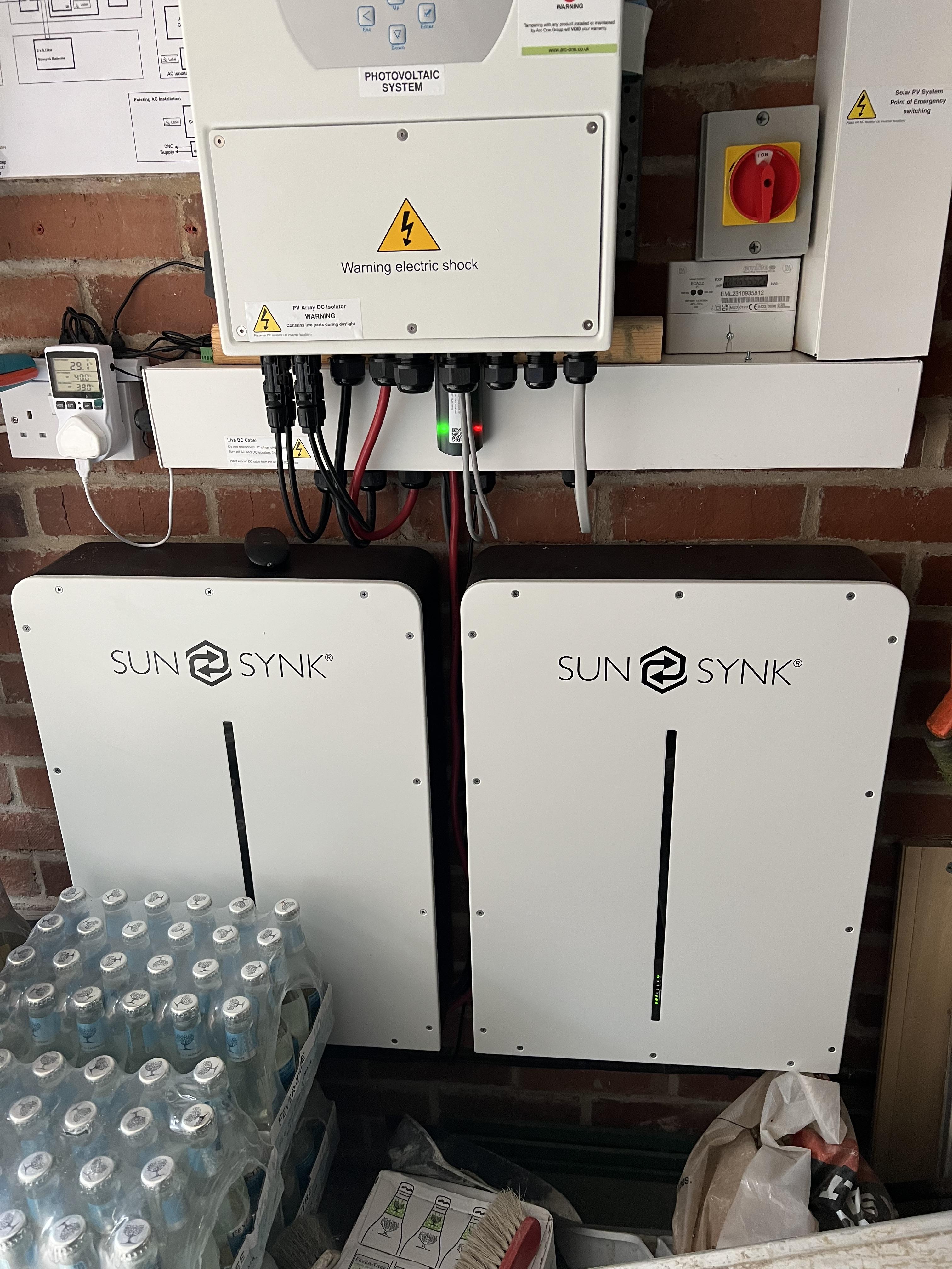

Thanks @SteamyTea. Does this mean that if the temp falls below 0C, the batteries will not charge, or charge very slowly?
Even though the garage is attached, the batteries are installed on the opposite side of a single brick wall. I would think that it the winter, there’s probably a good chance of the temp in the garage hitting single figures
Someone who has the same type of batteries that I have mentioned that keeping the batteries warm allows then to charge and discharge at full 2500w power. Below 12c, SunSynk batteries halve it to 1250w and approaching zero they turn off altogether. If this is not the case, then I’m happy not to add any insulation to them.
I had solar system installed at my house in April. I have a 5kW SunSynk inverter and 2 x 5.12kW SunSync batteries installed in my garage. With winter not too far away, I was looking at ways on how best to insulate the batteries during the cold winter days. The batteries are attached on the garage wall. From what I understand, the cold weather affects the charging & discharging performance of the batteries. Can anyone advise here? I’ve attached a photo of my batteries in my garage.
