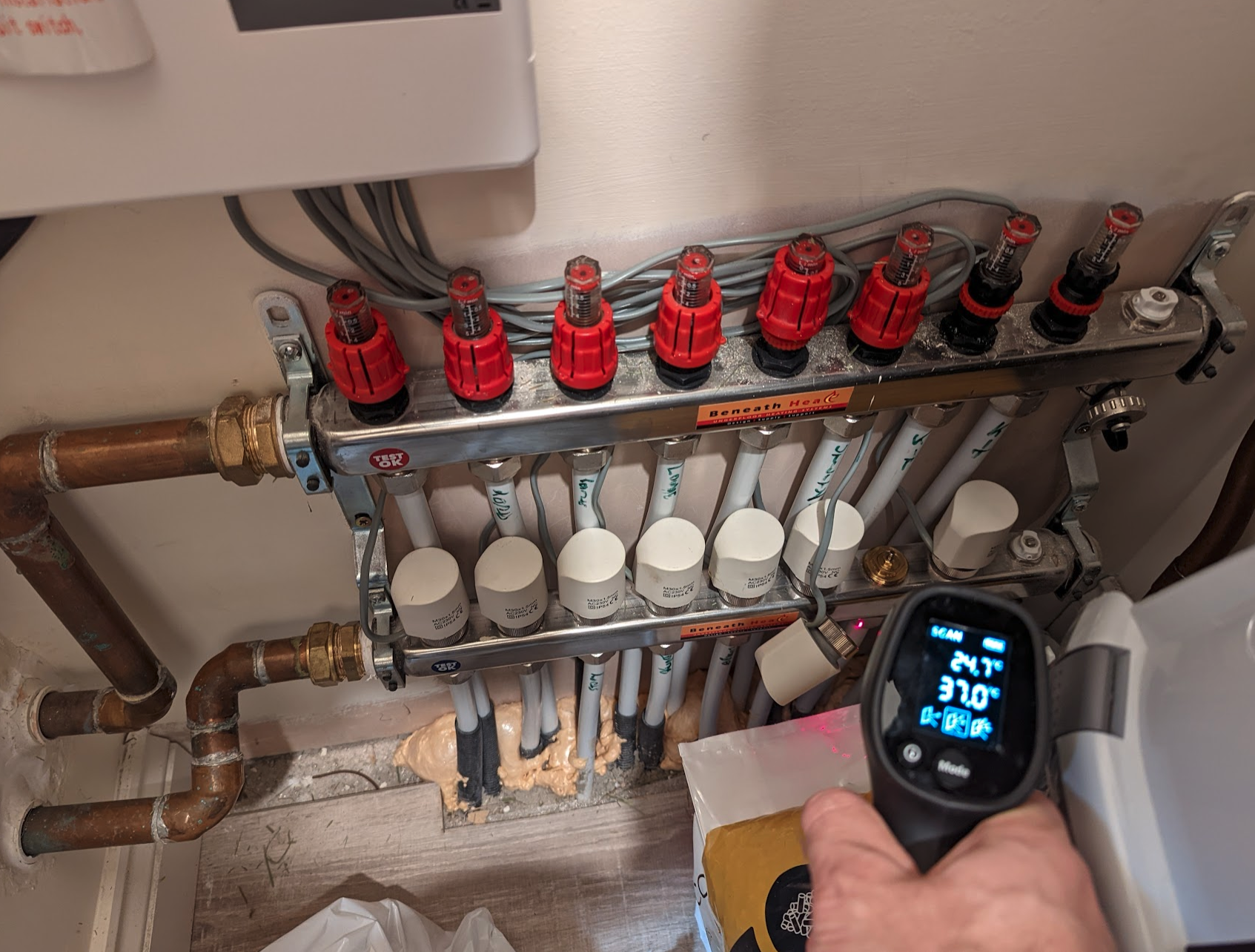

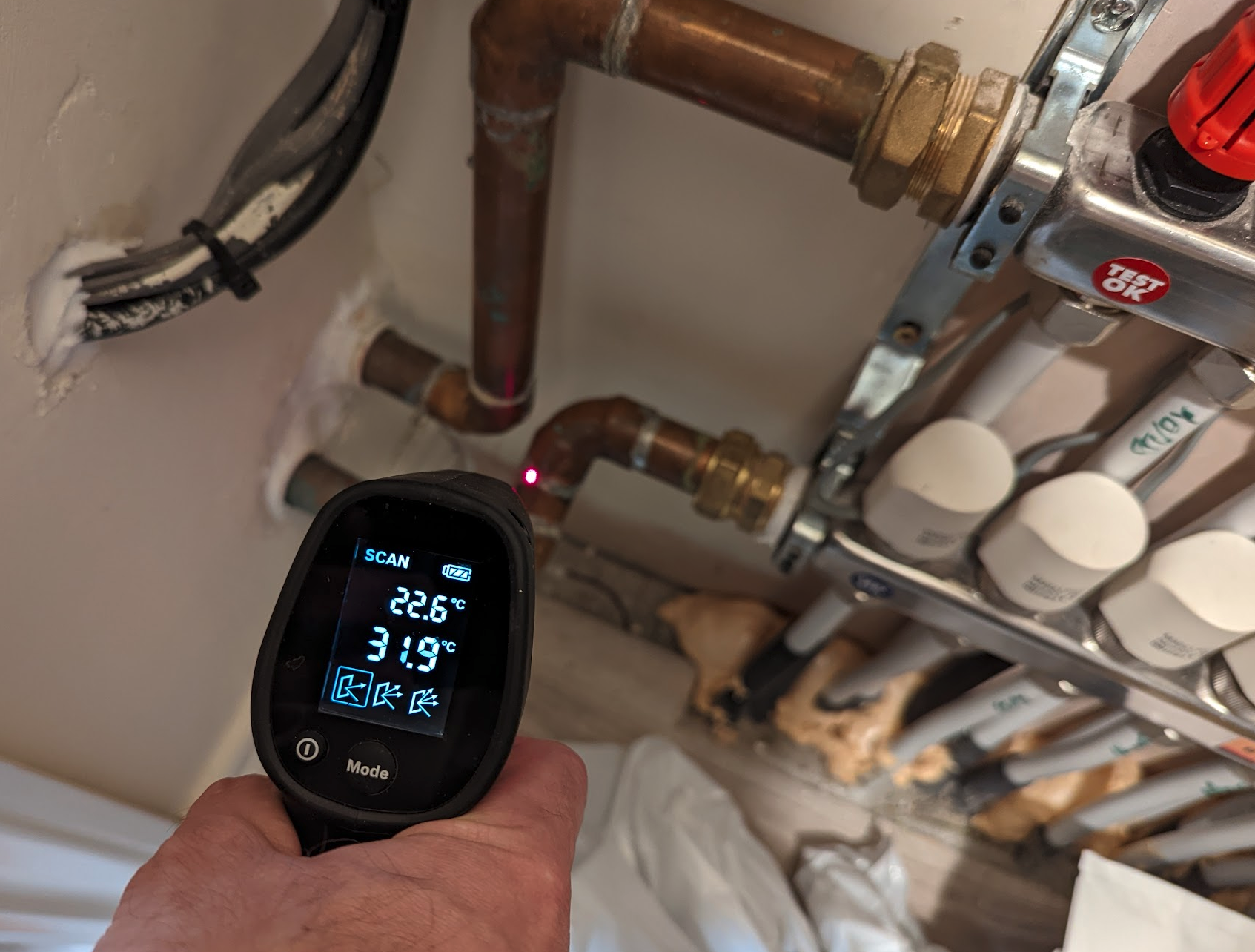

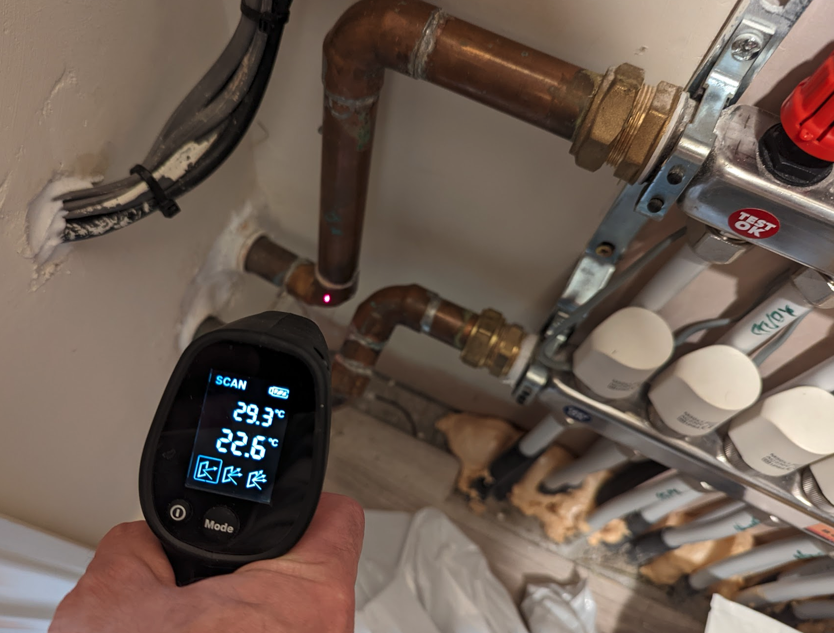

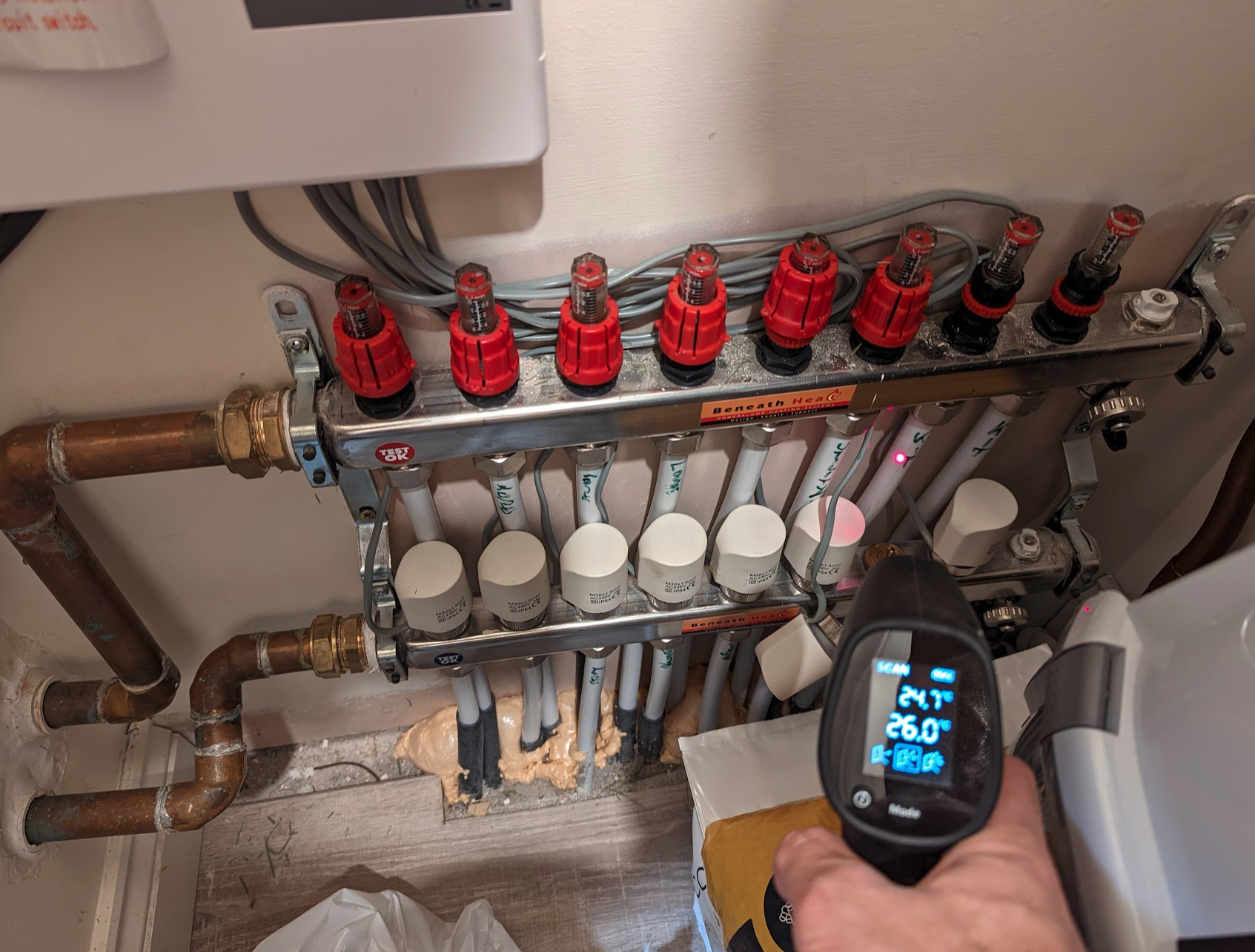

  2. HI Dave, thanks - I've just done this test as well. To the touch, the bottom pipe is certainly getting warmer first. I was also able to confirm this with the infrared thermometer as seen in the images below show (larger number in the middle is the live figure being recorded). It would seem to confirm that this is the wrong way around ? So the follow on question then remains in that does this cause any issues? Do the flow indicators and lower pins have any issues with incorrect flow direction?
  3. Hi All, We're been living in a new build property for the past 2 years without any obvious heating issues. We've an underfloor heating system that's split across 4 rooms, and is driven by a Daikin ASHP. I've occasionally had to take the actuators off in order to release stuck pins after periods of minimal heating activity, but always noticed that the flow valves show 0 flow when the system is on or off. When pressing the zone pin down, the associated flow meter bounces and a knocking sound is heard through the pipe. After watching a few videos online, I wondered if the system had been connected up around the wrong way, but couldn't find confirmation anywhere. When the system is running, if I manually depress one of the pins for about 30 seconds and take temperature readings off the pipes, I see 37 degrees beneath the actuator at the bottom of the manifold .At the top, I see 26 degrees under the flow indicator for the same loop (see attached photos). Am I correct in thinking the flow into the manifold is around the wrong way? If so, apart from not giving an accurate flow indication, does this cause any problems? The house is certainly warm enough through colder periods (22-23 degrees) but I wondered if the system would be as efficient as possible in this configuration? Any advice gratefully appreciated. Thanks, Ben
