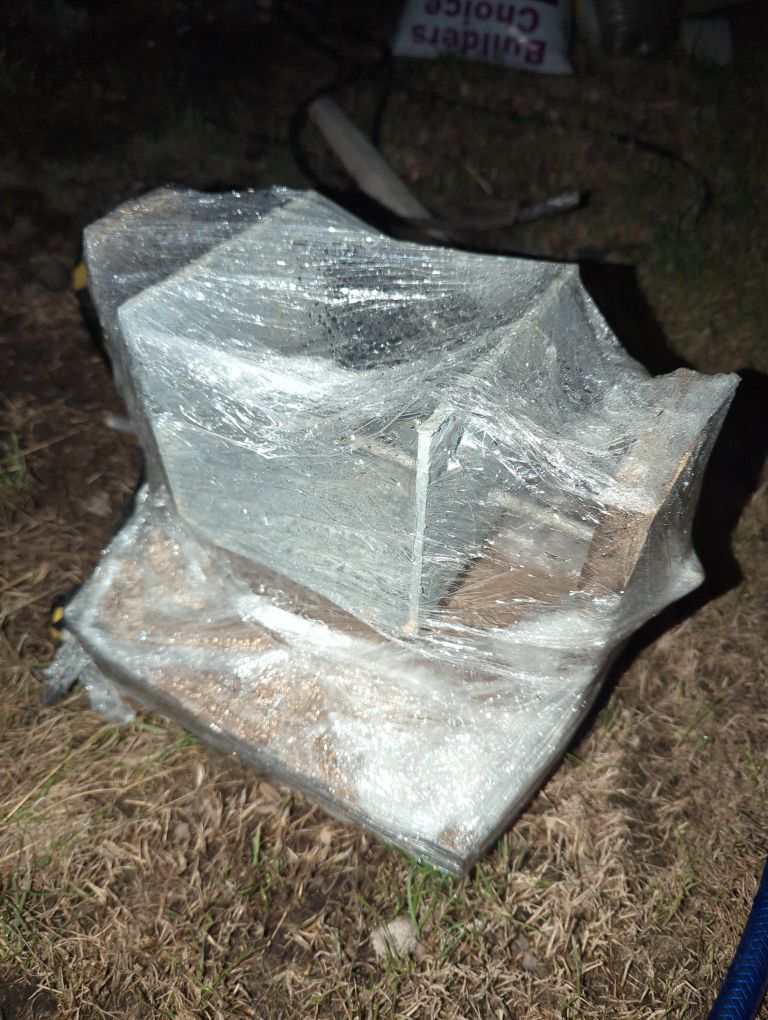

Hi All, Patio is mostly done (needs decking), mini porch is done but I proceed with the pergola and do the decking at one go on both. Same system like with my patio, steel bases in concrete. Just curing nicely. 3 days in and concrete is still warm.

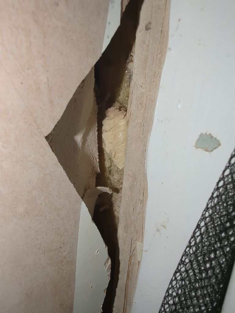

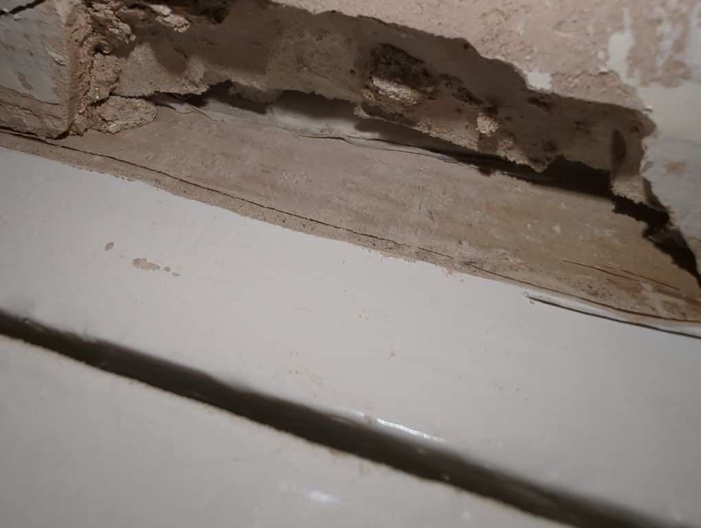

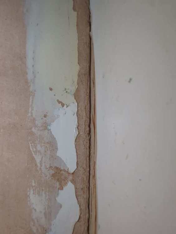

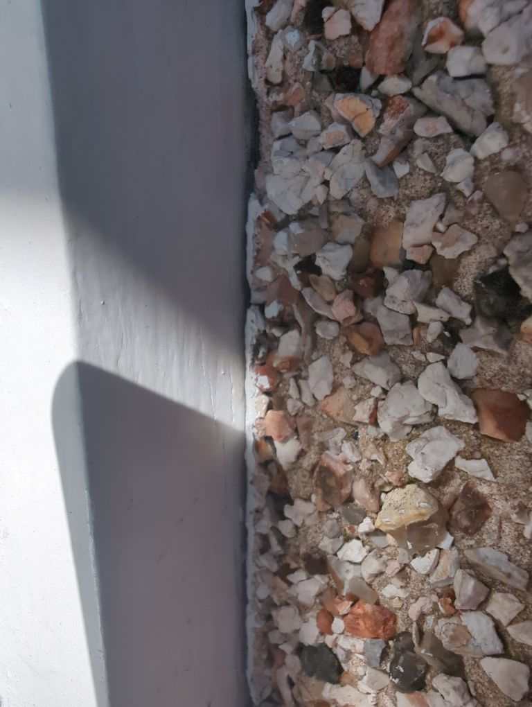

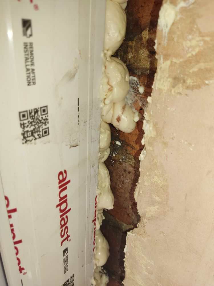

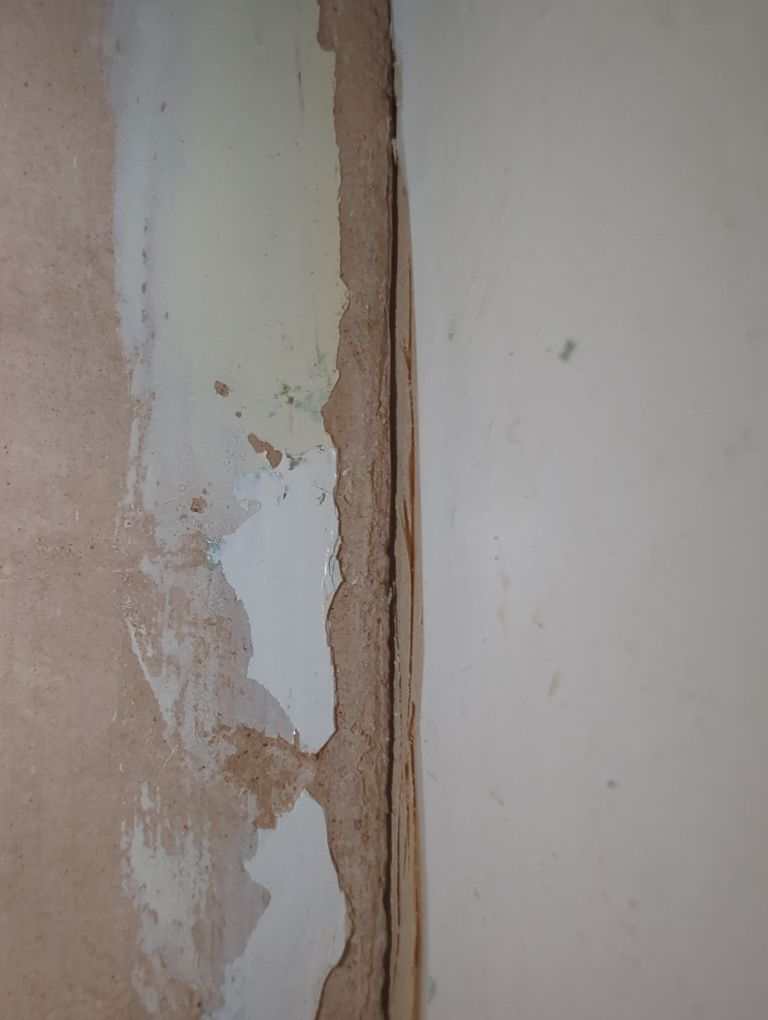

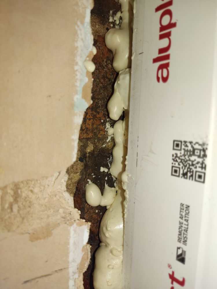

Removed most of the plaster on the inside and taken some measurements: Frame H 203cm W 88cm Thickness 9cm Door H 192.5cm W 79.5cm Thickness 4.5cm Threshold H 9.5cm W 92.5cm Thickness 4.5cm I think the missing is the measurements of the opening itself. On the top I can see the frame is like 2cm deep into the plaster/plasterboard (second picture). On the sides it is about 0.5cm on each side. I think I need to hack off more plaster if I want to fit a similar size frame in there.
The other day I have removed the silicone in the corners and looked at the door frame (took some pictures) and it looks like the exterior insulation but also the interior plaster came after the doors so it looks like the frame goes deeper than I thought. I think I have to hack away the plaster to get a better idea and take realistic measurements. From what I know you need to give like 5mm gap on either side of the frame.

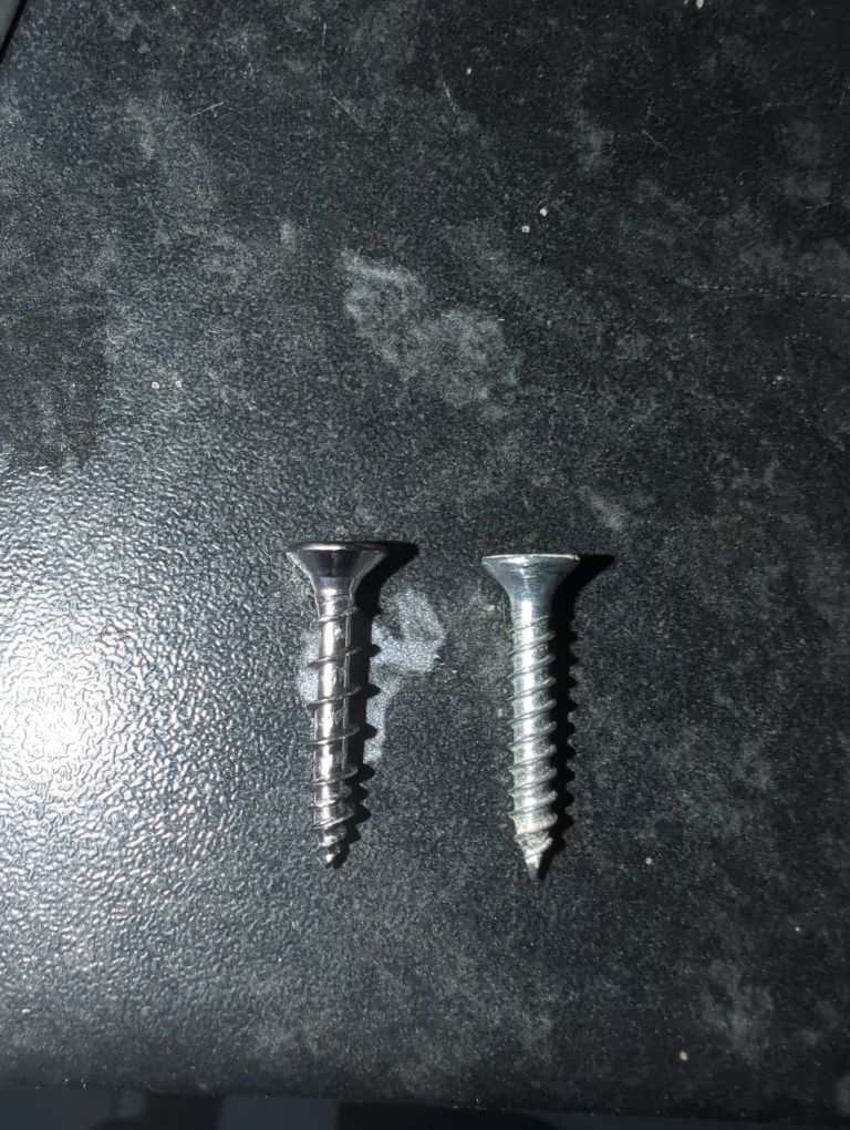

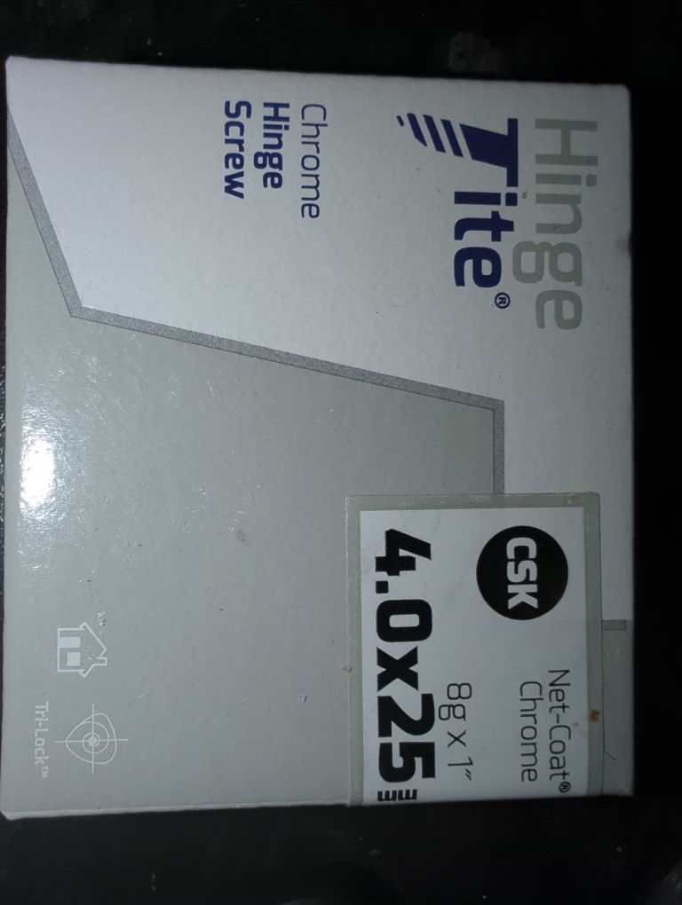

I bought these hinge screws but the thread is different to the original hinge screw on the right side. I think these HingeTite are to cupboard doors.
indeed "machine thread" is the term I was missing
Hi All, This is a silly question but what screws are for regular interior door hinges? I think it is M4 x 30mm but I think the thread on those is a bit different? Please advise. Thanks
