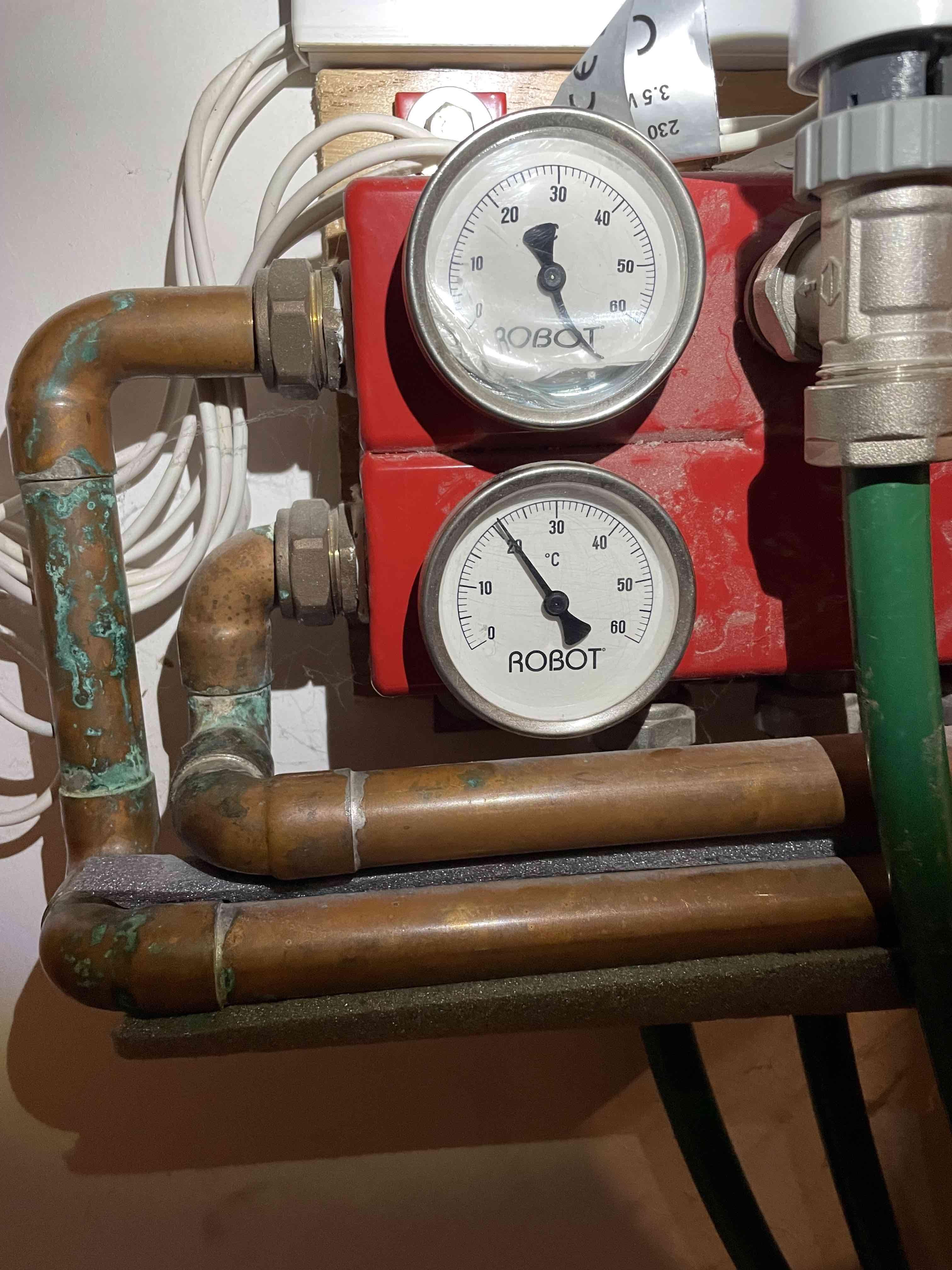

  1. The gauge actually continued to rise and went above 60oC so I pulled it out so as not to melt it as well lol. Turned it off for now as I'm not sure the guy who set this up did it correctly!
  2. For the problematic manifold, I swapped the gauges around so that I can actually read temp going into the manifold. Upon start of heating, temperature on dial went up to ~58oC, which is actually what our boiler thermostat is set too as well. It then dropped down to about 40/45 and stayed there for a while before slowly rising again, up to 55oC after about 30mins of running. The grundfos pump pictured earlier is connected to the lower pipe of the manifold and the arrow on the pump is away from the manifold (presumably back to boiler). I cannot see any evidence of a mixing or blending valve regulating temperature of the water by mixing it with cold. I am also not really familiar with this type of manifold as all my searches on google reveal manifolds that look nothing like this one. I can't see any identifying marks or serials on it so who knows.
  3. OK actually, this may have been wrong. Sorry I'm still getting used to this - bear with me and I'll double check the temperatures in/out tomorrow when the system comes on. I just need to double check which pipes come from the boiler. Thanks for ongoing advice.
  4. @Nickfromwales OK yea that makes sense. I did think a motorised one would (should) be quicker then these ones! ? So the top Robot dial measures temperature into the system but unfortunately that dial is all deformed somehow, you can see it in the image but not sure why. Checked the equivalent upstairs system and temperature going in seems to be about 50oC. I can't say that is exactly what the problematic manifold is reading but I'd guess (hope) it was pretty similar.

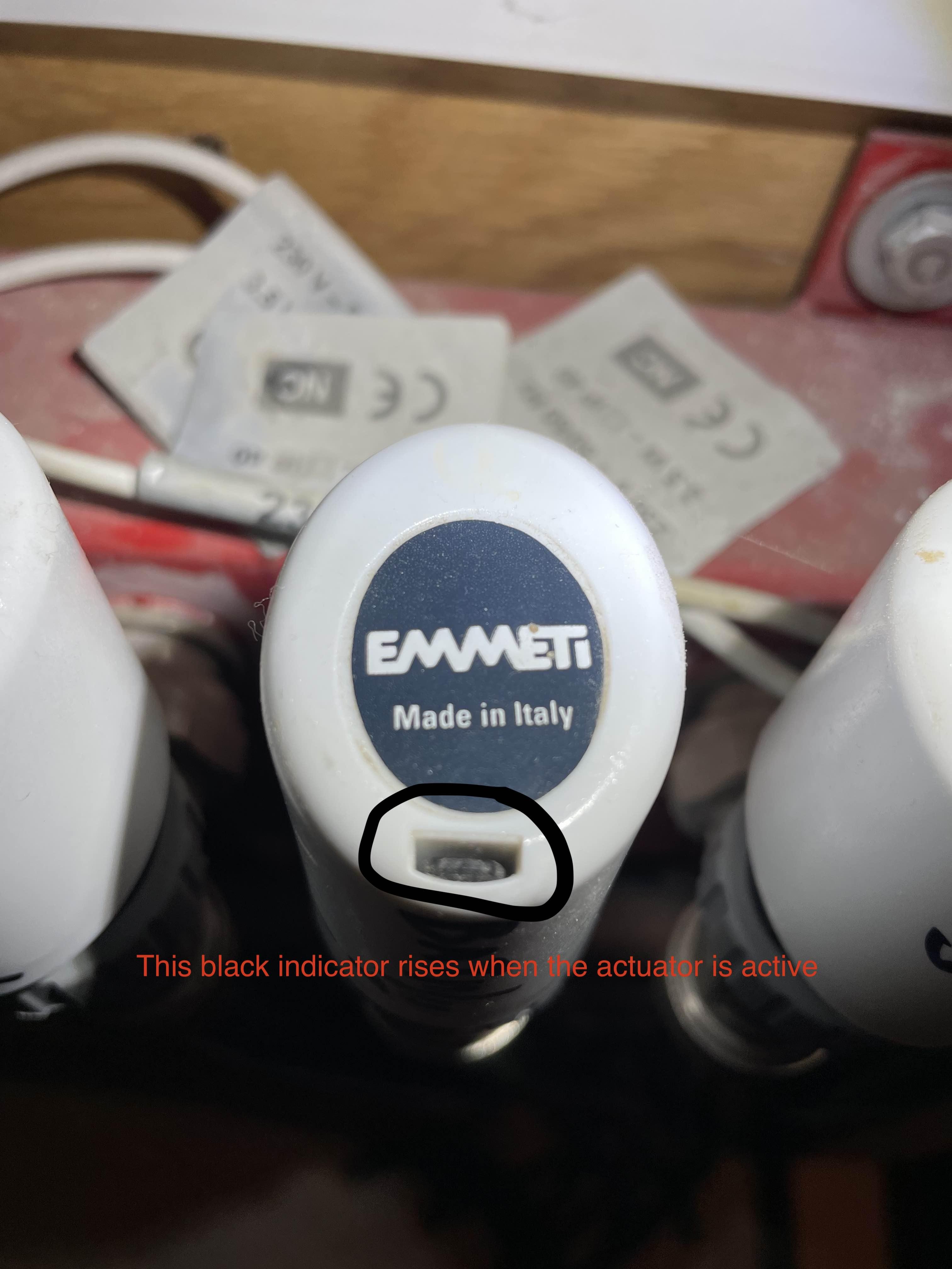

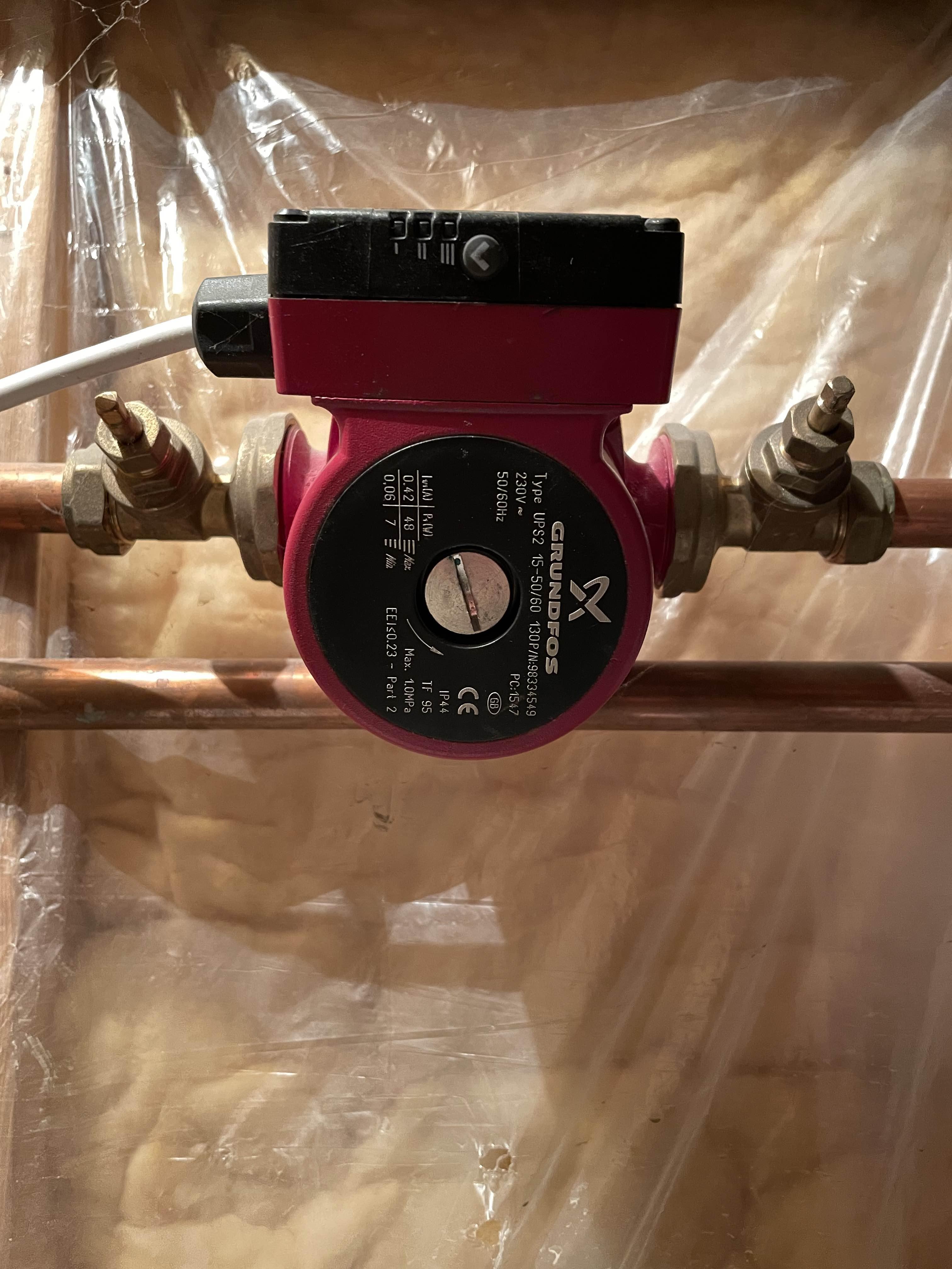

  5. Thanks all for your comments. @PeterW - I can't see a blending valve. Both manifolds look the same, so yea, not sure how the "blending" works in this case. Does seem unusual that there is no mixing or blending though (?). I'll try and take off an actuator and get a photo of what's in there. I've attached a photo of the GRUNDFOS pump which pumps water from the boiler (presumably there is something between the boiler and the pump moderating the temperature but I'll need to take a further look at this when I'm back later on). These look like older manifolds but not sure to be honest as I can't get hold of the guy who installed it. I can only guess maybe that the blending wasn't required in this case? @Nickfromwales I think these are motorised actuators as when they get fed with voltage, a little black tip (tell-tale) slowly rises up, takes a few minutes to get fully up. See new photo (actuator) where they are all closed. I don't know how the actuators are connected to the valve in this case though so I'll try and take an actuator off and take a look. They are very tight but I'll give it another go. Thanks

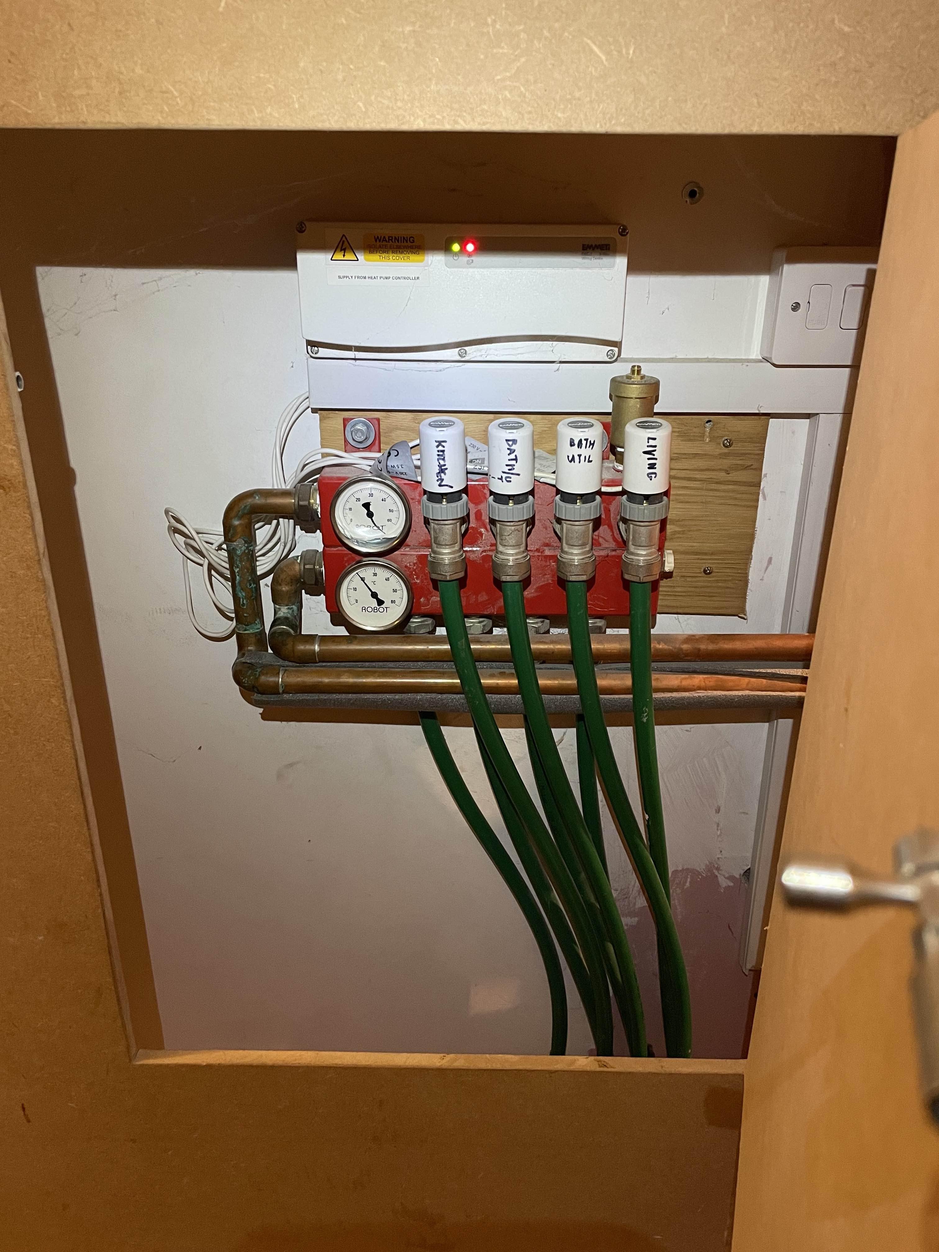

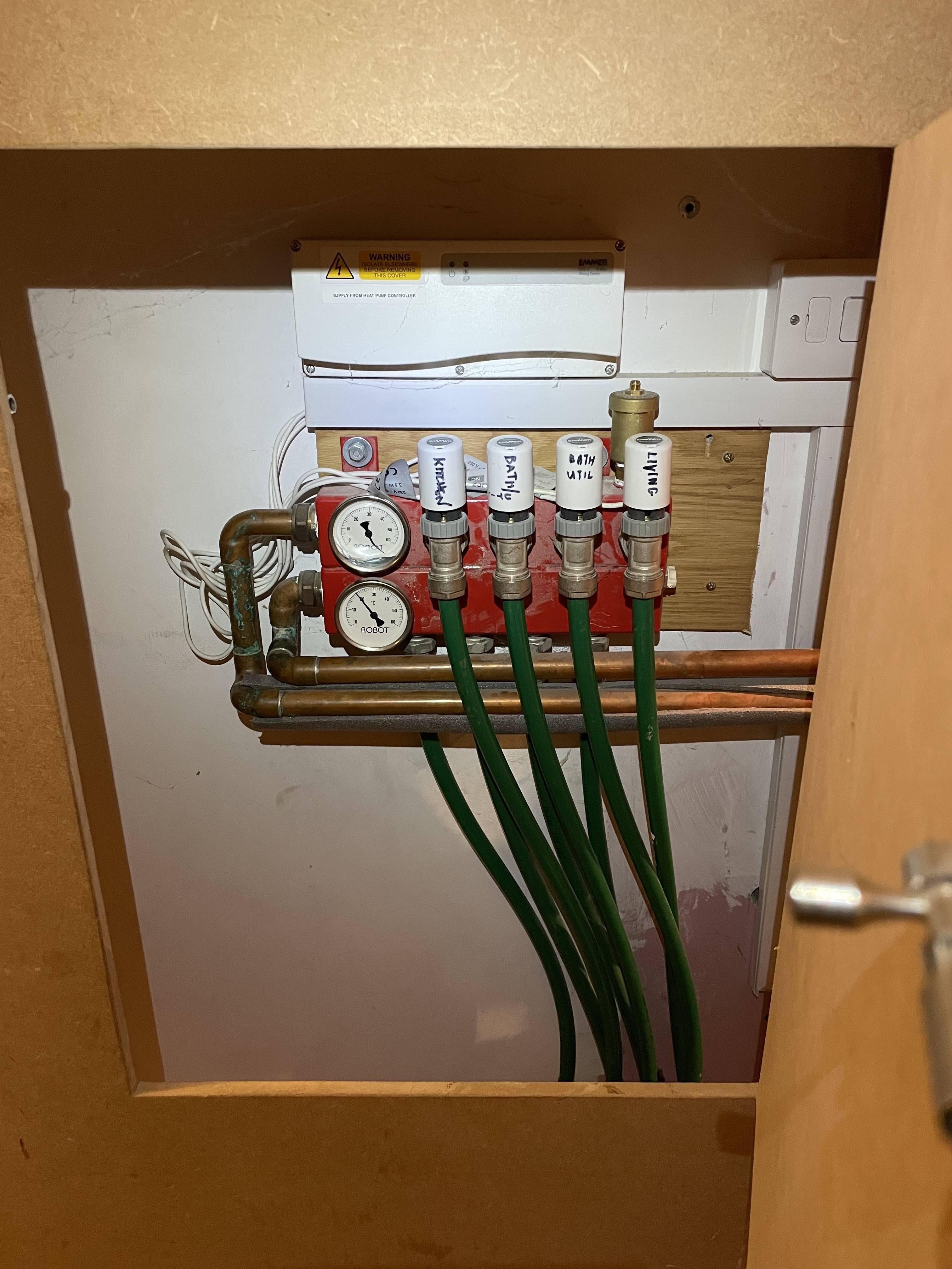

  6. OK, so we have recently moved into a house which has underfloor heating installed throughout and generally it works really well. The system is fed from the hot water boiler. There are two manifolds, one for upstairs and one for downstairs. Both manifolds have pump which drives the water into the manifold. Upstairs, we have no problems with. Downstairs has three zones, Kitchen, Living Room and Utility/Bathroom. The Manifold is shown in the Manifold_PreStart.jpg file which is how it looks when no heating is on. Heating comes on at 6pm and at that point, the pump starts, shown by the red light in the Manifold_PostStart.jpg image. A few minutes after starting, we get a thumping noise seemingly from the manifold but it is difficult to exactly pin down. I have a video of it which is on YouTube here: - noise starts about 55s into the video. The thumping lasts a few seconds, probably less than 10 and is kinda juddery in nature, its sort of a duh-duh-dumm, duh-dumm. The past few days I have been experimenting with different zones demanding heat via thermostats and when a single room (e.g. the kitchen) is the only one demanding heat from the system, then there is no juddering or thumping. Only when multiple rooms are demanding heat, does the noise occur. For example, today, we had the kitchen and the utility requesting heat and the thumping happened. I don't know much about the system as I didn't install it and there are no manuals etc, but it looks to be mostly Emmeti products. Another thing with this downstairs manifold is that the top "Robot" dial is warped a bit. This dial seemingly measures temperature of the water going into the system. See Warped.jpg. Any idea why this could look like this? Heating is currently on at pressure in the system seems to be about 1.7bar Any ideas what could be going on in this system? The floors get warm just fine by the way. Thanks
